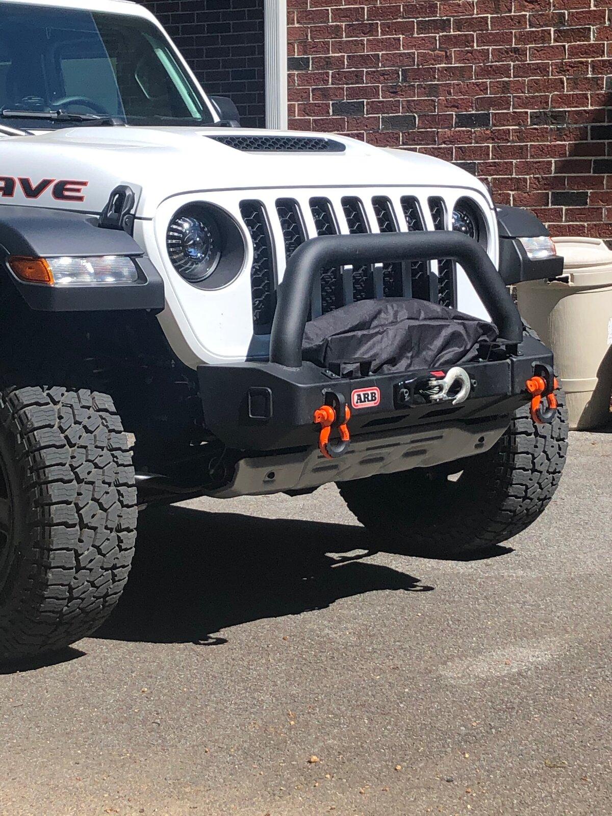

Is there a steel bumper (full) actually made for a Mohave that will bolt up with the Mohave skid plate...??
I just installed a Quadratec QRC Winch Bumper. Fits good and the 12k Badlands ( Harbor Freight winch) just squeeks in there. I'll be doing a bit of trimming of the factory skid plate to put the factory skid plate back on. It'll mount ot it's existing 4 mount holes/hidden nut plates. I'll post pics later of what needs trimming. The Quadratec Bumper has it's own semi-wrapped-under-the-bumper skid thingy. It has 3 welded gussets that you need to trim the Jeep Plate around. Very minor. It'll take my neighbor longer to walk over and tell me to knock off the noise than it will to trim. Stand by!

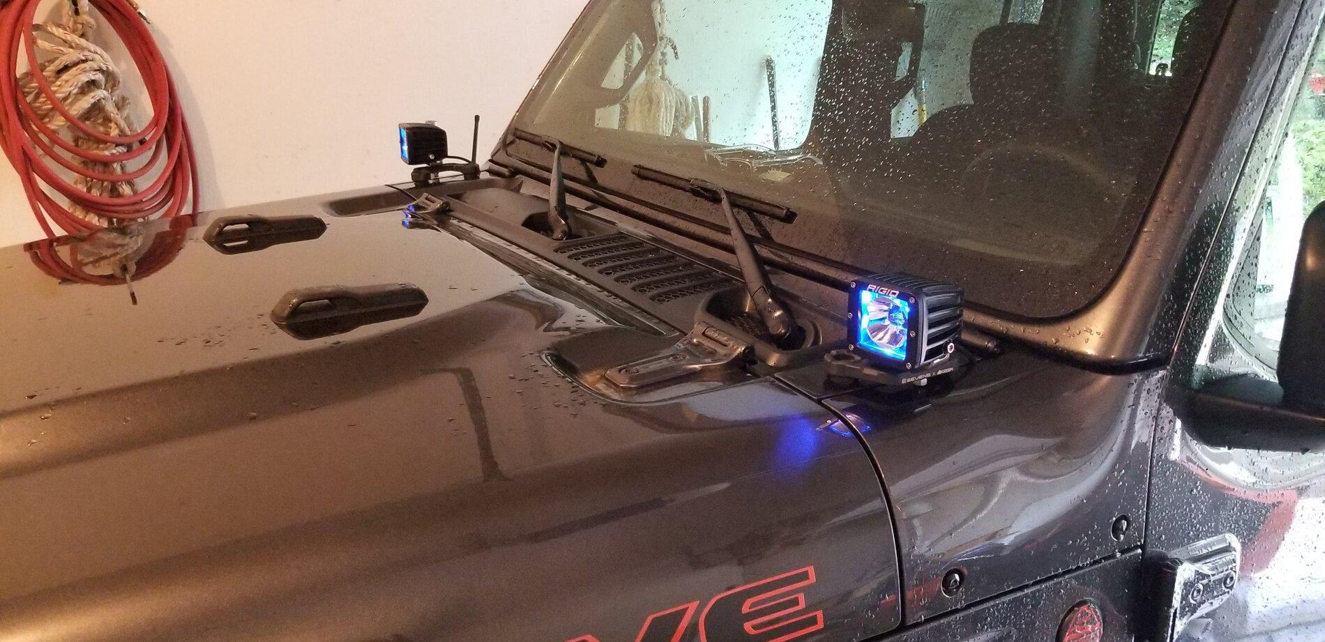

I'm not sure if this has been mentioned before but I cannot find any Mojave fog light brackets to mount on the cowl area only ones I've seen or windshield bracket mounted ... Any one else find pod lights that mount like the JL/JK style? Everything says will NOT fit Mojave
The GoRhino cowl mount brackets work. You will just need to purchase an 85mm M6 bolt for them to wok on a Mojave. I don't have a picture handy of. "just the brackets" but this is a picture of my. Mojave with Rigid Cubes and the GoRhino cowl mounts. There are other threads on this with a closeup. of the brackets......BTW don't even bother to ask GoRhino, they say the brackets haven't been tested for Mojave and don't know...but they DO WORK with the longer bolt..
Your rig looks great! Thanks for the info going to research now ?

Thank you... Here are the exact part number for the brackets and screws..The similar bracket for double lights should work fine also..
Go Rhino 730030T Bracket
binifiMux 10-Pack M6x80mm Black Socket Cap Screws. (Amazon)

Ok that's perfect! ... grabbing the bolts now ... your assistance is greatly appreciated my friend ??... all that's left is to pick out some lights .. Rigid Cubes it is!!

That's a Rigid Radiance, setup for a fog pattern, I have them set pretty wide angle for slow running on a trail, you dont notice any glare off the hood set like that.
There should be one. Last week we installed this ARB stubby and winch on my Mojave. While we had to remove the skid plate for the install, we were able to fit it right back with no problem.
