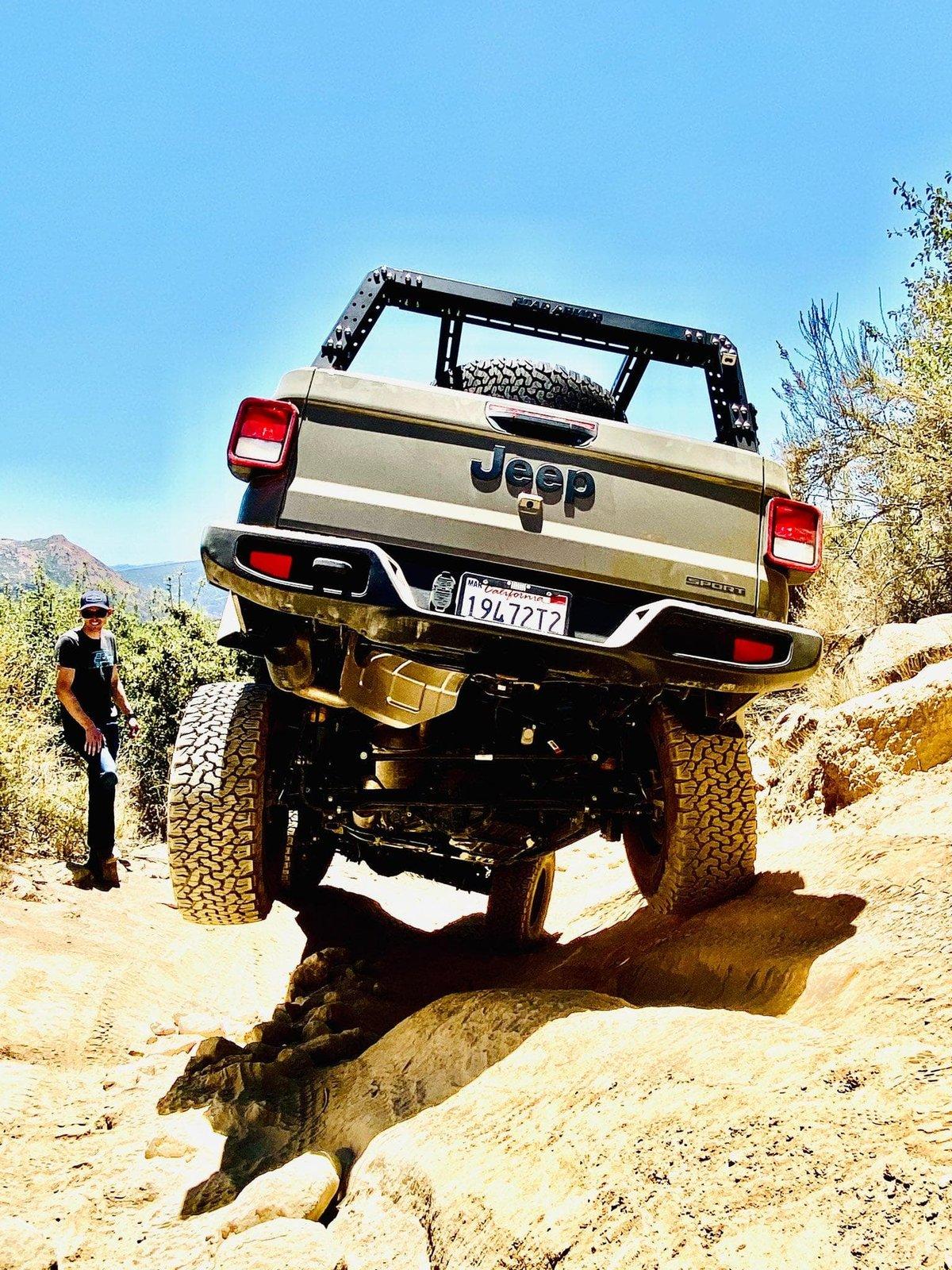

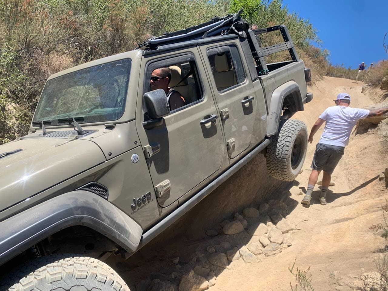

So i was out wheelin and generally speaking, i really enjoy the MT while crawling however... this time around it was a very slow technical crawl and i stalled... a lot.
I've been driving stick since i was 16 (34 now) and very limited offroad experience.
I had a hard time (4L) time keeping it at a good pace while crawling and giving it enough gas so the engine doesn't stall but then not feathering the clutch the whole time while in a climbing / low speed situation.
You guys are the experts, what am i doing wrong?
Should i just get better at crawling inclines and also feathering the clutch?
Is there.. a way for me to be in 1st gear 4 low and keeping a slow crawl without stalling / having to feather the clutch?
thanks!
Pics below from today's fun.
Nothing wrong. Next time stall less. Just remember this is a skill. You get better at it. Oh, and try leaving it in gear, not stopping to assess. Pick your line and go with it. Start in 2wd. When you get stuck, 4H. Only use 4Lo to get out, or go over, or go through, when you're serious. Cool pics. Looks like a fun day!

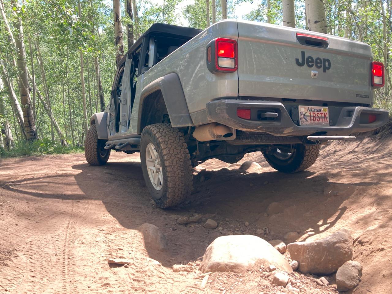

I took mine for the first "legit" mild off-roading last week, and generally agree that it will crawl as needed in 1st gear, 4L, 285s, stock Sport gears, etc., in Arkansas.
EXCEPT: I wasn't in Arkansas, I was on Pearl Pass Rd. in Crested Butte, CO. at 10,000ft.. this engine has NO 'go' up there till like 3Krpm... I didn't even get up on the ridge, as we were time constrained, I basically drove the approach and turned around. There were a few times when i stalled uphill against a bump, and had to basically smoke the clutch to get going again. Its the first time I'd have preferred to have a torque converter.
Be nice, this isn't a real "flex" photo, just a pic my brother snapped as I turned around at a fork in the road.
