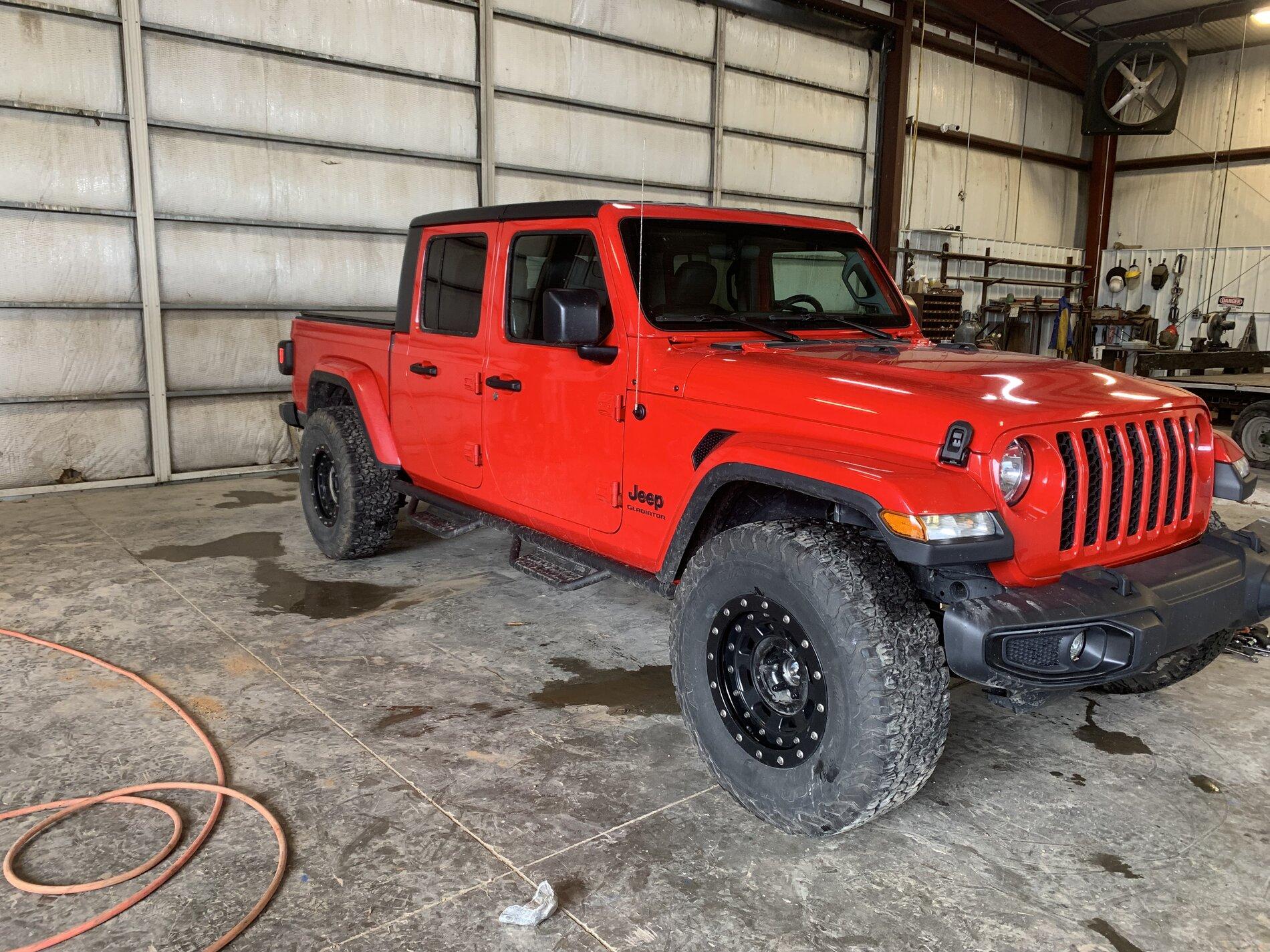

Here’s 315/70/17 bfg at ko2 on 17x9 kmc wheels no rubbing ( took mopar lift off for my new gladiator) I kept wheels and tires too but here’s a pic with it no lift
Jeep Gladiator Oh geez, not another tire thread.... CE92D8BE-AAE2-47A2-B3F3-44C2FD07A698

3.73’s with ~35” tires do well enough, you loose a bit of power, but it’s not gutless.
With a 305 width your enemy will be your LCAs and sway bar end links, I’m on a 295/70r18(34.3x11.5) and I am losing some paint on my LCA’s even though I have never felt or heard rubbing, another 1/2” of width on a 305 would make it bad enough to justify spacers or new wheels in my opinion.
My “rub” is more Likely from caked on mud from than the actual tire so there is a chance 305’s would do fine. On flat ground, lock to lock I don’t rub anywhere.
