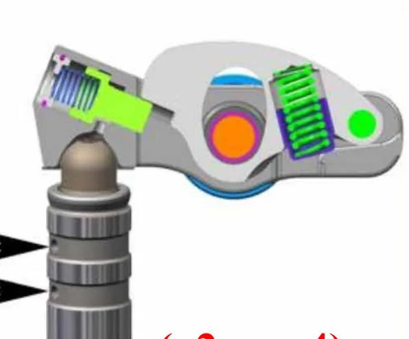

Normally, the high side of the follower runs against the cam's high lift lobe, held there by a spring.
Once there is enough wear, the follower's middle section can't be kept against the lobe and will slap at it.
In this pic, it's locked in high lift mode, but if it wasn't, the spring to the right (green) would still keep the follower against the center cam lobe. With enough wear on the cam and follower, the center section would hit the stop and would slap against the cam lobe.
At least, that's how I see it.

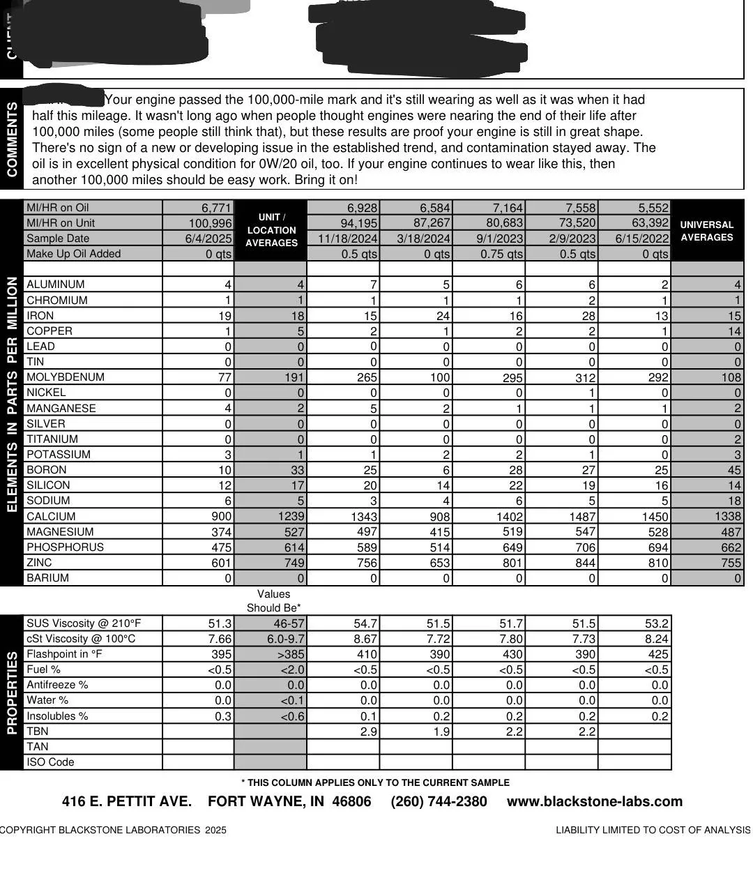

I thought I'd drop a oil analysis report on a JT that has a few miles on it using Valvoline 0W-20 with fairly consistent oil changes. I was looking for a certain thread here about life cycle of 3.6 failures, oil type used ect. I have posted on but not found. So then here is a history for a 2020 in use since end of January 2020.
Jeep Gladiator OIL, 0-20 or otherwise (couldn't find the other oil threads) Screenshot_20250622_141442_All PDF Reader
Food for thought, I've spent more on having oil tested than cost of changing oil and filters. But it was a verification of oil changes and tracking, wear or problems (if any developed).
Thanks for posting. More data is always better.
Do you follow the OLM on when to change or is around 7K miles your normal interval you select?

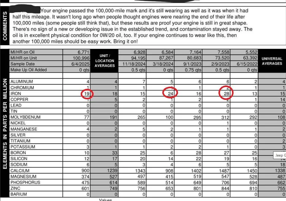

What brand oils where used in the red circled Iron results? I am not too concerned about them being above the universal averages as I think that is base on around a 5,800 mile average last I checked and you run a but farther than that so there would be some uptick to be expected.
Thanks for any information.
Huge change in moly - different brand?

I try to change it when 20% or less oil life by the dash gauge, some have been lower. To add much of it is towing trailers too. One is a over-built utility trailer that is very H.D. for its size made by company that makes commercial work trailers to haul zero turn mowers and like equipment. The axles choices are 3500 or 5000 single or double. That trailer outweighs my 4 wheelers together. Next is my travel trailer in the 3000 lbs range, damn I need to get it's weight.

Thanks, what brand oils were used?
Dealer oil on first 4, Valvoline on almost all others, Pennzoil a time or so. When I didn't find Valvoline. I still have a 5 qt bottle of it to use.
