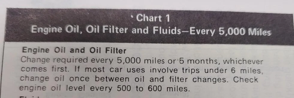

I saw someone mentioned changing filter mid interval and I think that's an interesting idea, but I don't think the filter would be obstructed at 2500 miles.
This is from a FOUR CYLINDER car owner manual from the mid-1970s -
Jeep Gladiator OIL, 0-20 or otherwise (couldn't find the other oil threads) 1748387737919-ey
Short drives KILL YOUR OIL.
For the 6 and 8 cylinder versions of this car, it was 7500 miles and I'd have to look at the other recommendations for filter and such.
