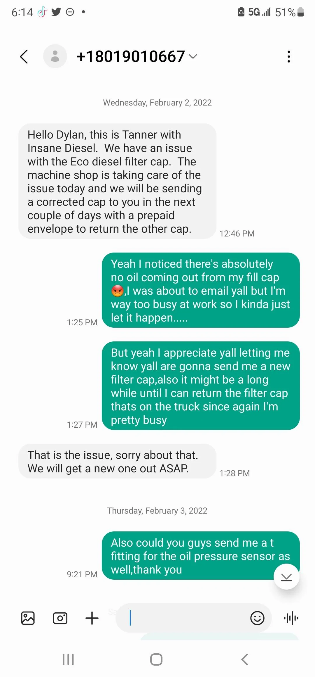

It's a design flaw in the filter Cap I instantly noticed cause the filter snapped in but I noticed that the filter fell in all the way and I was like "wait.....how is oil supposed flow through the oil.....oh it can't cause the filter blocks it"
but yeah I was about to contact them,2 days later after the install as I was about to send an email with lots of ?colorful language? about my situation,they just now let me know of the design flaw,
but as of now i left about 1/4" of space so as of now so the filter is loose in there but there's oil flowing through the 2nd oil filter with very little flow but hey it's working,still annoyed that I gotta take the part off and re install it again....so I'm gonna do it on my next oil change
Also heres their explanation of the filter Cap
Jeep Gladiator oil bypass Screenshot_20220209-181404_Messages
