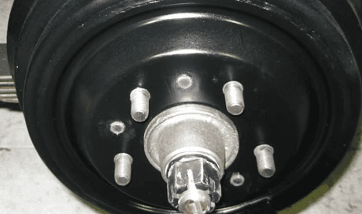

How do I know which one of these if I have on my JTRD?
Mine is a 2021 built Nov 2021, which is after the date range on the TSB, but I have this same clicking noise on low speed bumps and a lot of creaking when turning and braking at low speed. Will check the torque this weekend.
They also do not lubricate the wheel hub assembly at the factory. This caused my cherokee to make a ticking noise when turning or going over bumps at slow speeds. Lubricated it and the noise went away.
