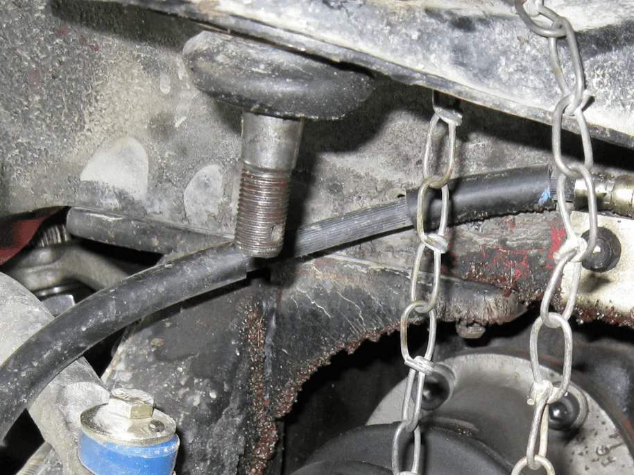

There's no wear possible there unless it was loose to begin with. That is a tapered joint. That means that as you tighten the nut it pulls the tapered ball joint stud into a tapered hole in the knuckle. It's an interference fit so the knuckle hole is slightly "stretched" over the stud as it's drawn in.
On OTHER vehicles, cars, for example, you can pull the cotter pin, remove the nut and the ball joint won't fall out. In fact, it takes a tapered "pickle fork" to wedge it out, or smacking the knuckle really hard on the side with a big hammer to cause the parts to separate.
I can't quickly find my boxes of spare suspension parts for my cars - and the control arms I have on a shelf have the ball joints removed from them for easier stacking and storage (not like the control arms on these trucks) but here's a "stock picture" of the tapered shaft almost all other vehicles use to secure ball joints to the knuckle.
The fact that these are not only not properly torqued, but sometimes loose, is perplexing as once tightened PROPERLY, you can remove the nut and the stud is held into the knuckle by the fact that the knuckle is sort of stretched around it, and it's a tapered joint!
Jeep Gladiator Omg Have You Checked Your Lower Ball Joint Nut 1669738353153
Finally found a pic of where I was rebuilding the suspension on an Eagle - note the tapered shaft of the ball joint. Tapered joints like this are crazy strong.

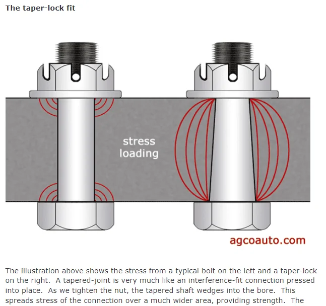

The joint is effectively sealed from water - preventing rust. You won't see these rust together unless the tapered hole is worn or egged out from lack of torque, or running it loose.
Found a decent explanation -
Jeep Gladiator Omg Have You Checked Your Lower Ball Joint Nut 1669738981546
40,483
53,972
BTW - the tapers are often standard, or were. About 7.5 degrees? Somewhere in there, and there were tapered reamers to put the correct taper back into parts like steering knuckles if they got worn from being run loose.

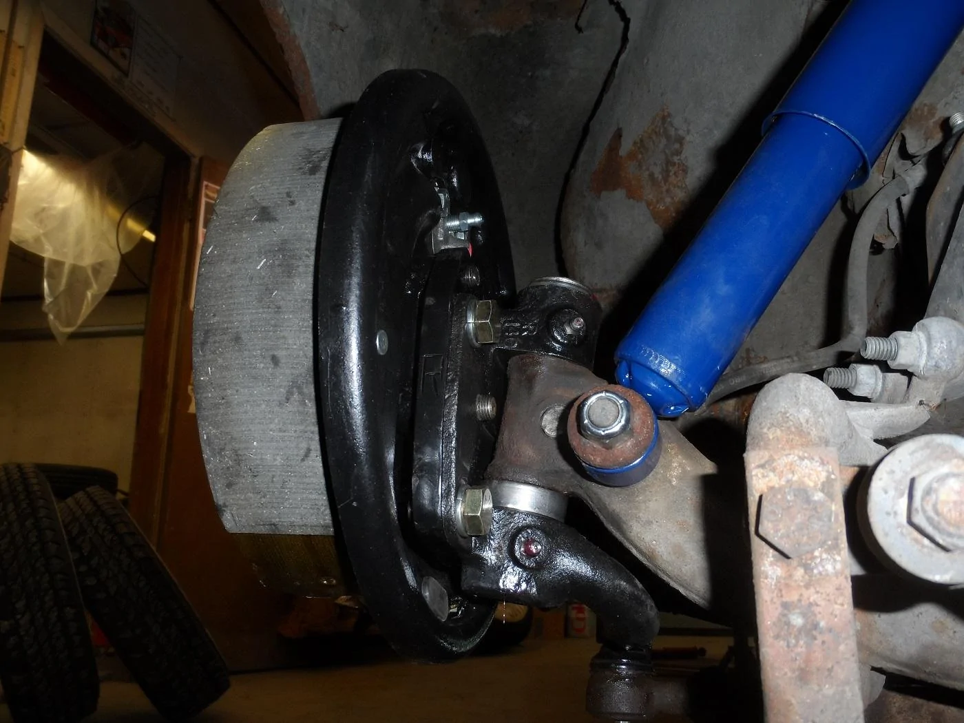

I've done my share of work on king pin suspension/steering systems. Pain in the butt and there's more to them installation and maintenance-wise. There's also bearings in there........
This is quite different - but there's 2 pivot points that need lube and then there's the bearing that takes a heck of a pounding. When they wear, the impact is instant. Ball joints are at least spring loaded and take time to get "loose" enough to be a problem.
There's also more to repair and maintenance on a traditional king pin.
Now @Blade1668 is gonna love this - these are the brakes off the front of my 73 Pierre Cardin Javelin mounted on the front of this old Ford. (my 73 is just too fast for drum brakes). This setup with the custom drop plates allowed the front of this Ford to be dropped, while maintaining the right scrub radius.
