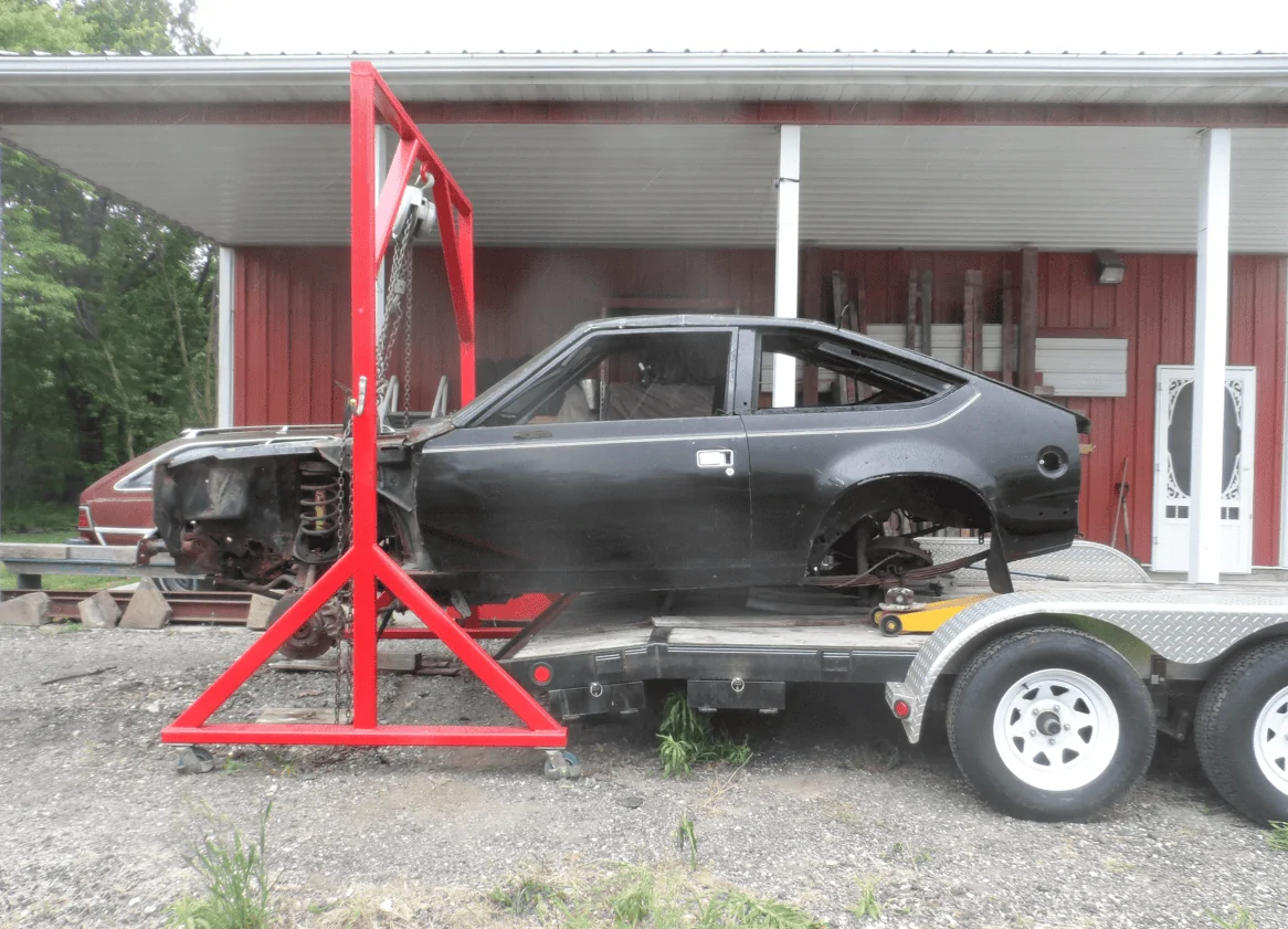

I have a small telescopic Titan Gantry 1/2 ton adjustable crane that could be used to take off the hard shell cover easily, roof top tent etc. probably would run $600.00 plus $130.00 for the electric 1,100lb hoist. Can be used for other heavy stuff as well like engines etc. In the past I used mine to lift a 37”x 20 tire up on the roof rack. It’s a rolling rack while not optimal it can be stored outside.
I have one that was used to load sprint cars onto a trailer. It's engineered to hold a lot more load than my current chain hoist will handle, still, I can lift a car up to back a trailer under the car.
The gantry crane isn't wide enough to back the trailer clear under, but I can get one end on and set it on dollys or jacks and then raise the other end................

Very nice! Very similar setup the one I have adjusts from 7'9" to over 11 foot. They have another model that will fit inside a standard sized garage height wise. This one is just wide enough to fit my Gladiator between it with some room to spare but not much. I chose the electric hoist vs chains since I didn't want the chains to damage the paint. It also has a wireless remote control for it. I also have the trolly that rides back and forth on the I-Beam it's nice but can be kind of a pain as well especially on uneven terrain.

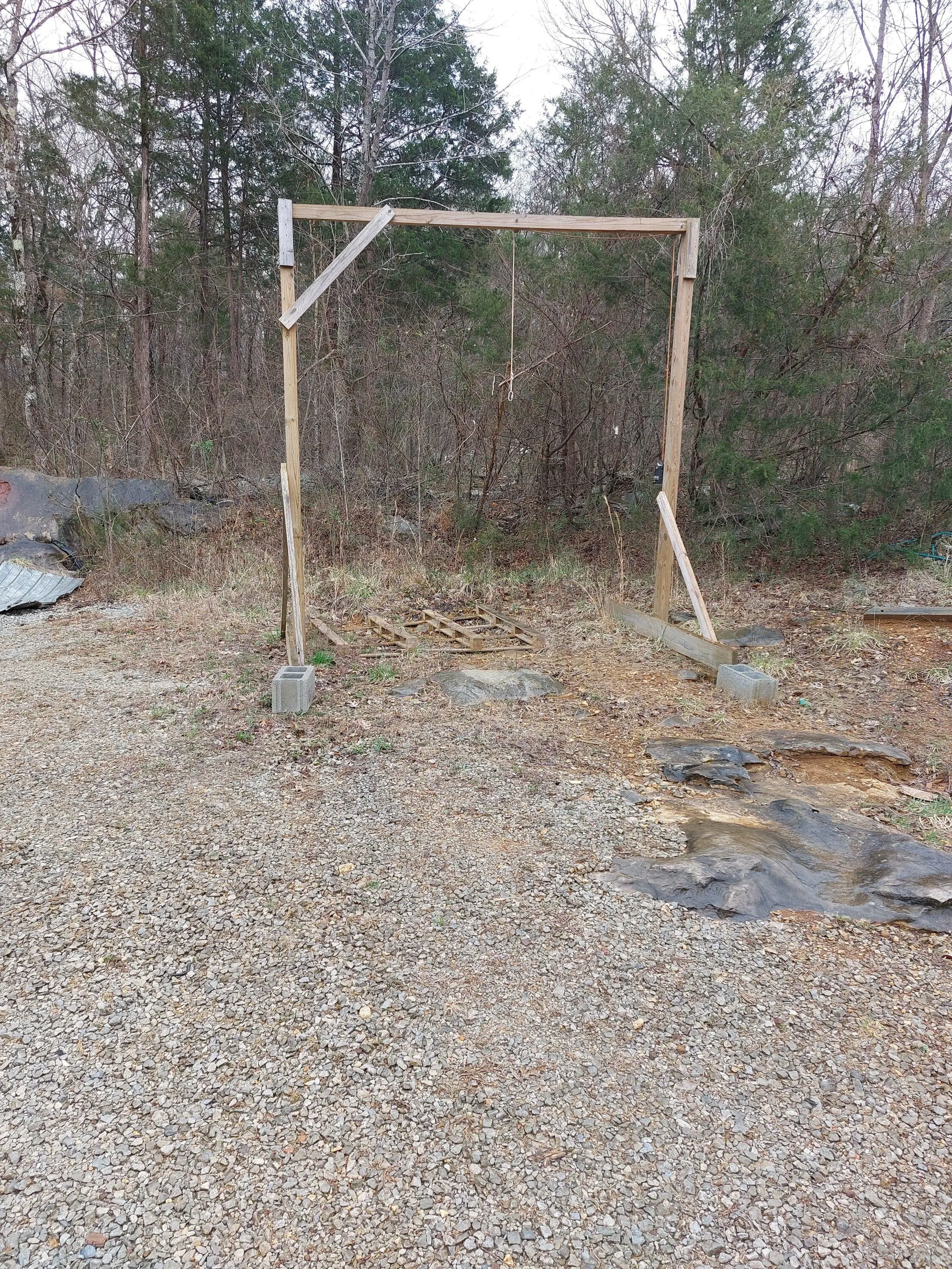

Ooooohhhh I need that for taking me tent and rack off all at once
3 4x4s, 2 2x8s, 4 2x4s a few low cost pulleys and low buck hand winch. Misl. Lag screws. What I did so I can remove my LJ hardtop, put on shell on JT, unload trailer, RTT or whatever. Not as elegant as his gantry crane but not to expensive and I built it, stood up by myself. I wouldn't try to lift a lot of weight with it as is but 500 lbs isn't really a problem. I do need to add a few more 2x4s to brace right side.

I replaced the cable on hand winch with synthetic line and use cordless drill to raise and lower the load. Spur gear hand winch. ;)
