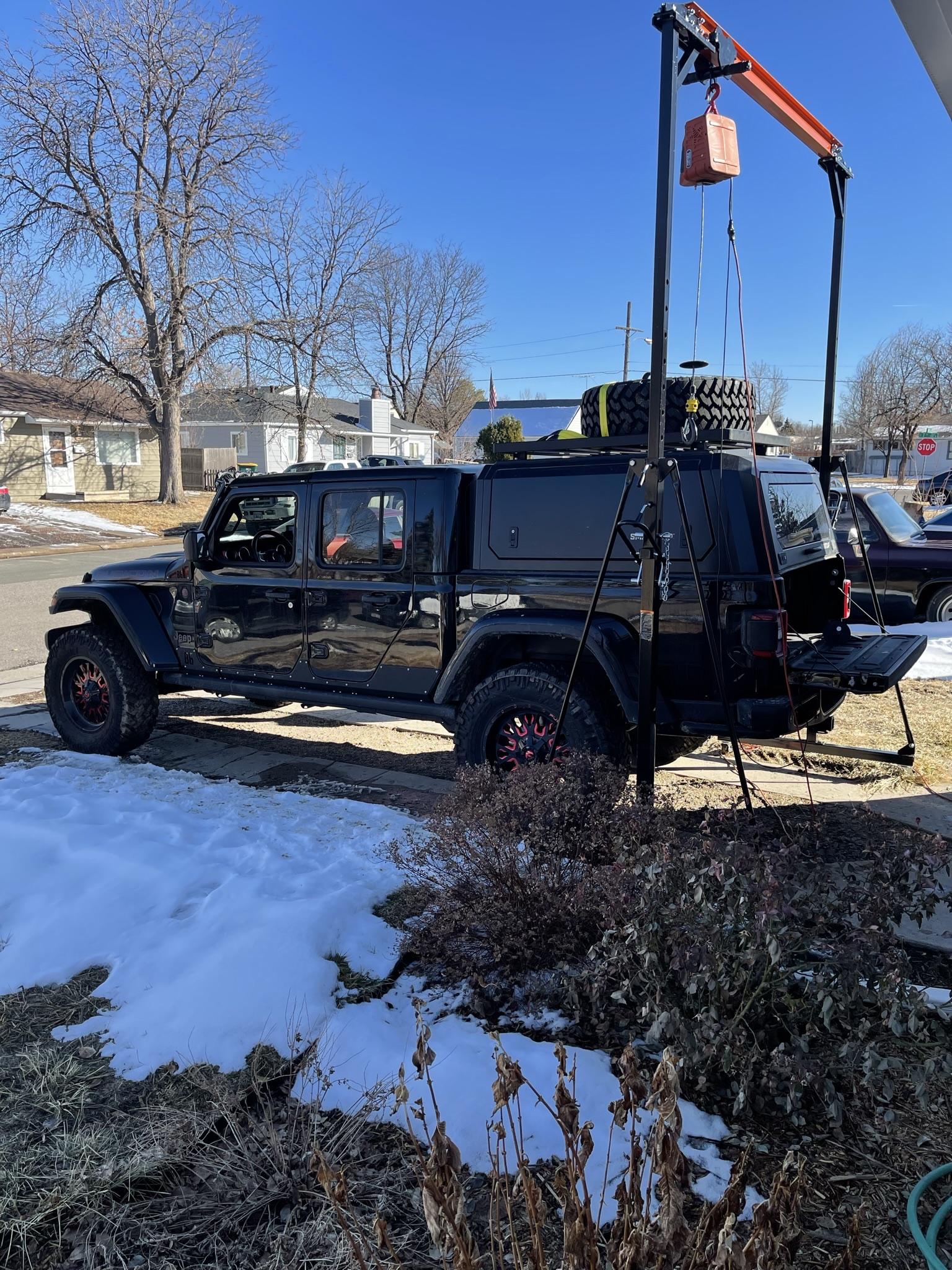

This is my Titan adjustable gantry crane 1/2 ton. I have a vevor 1100lb hoist attached. It's 8'3" at it's lowest height and goes to 11 feet tall. I use it outside it's on wheels and rolls around. It's how I got my full sized 37"x20 spare tire up top on my platform rack. I also have the titan push trolley. It's probably the most inexpensive Gantry available. I doubt you'd be able to build it much cheaper.
Ooooohhhh I need that for taking me tent and rack off all at once

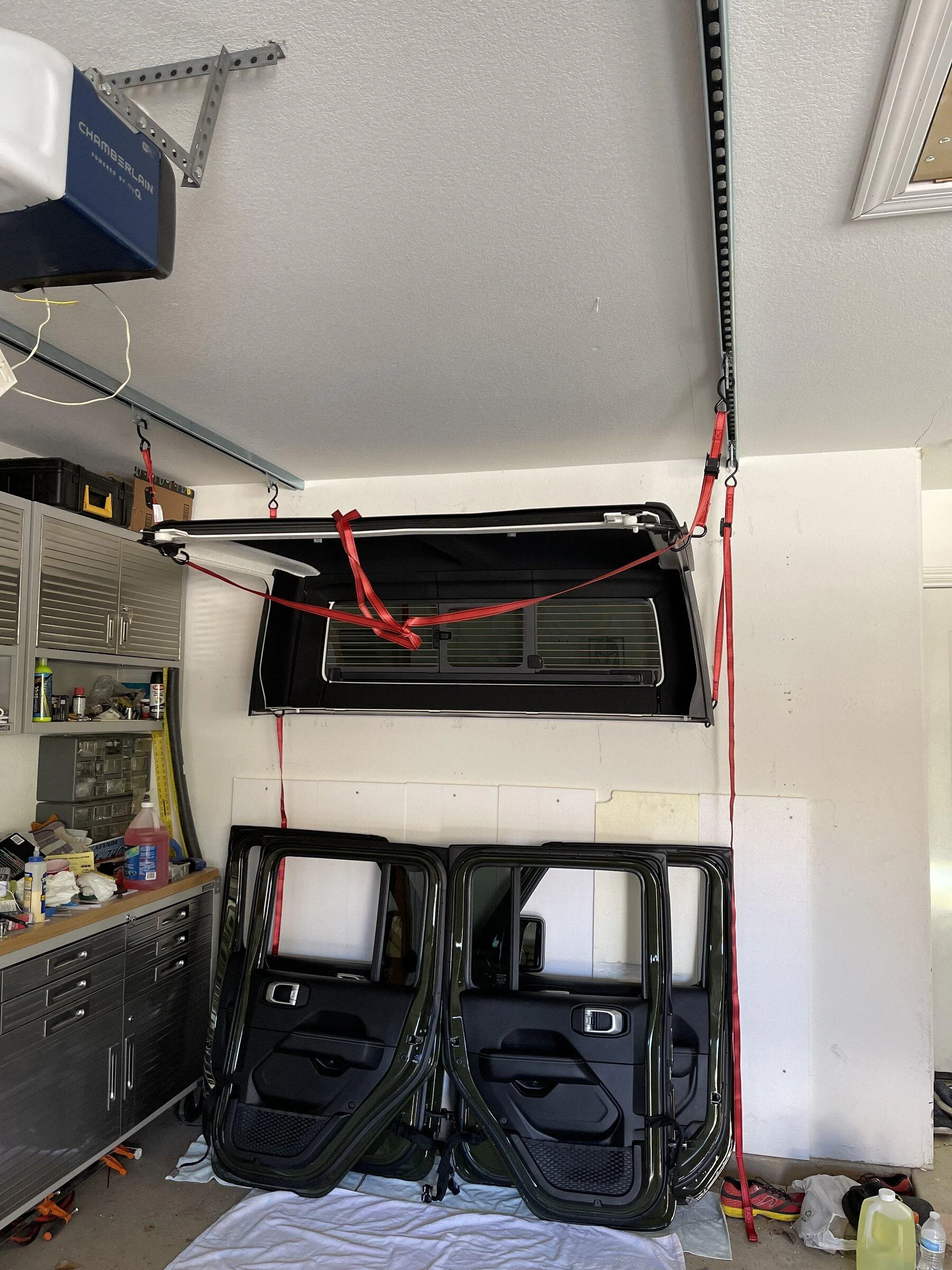

My garage isn’t very tall and the top sits right under the garage door opener so not a lot of clearance when taking the top off. I mounted two pieces of unistrut and use four trolleys so that when the top comes off I can slide it back and raise it higher.
This is genius.

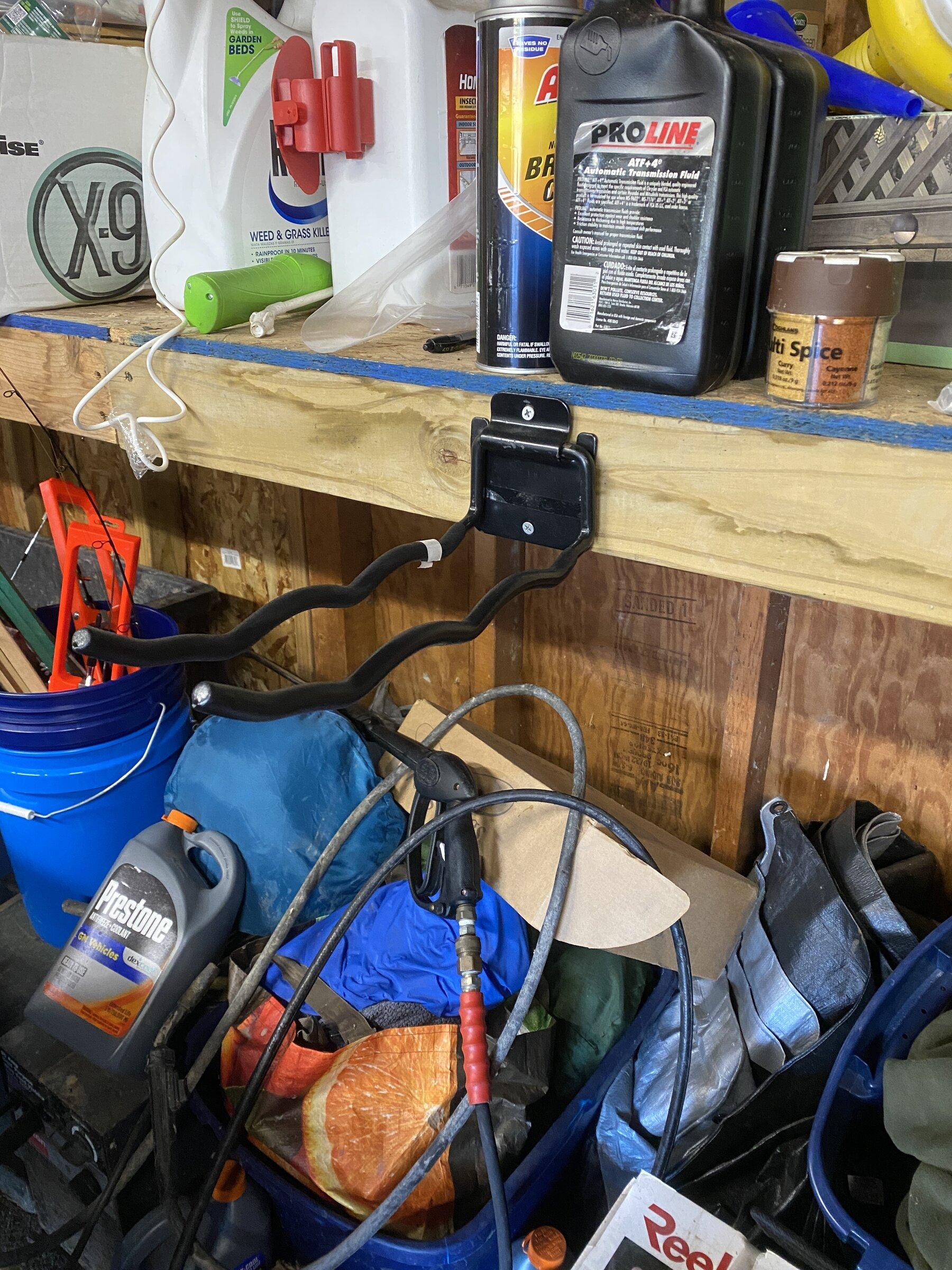

Door hangars
