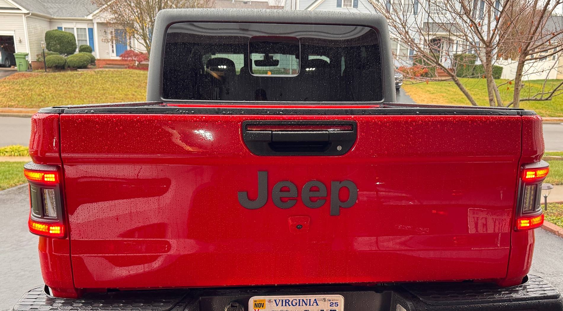

Ditto Tazer or JSCAN. Both can make the change to LED. After you make the feature change, you can remove the Tazer too. If you leave it in, there are features that it can do beyond making the simple feature changes JSCAN can do. It also does not plug into the OBD port as others have stated.
Jeep Gladiator Oracle Flush Tails, use JScan or Oracle adapters IMG_4525

Yes, JSCAN can make the feature change like the Tazer Mini. Please note the Tazer does not plug into the OBD port and it does not not have to be left in after you make a feature change like this. IF you want to leave it in, it offers things that Jscan can not do.
