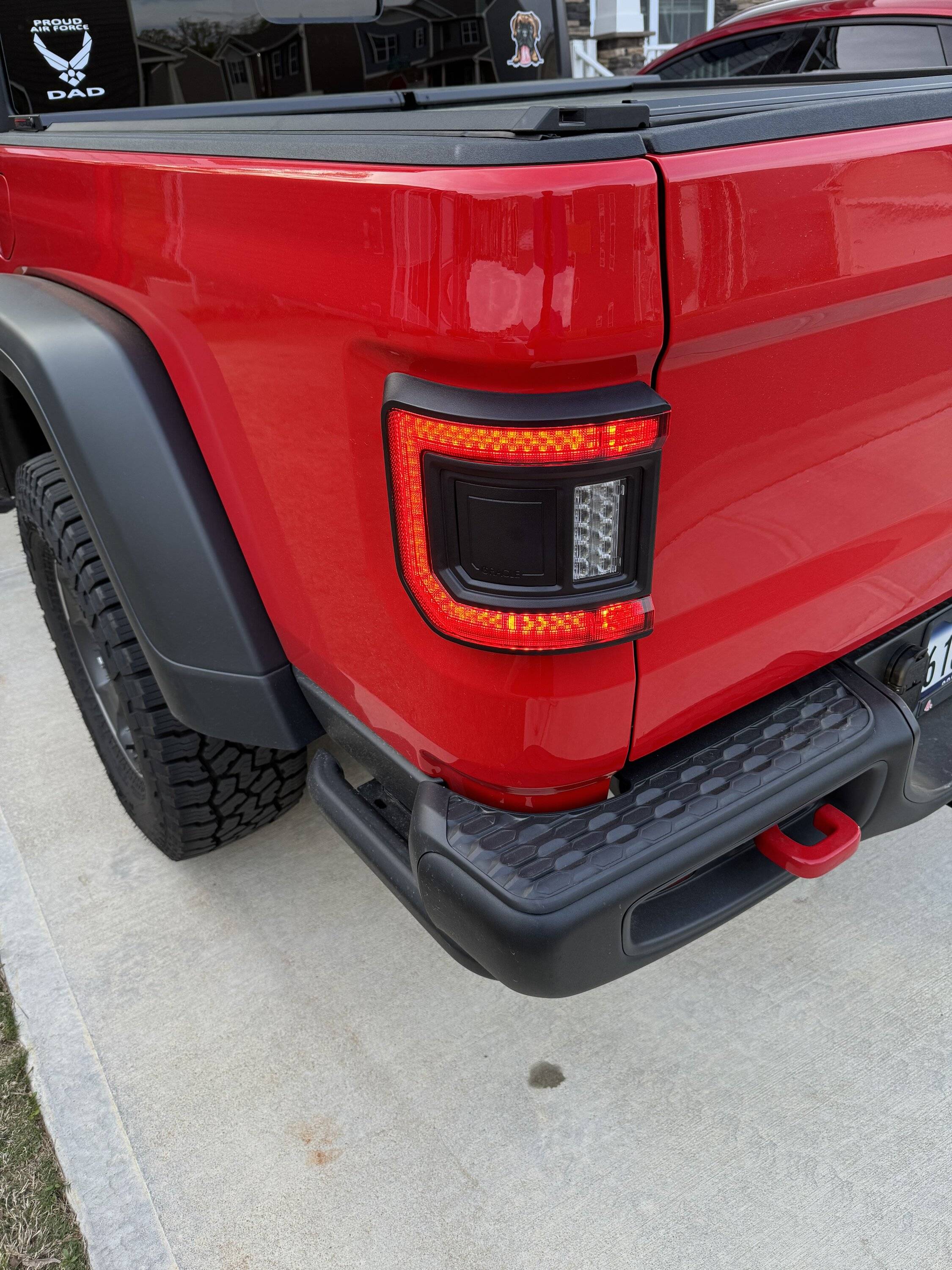

FINALLY arrived today. They shipped on 3/18! Anyway, it was about a 20 minute install and no errors messages. They look much better than the clunky OEM lights. Wife just shook her head and, “Ok???”

That sounds about what my wife would say, but if I added anything more to her Bronco it would be "Oh wow they look fantastic".
Oh - they look nice and maybe in the future for myself.

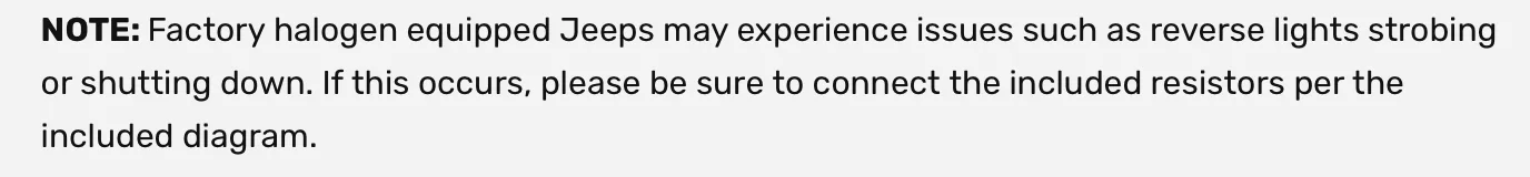

Any issues?
Did you already have LED tailights?
I put these on my 2022 Overland. (non-LED)
Had two issues. (08-2022 build date on Lights)
FIrst issue was back up lights did not always work.
Oracle sent me in-line resistors, that fixed the problem.

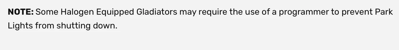

Second issue with parking lights flickering/pulsating.
Brake and turn signals are fine.
They sent me a newer set. (06-2023 build)
These were actually worse.
More flicker, then right side stopped working completely.
Oracle wants me to get a Tazer and change my programming of the rear lights to LED.

The flicker and issues are most likely connected to the BCM expecting voltage readings of halogens. Halogens have a much greater draw to them than the LEDS and then readings back to BCM likely look like a light isn't "installed" or way lower voltage than expected. Sometimes a reprogram from the expected halogen lights to LEDs is required. The easiest way is to use a programmer to make that individual adjustment. You can also take it to the dealer or professional to do that. I don't know how much they charge for that.

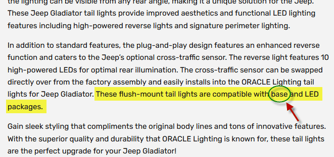

ORACLE Terry:
With all due respect, I purchased these with the assumption that they are plug and play.
As per the ORACLE web site description below, "compatible with base and LED packages"
Apparently, that is not accurate if I must purchase a programmer or pay the dealer to reprogram my taillights.
Bought multiple products from Oracle without issue, but this purchase is turning out to be an expensive disappointment; with the Product and Oracle Customer Service.

ORACLE Terry:
That's not happening.
Just a suggestion, you could get JScan and the cheaper adapter (way less than a Tazer) and program you Jeep for LED tail lights.
Sometimes time is worth more than money. If you like the lights just program the Jeep for the LED Tails.
I would want a resistor in my wiring if I could just change the programming.... Much neater.

ORACLE Terry:
The majority of the time, it is as simple as plug and play. The issue isn't necessarily with the lights but rather the way that the Jeep regulates and understands the power. We have noted on our website these is specific notes.
