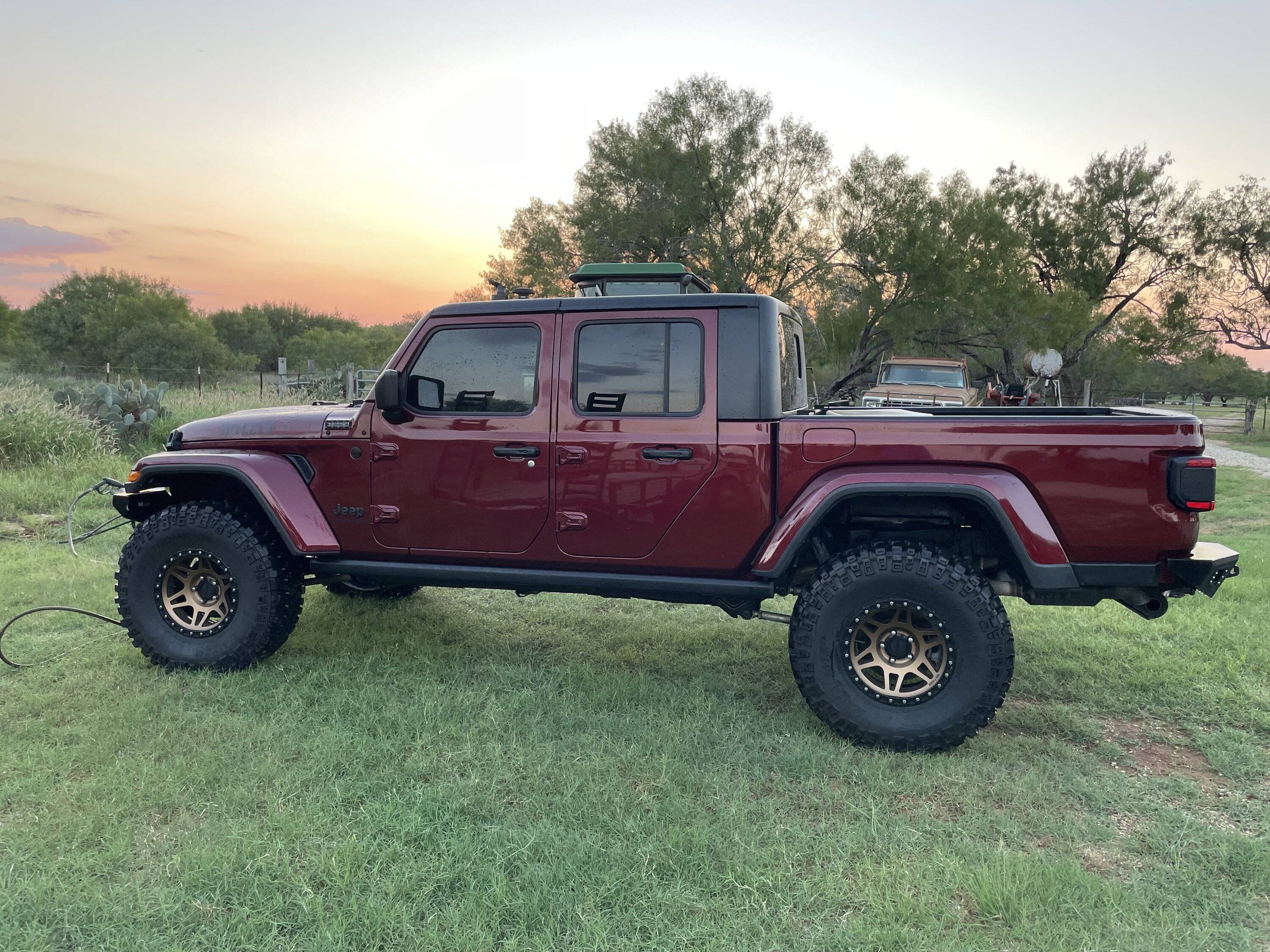

I bought one almost identical to what you’re describing, I have 37 and 3:73 (changing to 5:13) at 70 I’m usually in 6th gear. To put it in perspective a friend just bought an overland diesel ordered the same metal cloak lift and it cost him for rims tires and lift and shocks almost $11000.00 so if it’s a good deal and you like it you save a lot of money, if you want to do it yourself you’re gonna spend a lot. It’s to each his own. I haven’t regretted buying this one at all. It’s drivable with 3:73 but it’s not the best.
