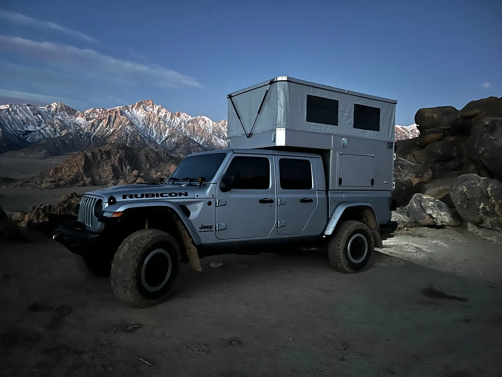

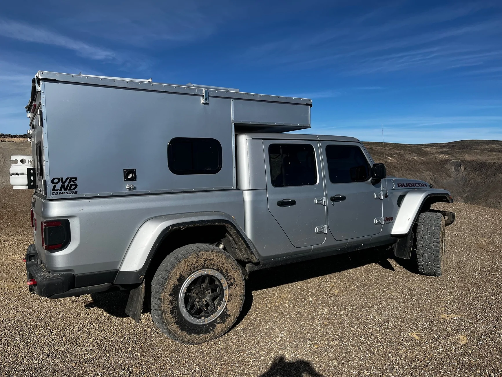

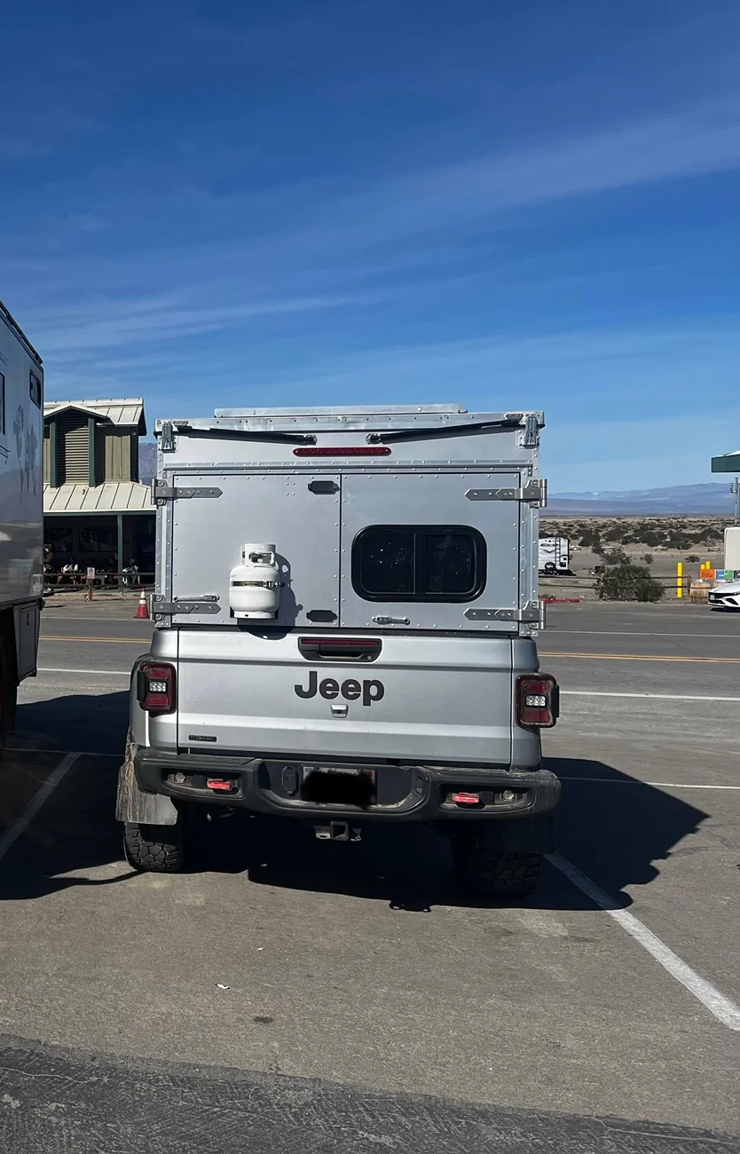

What all ya got going on there? Camper mods etc. or what did Jay and Maggie build for you? Any special requests?
Nothing too special just a sliding window on the passenger side and one the rear Barn door
