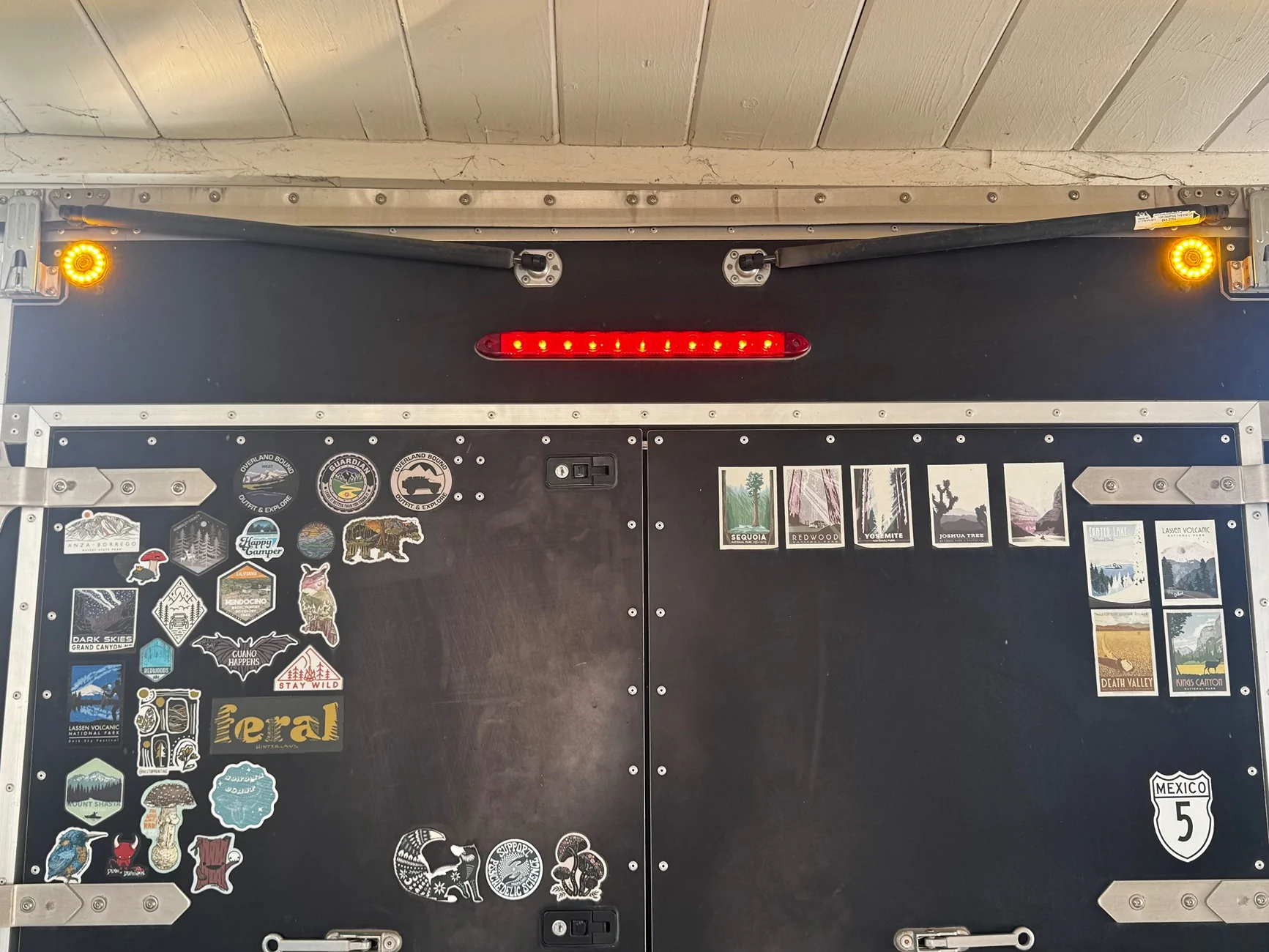

Lights! Long time project completed. Ever since having to get the home link buttons when I ordered my truck, even though I don’t have a garage door for them, I was finally able to use them for desert chase lights and also utilize the added “brake light” on the camper as another rear light when I want the extra visibility in bad weather. I can turn them on/off independently with the multichannel relay. I can also use them as camp lights since it runs off the Li battery in the camper. I also have a set of red lenses if I want to swap out the amber lenses on the chase lights.
Jeep Gladiator OVRLND Camper roll call IMG_0354
How did you use the home link buttons for chase lights?

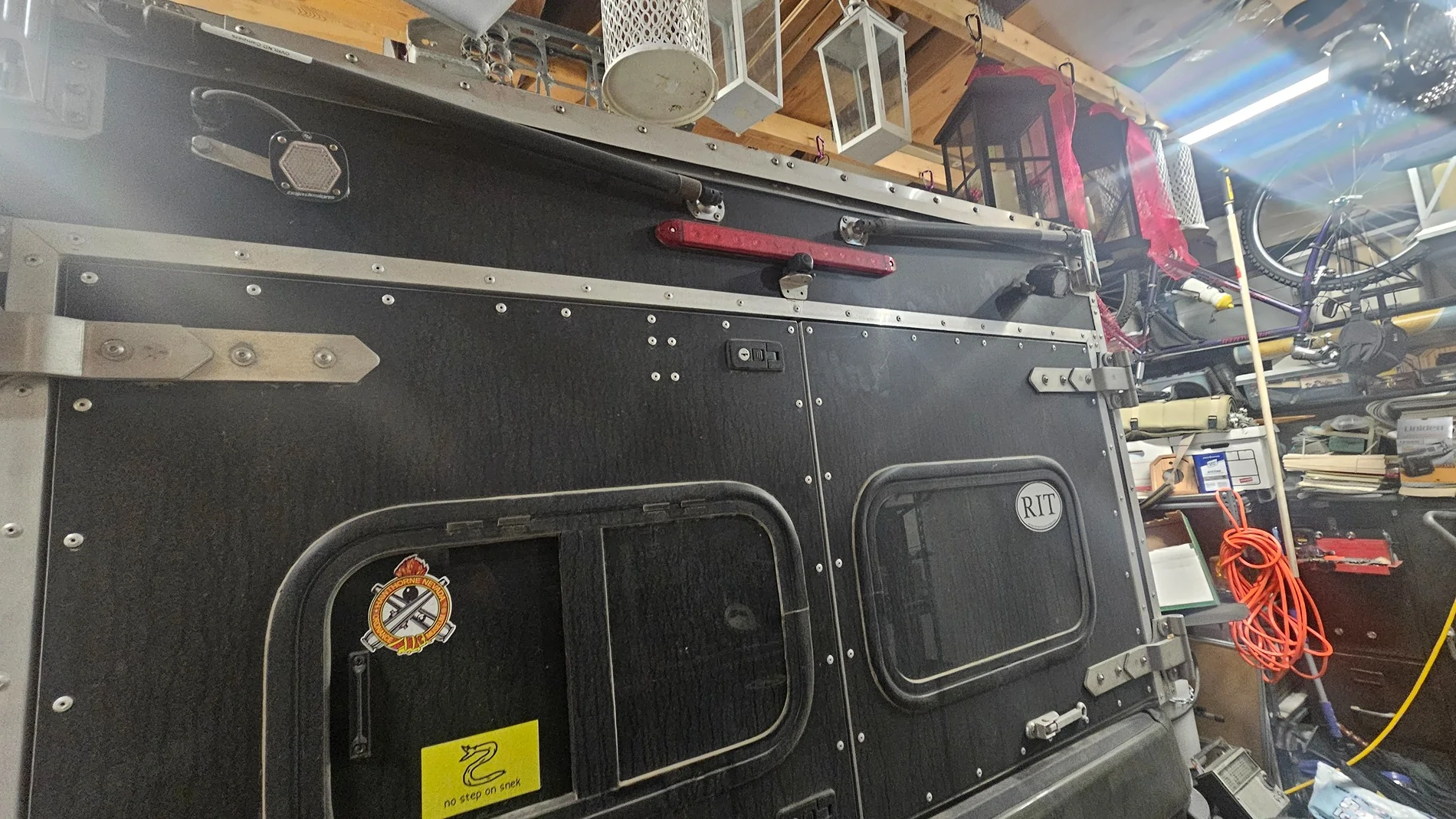

Nice job. I run mine through my S-Pod, and I have it programmed so that they turn on automatically when I shift into reverse.
Jeep Gladiator OVRLND Camper roll call 20260110_165746

I use something like this.
https://a.co/d/iFx2vTt
Jeep Gladiator OVRLND Camper roll call IMG_0355
I can set each of the 3 Homelink buttons to a separate channel. I can set a third channel for undercarriage lights, which I might do next. I can turn them on from visor when driving, and later turn them off or on with fob while in the camper. I just hated having those visor buttons with nothing for them to go to.
