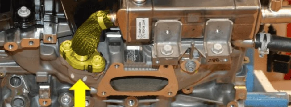

Driver side, big metal thing is the cooler above the valve cover, on there you will see the valve
250
40,612
54,309
This is one version. it's "cooled" and may be on either side, depending on the application.
Left side for us.
There's more to it than "cleaning" since they went with cooled EGR.
Jeep Gladiator P2457 code 1689115474745
That code is more likely with the cooling part, the temperature sensor, etc. not the egr as you think of it.
This isn't like the old Ford EGR where you unplug the carbon, open the passages and it works.
From a diagnostics chart -
The EGR cooler must remain within a specific temperature range to efficiently reduce emissions. The Engine Control Module (ECM) determines the efficiency of the EGR cooler by monitoring both EGR temperature sensors while the EGR valve is active. The Diagnostic Trouble Code (DTC) will be set when the ECM detects that the EGR cooler efficiency is lower than a calibrated value for greater than 100 s.
