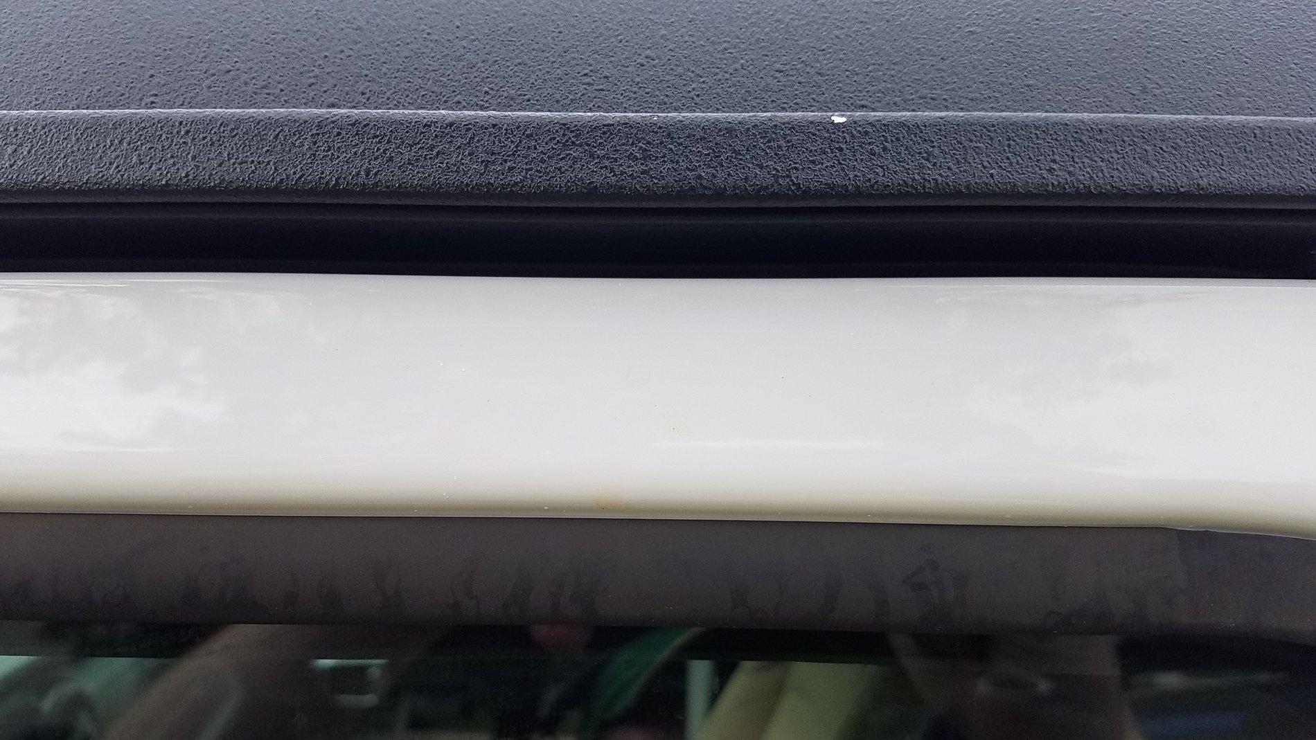

I want to paint the white inside of the freedom top matte black. What paint should I use? Would something like krylon work? Anybody from the jl side hear of somebody doing this?
I know @gsxr310 did it, looks like his was professionally painted inside and out? Looks nice, https://www.jeepgladiatorforum.com/forum/threads/painting-the-freedom-top.17483/#post-260513
Then apparently I had a small chip in my DRIVER SIDE freedom panel (of course), anybody touch up any dings on their top before?

well this looks promising. i'll buy one of these.
https://www.cjponyparts.com/mopar-h...TNRvChthdDzVjGvIY4cNxsSpcGbRCZVhoCoq4QAvD_BwE

Mopar offers a paint pen and rattle can for the hard top paint, feathered in it looks great.
