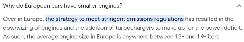

3.6 is nearing the end of possibilities of advancement. It's about as far as you can go.
And it's necessary to sell world-wide, size matters. If Jeep can't sell in the EU, they crash and burn.
Selfish Americans think only of selling to the customers here. If Jeep can't compete there or sell there, Ford or someone else will jump in and fill the gap - Jeep loses.
I believe they are also taxed on engines over certain sizes?
