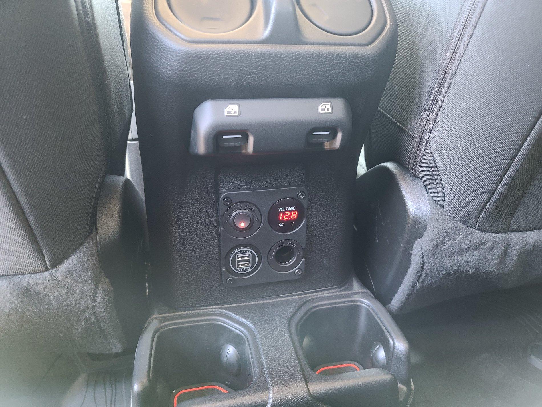

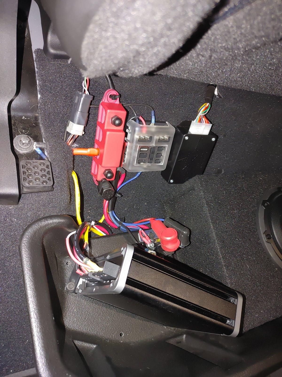

I tried to extend add a data usb, but the system will only do two as far as I can tell. My daughter's have a number of devices that are power hungry and having a usb quick charge is always nice. I need to find the brand but I bought two supercharger USBs then added an 80 amp relay and fuse block to my under seat Battery connection. The relay is connected to key switch and turns on the 80 amp relay with the key. Takes about 20 minutes to fully charge my LG phone.

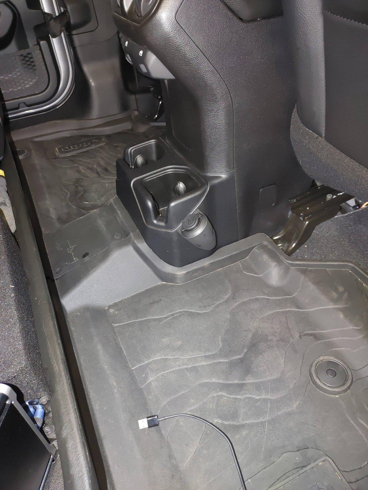

Yes, you can. It’s a $1,995 upgrade though. Just wondering if it’s worth it for that price since all I really want is a couple USB ports for the kids. I think there is 1 on the front console and 1 in the glove box so maybe I can run those to the backseat.
It’s really not worth it for the usb outlets. But the the 12 volt power outlet seems like a cool idea, specially for camping. Also in the bed of the truck you also get a 3 prong 12v outlet

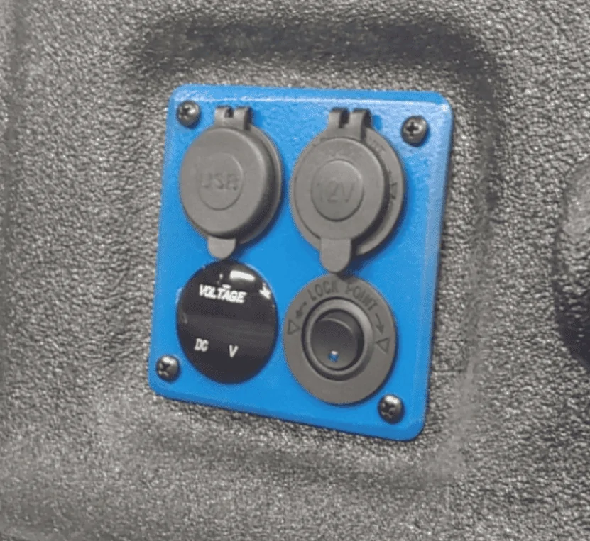

Necro thread, but where'd you get that panel?
Amazon.........that's where I got mine. I got blue to match my truck.
https://www.amazon.com/dp/B07JHH5YP4

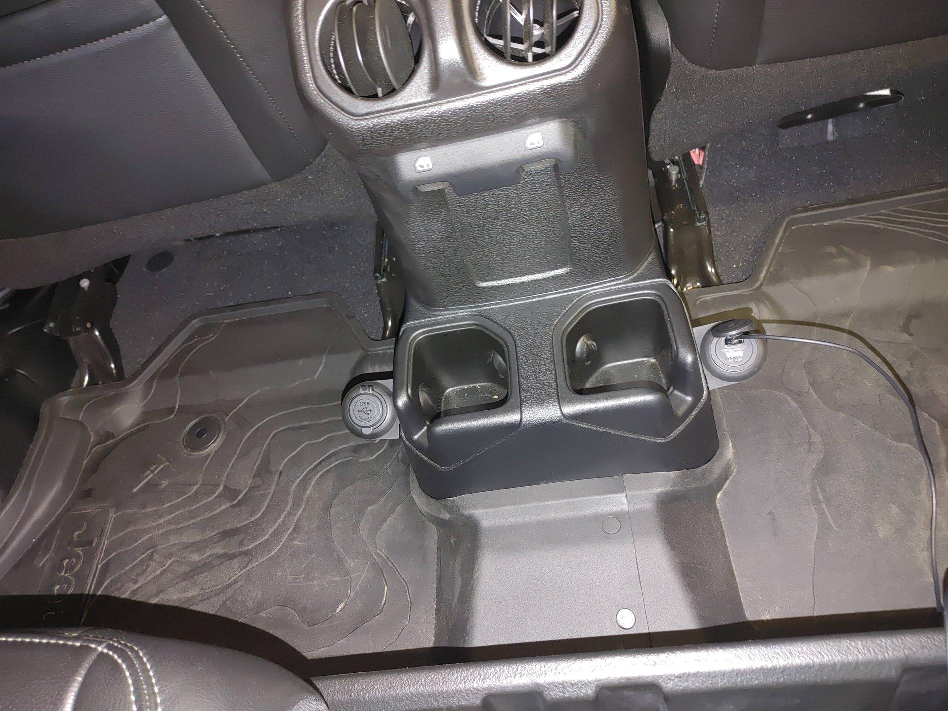

I have USB in the rear of the console, I use my 12v and USB in the truck box.

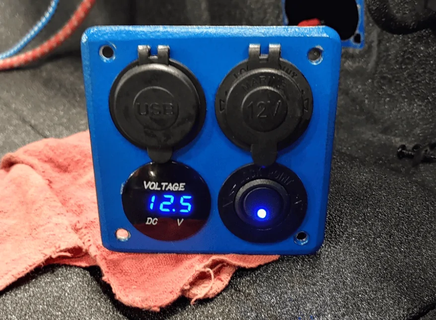

Their supplied panel was too large for my liking so I made my own from acrylic and painted it blue.
You can buy just the 12v outlet, the USB portion or any of that stuff by itself if you don't need the switch and volt display - you can get any combination or each part by itself from what I see.
Easy way to add USB charging ports in the back seat area. Piece of cake.

Thanks! Exactly what I was wondering.
