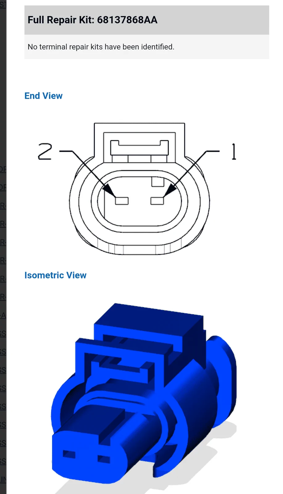

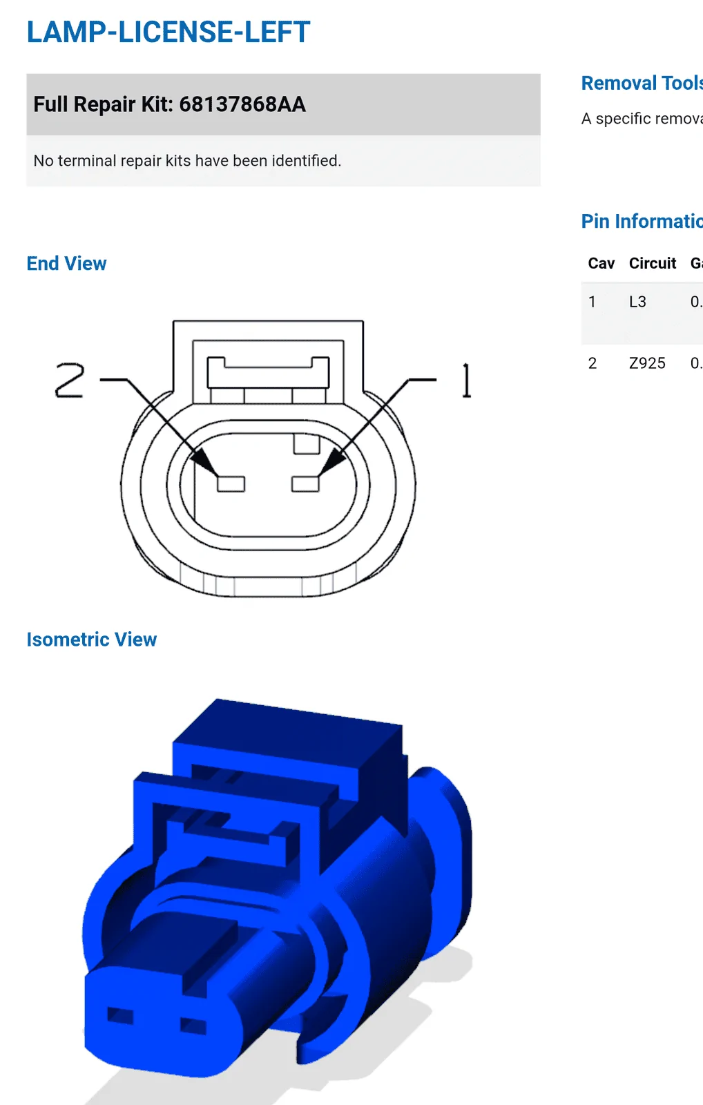

Here's the part number for the LH plug. Only difference is the color coded lead is white with orange stripe.
68137868AA
With the two wires specifically called out on the JL wiring diagram, it's possible they could be controlled separately left and right, for a backup and rear fog separately, but I have them connected together to power both at the same time
68137868AA
Same part-
  • Part Number:68137868AC
  • Part:Wiring-2 Way
  • Replaces:68137868AA, 68137868AB

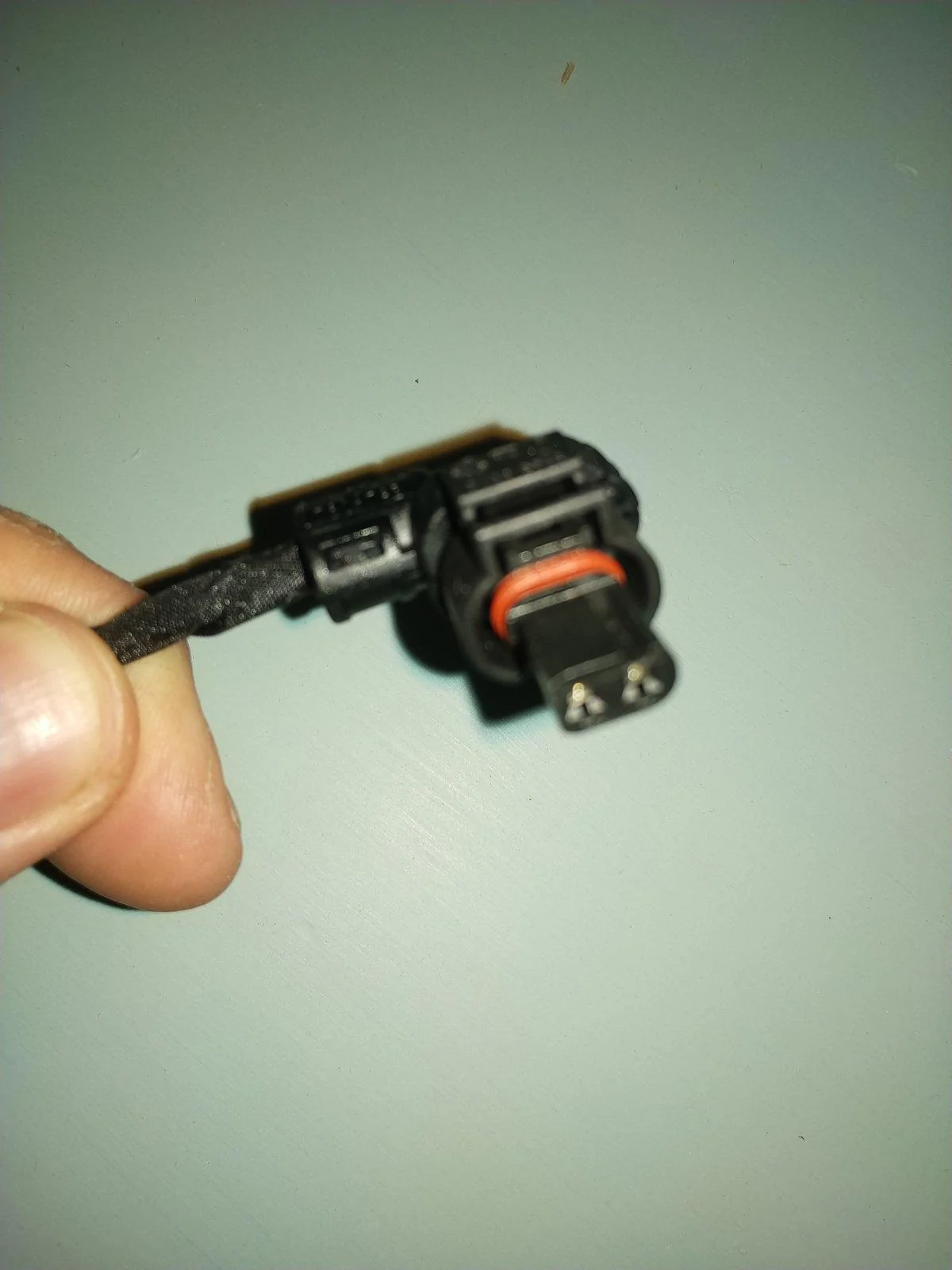

So, looking at the extra harness I bought for $24 plus shipping, the license plate plugs are the same, only with a 90° turn in them. Much cheaper option for those $41 each plugs.
