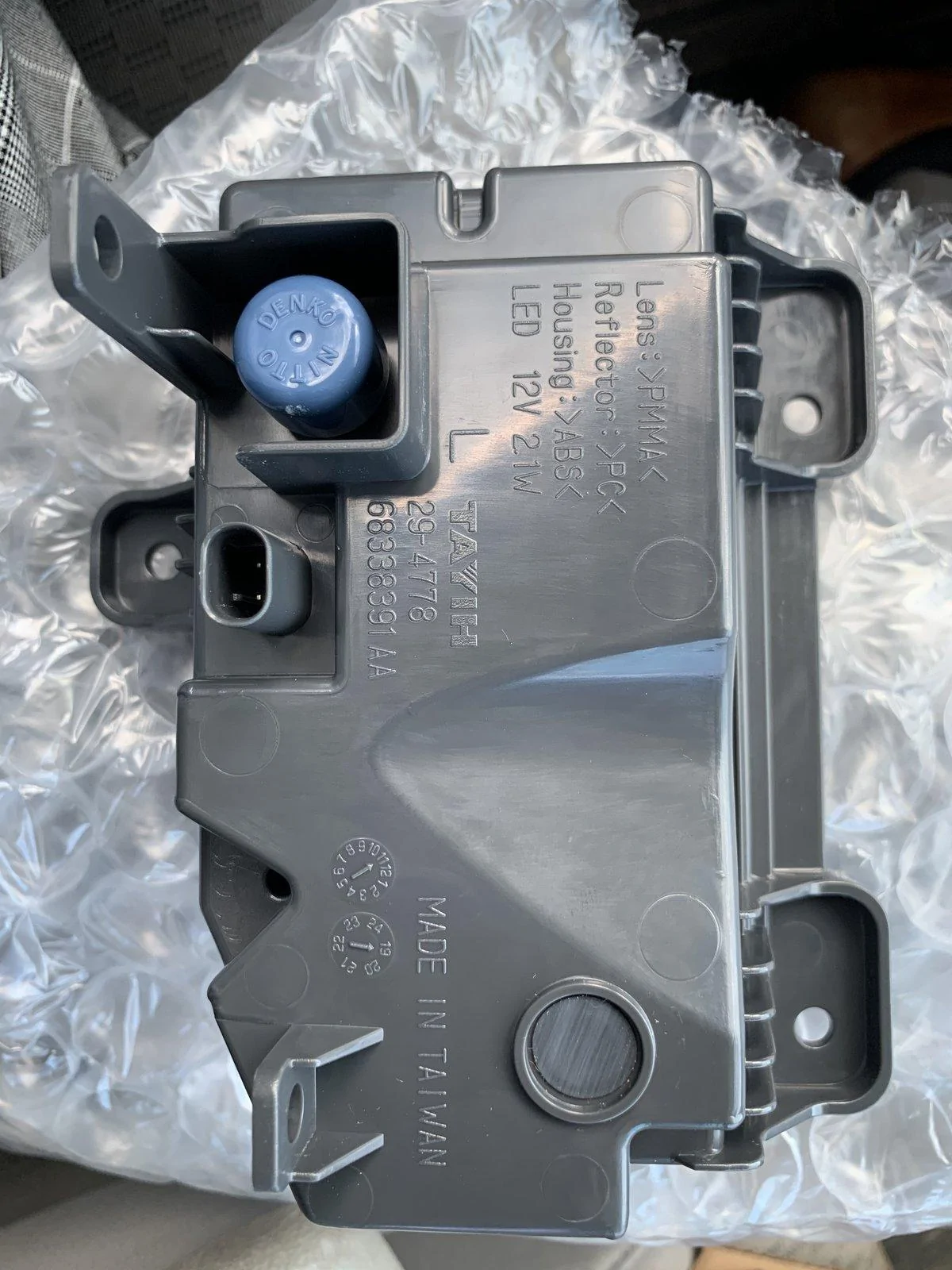

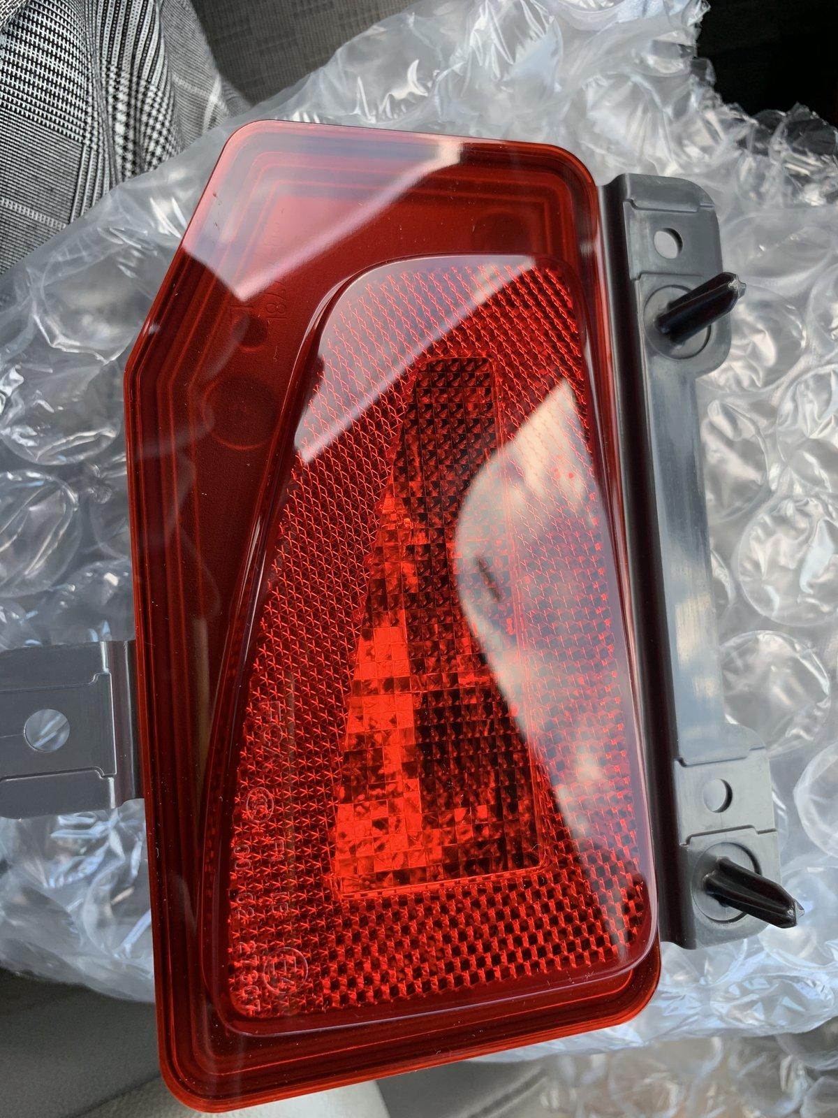

For anybody wondering you can order these directly from your parts department. I ordered the fog lights and wiring from my dealership here in Ontario and it showed up today. Pretty happy I didn’t have to order it overseas and pay customs, duties and shipping. Gonna see if I figure out if I can make it plug and play and try and find out if there is a sales code I can have flashed in to make work.
The crappy part is I’m still waiting for my Gladiator to arrive. Ordered in March and it looks like it will only get here in mid July.
Glad to see the wiring harness is available in Canada. I wired into the aux switches, my bumper harness connection wasn't set for plug and play.
yeah mine should be. I’m thinking with a sales code I should be able to make it work. Just need to figure out what sales code has it.
