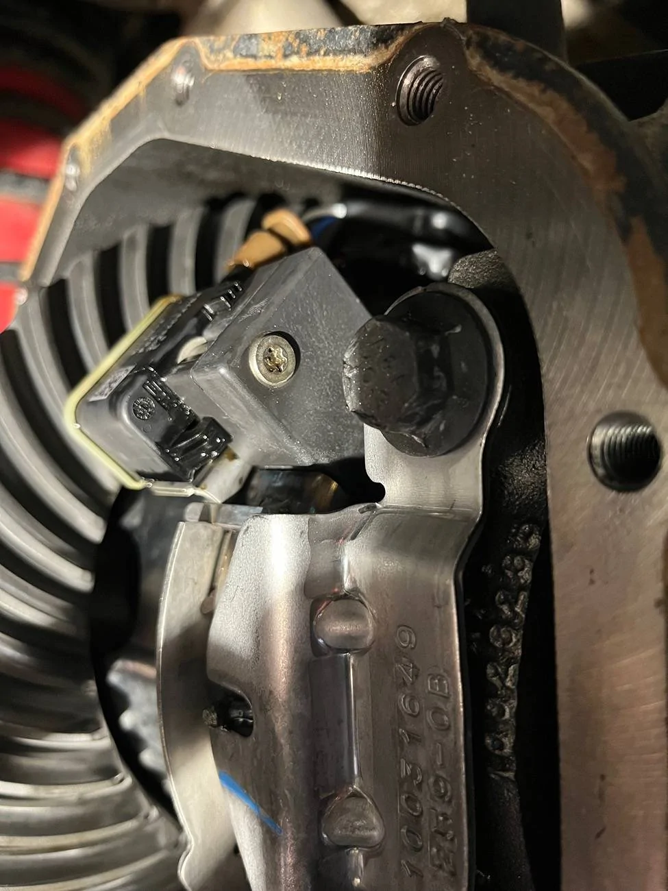

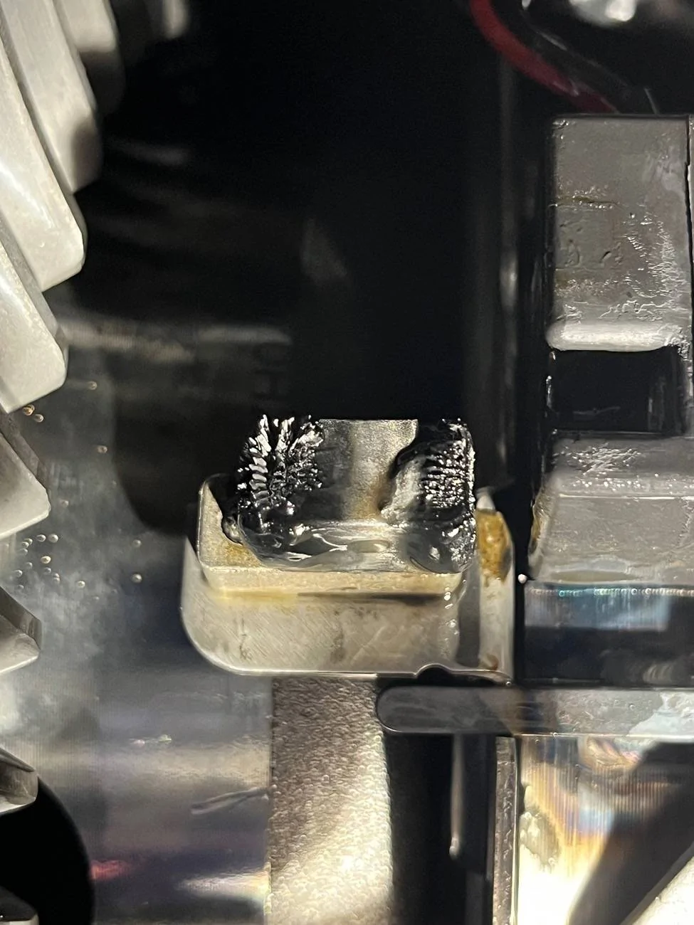

The cover has to come off, then a small torx bit screw holding the sensor in place comes out, pull the sensor off the magnet, clean the magnet and reinstall sensor. It would be a good time to just inspect the gear teeth, spray out the diff with brake clean (avoid spraying connectors), let it dry, reinstall diff cover. Gasket is reusable, fill with your choice of oil.
Jeep Gladiator Potting the Locker Sensor VS Z Automotive Bypass IMG_0298
Jeep Gladiator Potting the Locker Sensor VS Z Automotive Bypass IMG_0301
Jeep Gladiator Potting the Locker Sensor VS Z Automotive Bypass IMG_0296
