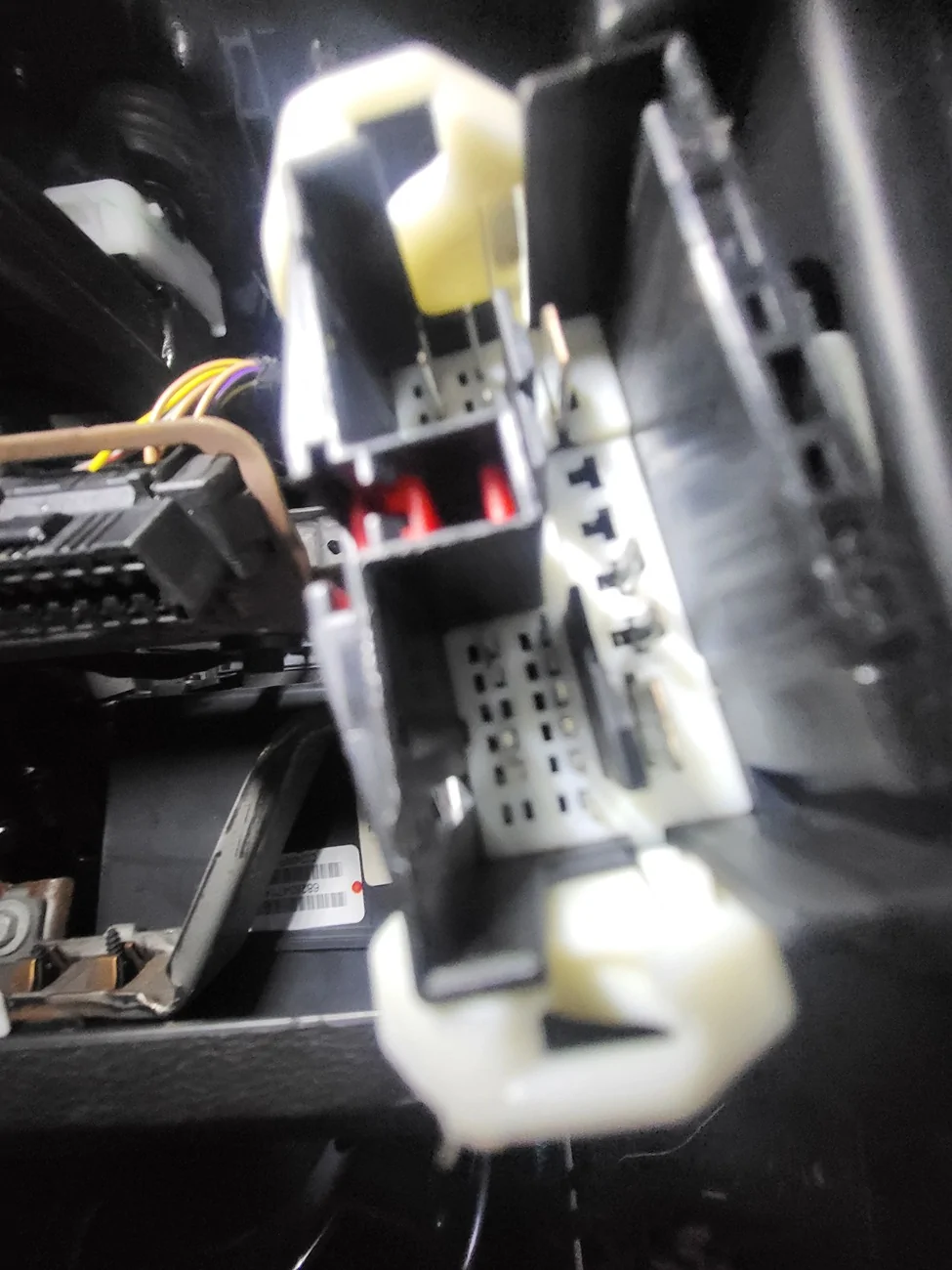

Checked the harness pins, all good. Found out I'm no longer a contortionist, astigmatism and bifocals can't see shit upside down very close up, can't take pictures for shit
Jeep Gladiator Power door locks acting up 20260212_175050
So, I was able to carefully pry the Christmas tree clip behind the harness so I could get eyes and light on it.
Will chase wiring on Sunday

I needed a telescope to check my pins. And I still had to wear my readers! :LOL:
