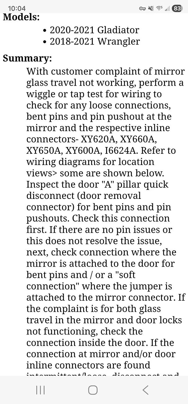

Xy620a is common to both the lock and the mirrors.
Jeep Gladiator No Power Mirrors/Door Locks (Did not take door offs) Screenshot_20251030_100438_Samsung Internet

I've had the same problem on previous Jeeps, it was always a broken or pulled ground wire on the door harness either at the plug, or where the harness bends.
Kind of what the TSB says. He needs to hold the switch in question and shake, wiggle, pull and push that harness. Then fix the problem.

My 2025 had the same symptoms upon purchase, service dept removed drivers door panel and found the plug not fully seated.

I had this problem last year. Being that your doors have never been off, checking the pins is out.
Mine ended up being the wires in the harness on the door were frayed/broken. Peel back the wiring loom/wrap to the first bend in the harness. That's usually where the culprit is.
Hopefully this is the issue. It's a relatively simple fix. Pain in the ass as the interior door panel has to come off but it's pretty straightforward.
