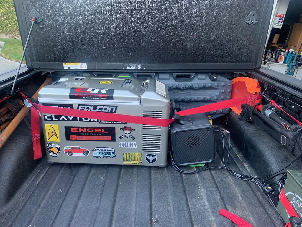

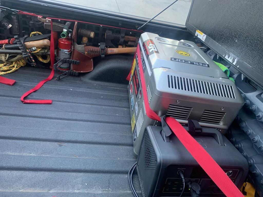

Here's what I did. I put a 3 way On-Off-On switch in the bed of the truck. One ON leg gets power from the main battery. One ON leg gets power from a Bluetti EB70 battery. When I'm driving I select truck power to conserve the Bluetti. When I'm in camp I plug in the Bluetti and select it for power. Best of both worlds. I also followed this same methodology for some of my lighting on the bed rack.
At house temperatures the Bluetti will power a Dometic CFX3 55IM for over 2.5 days.
Are you sure you need a switch ? On the Engel I have, I plug in the Bluetti DC cord into the Engel, and plug in the Engel AC cord into the back of the truck (115 Volt plug). The Bluetti charging cord is always plugged into the truck 115 volt plug along with the Engel (I use an octopus on the plug). The Engel always uses AC first when it is on, so, when the truck is running, it is running the Engel and also charging the Bluetti. When the truck is off, the Engel draws the DC from the Bluetti. The Bluetti never charges and discharges at the same time.
