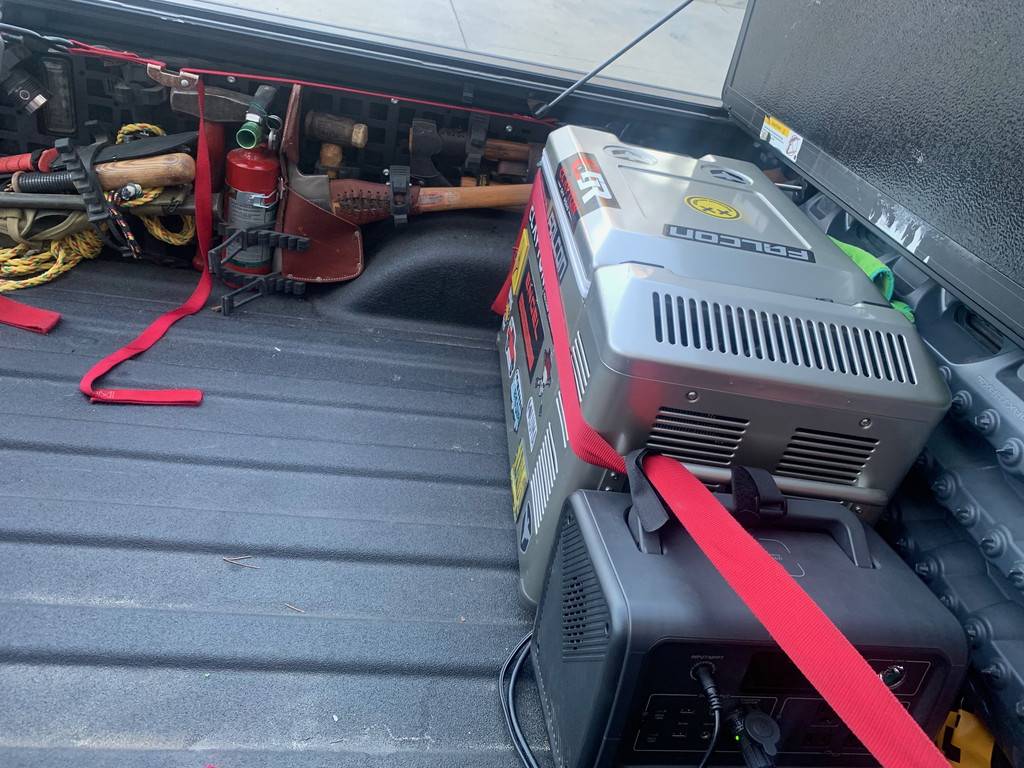

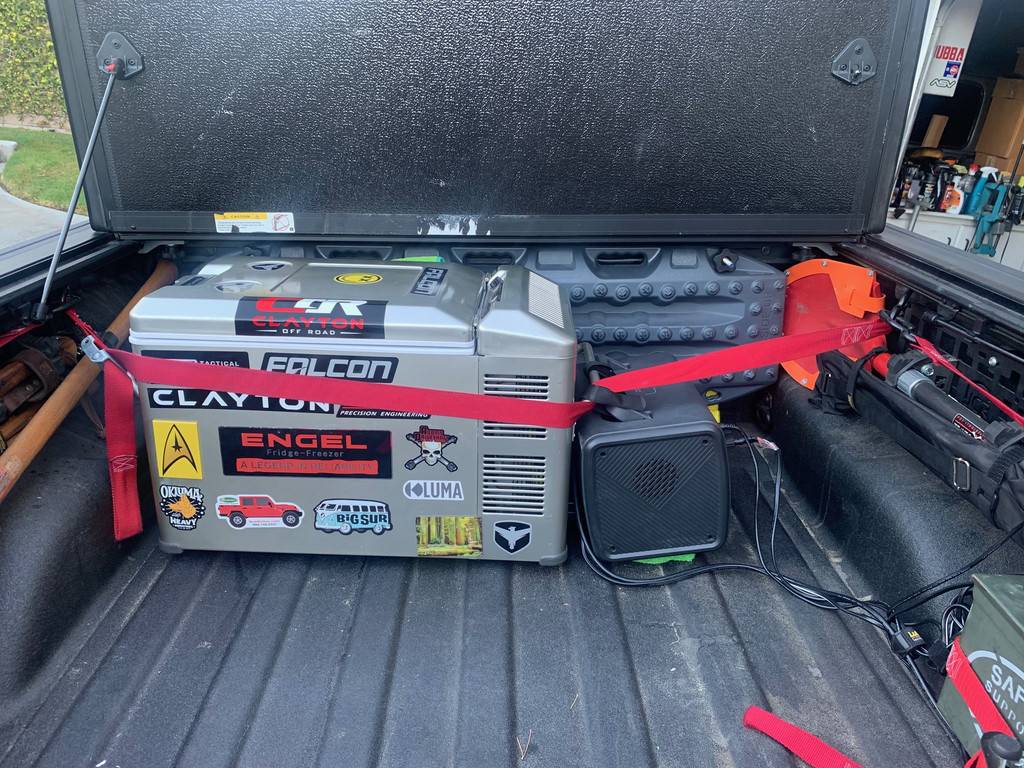

I have an Engel that I keep in my truck bed running 2/7 under a hard tonneau cover for 2 summers now. I keep the truck in the driveway and the summer heat gets to over 100 degrees here, so, the bed is baking. I use a Bluetti LifePO4 to keep it running. Note: LifePO4 batteries are safer in the high heat. The fridge uses much more juice during these super hot summer days, but, it has never switched off. A few times, I have had the LifePO4 battery get too hot and trigger the battery temp sensor. If I remember correctly, it refused to take a charge until the battery cooled down, but, it was still discharging and powering the fridge - TBC. My bed is basically empty, so, there is lots of breathing space in there when it is super, super hot. Here is a pic.
