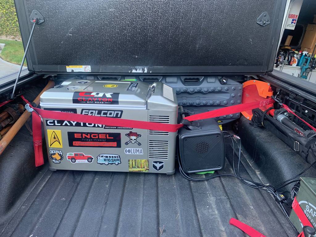

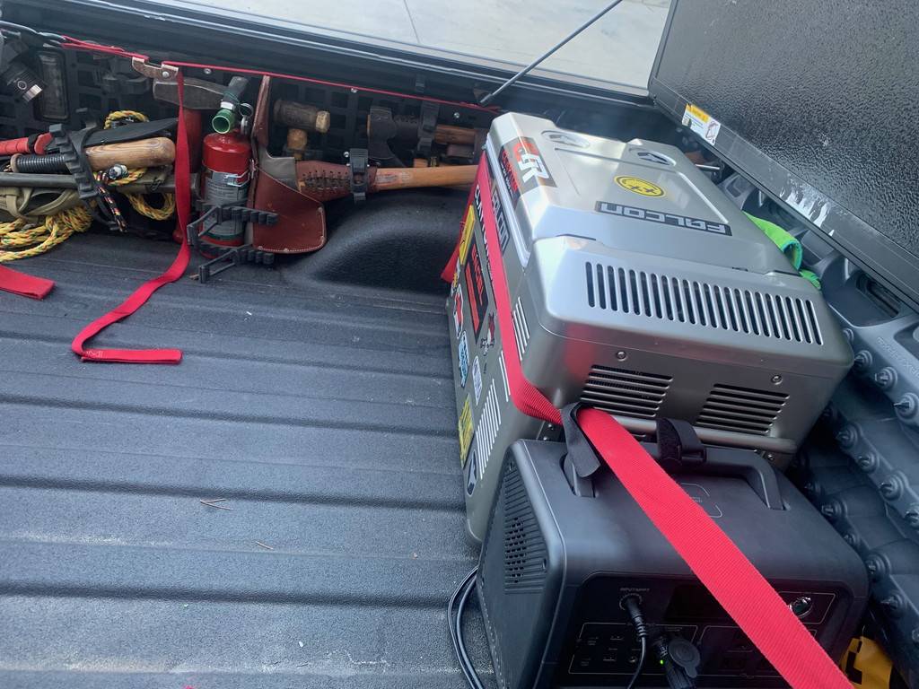

I have the BLUETTI Portable Power Station EB70S, 716Wh LiFePO4 Battery, and I read somewhere that it is inefficient when charging and discharging at the same time, heats up the battery, and is generally not good for it. Although charging and discharging at the same time does work.
The battery takes 200 Watts AC for charging and the fridge burns 35 watts AC when cooling, so, it is 235 watts on the 400 watt inverter in the back of the bed when the truck is running. It is pulling from the truck alternator, so, no big deal about the efficiency. When the truck switches off the AC, then, the fridge automatically swiches to DC and it automatically pulls DC off the battery which is the most efficient.
Note: My fridge will try to pull AC first, and if is not available, it automatically switches to DC. I believe this is the most desired configuration if you want to use the AC bed outlet and an additional LiFePO4 battery.
Note: I have been running this setup now for 1.5 years with no ill effects, with lots of off roading, and badge of honor trails. The battery and fridge seem to be handling it well so far.
Here is a pic of my bed setup for The Rubicon Trail. I was able to close my hard Tonneau cover and 4wheel without worry.
Jeep Gladiator Powering a fridge/freezer hbOHNm
