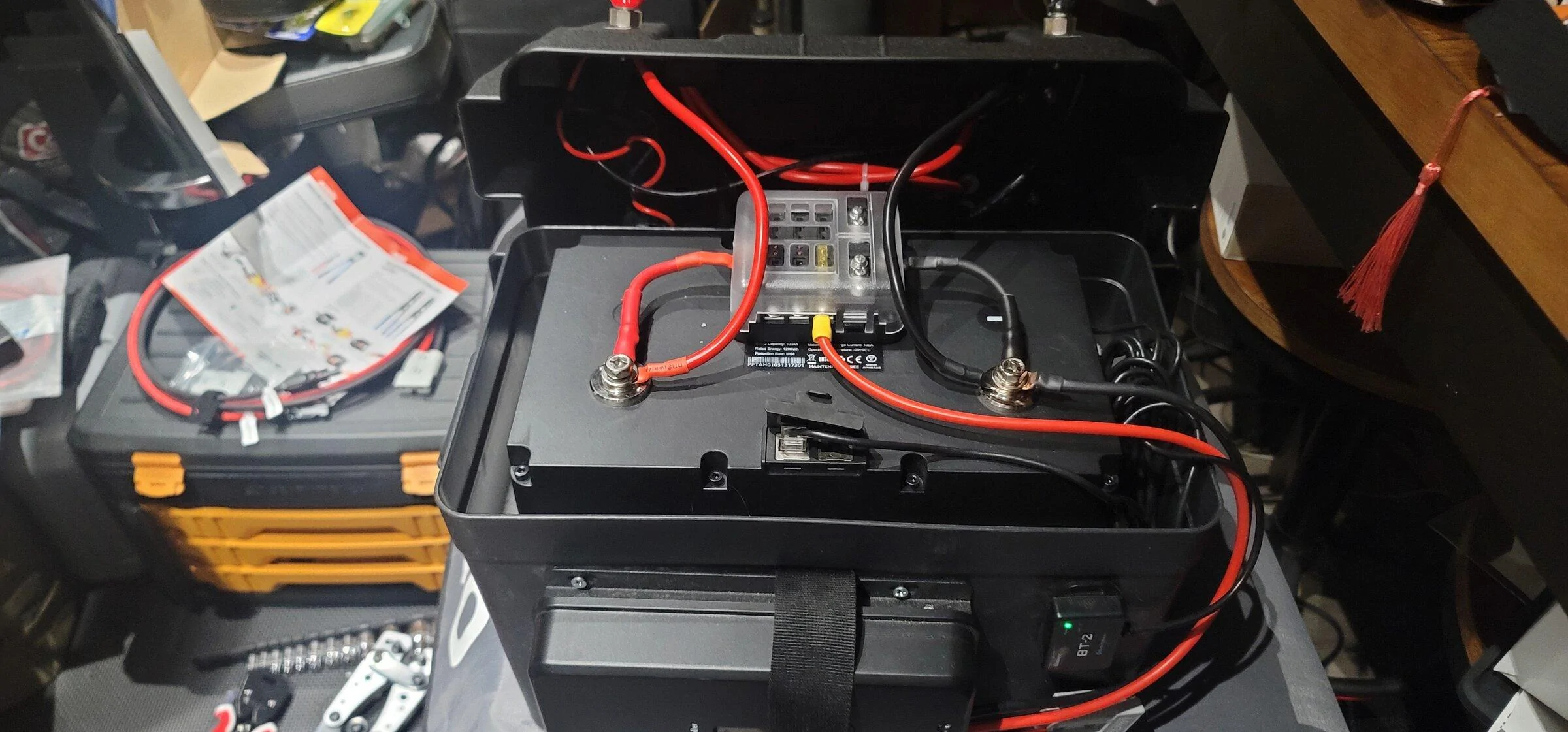

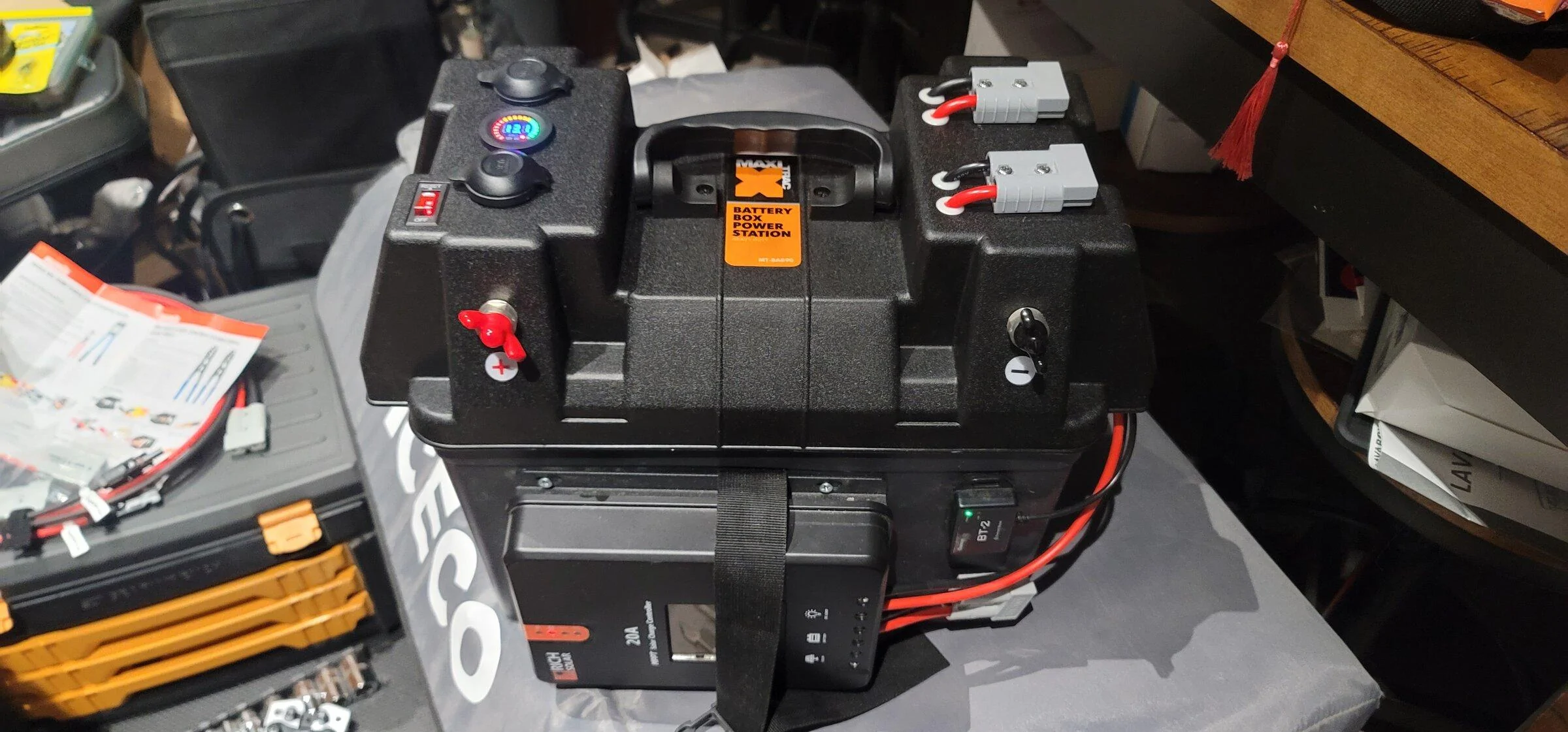

Redarc is nice but expensive. You can also look at victron controllers. They are pretty nice as well. I picked up a victron ac-dc charger for the unit I put together. I'm running an inexpensive rich solar mppt (same unit as renogy rover li). I also added renogy bt2 bluetooth module to monitor the battery (renogy 100ah). I can hook up another renogy in parallel if need be. But I think I have plenty of power between this unit and my bluetti ac50s. I'm still deciding on which inverter to pick up. Not sure if I want a 500w, 1000w or even a 2000w unit. The compromise for me is size and portability since I don't have a hard bed cap yet.
