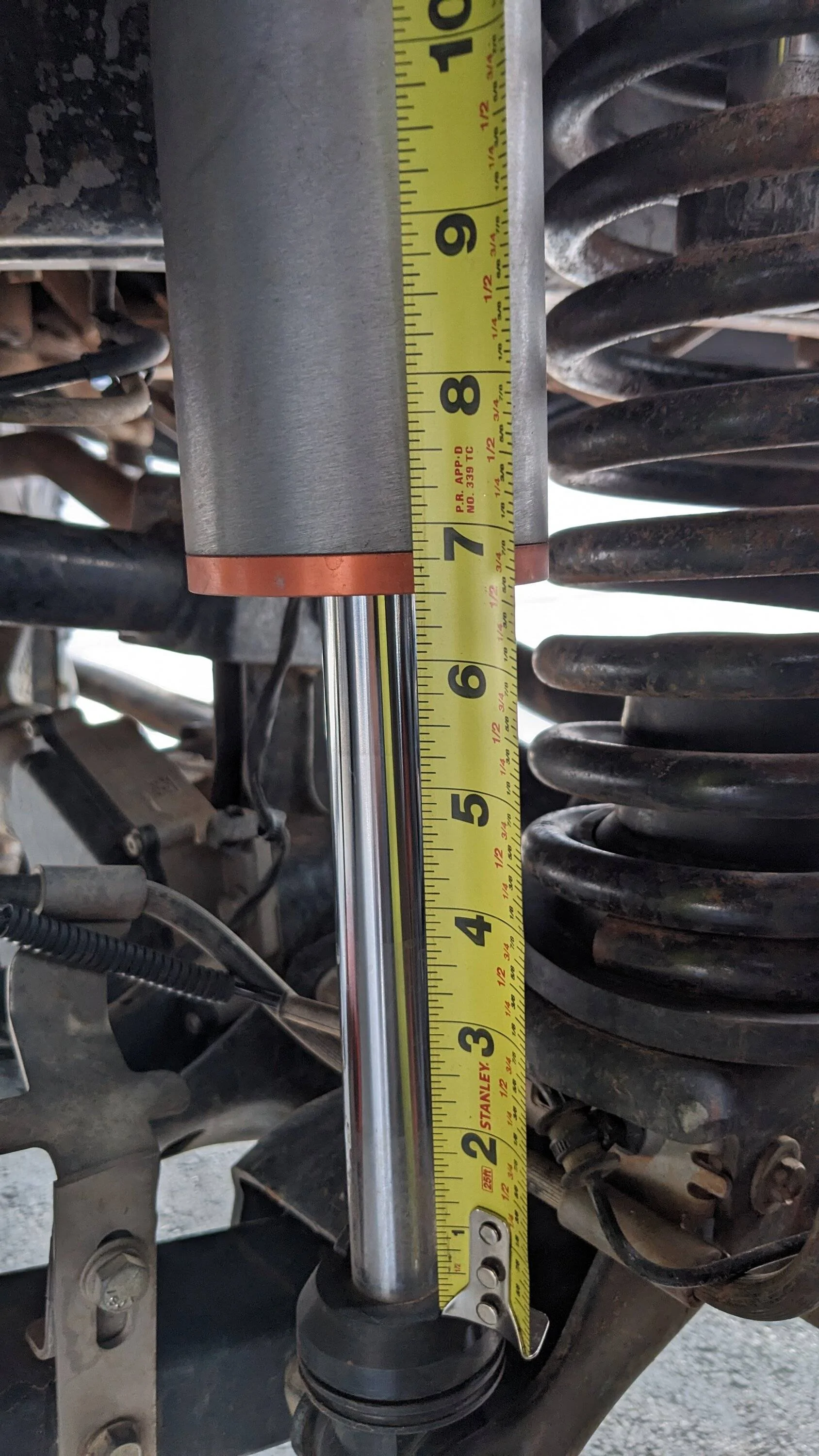

6.5" up in the front, I like the sound of that. I currently have the 2" synergy springs which I'm finding way too soft a spring rate in the front. They are giving my Jounce shocks a workout. That said, I have roughly 3.5-4" up travel currently as I added 2" bumpstop extensions. Switching things around to get a stiffer rate and 6.5" up travel would make a hell of a difference.
I'm toying with the idea of removing the Mojave factory Jounce shocks and custom-installing some Fox ones. It would be nice to be able to remove them for rebuilding without having to take the coils out.
