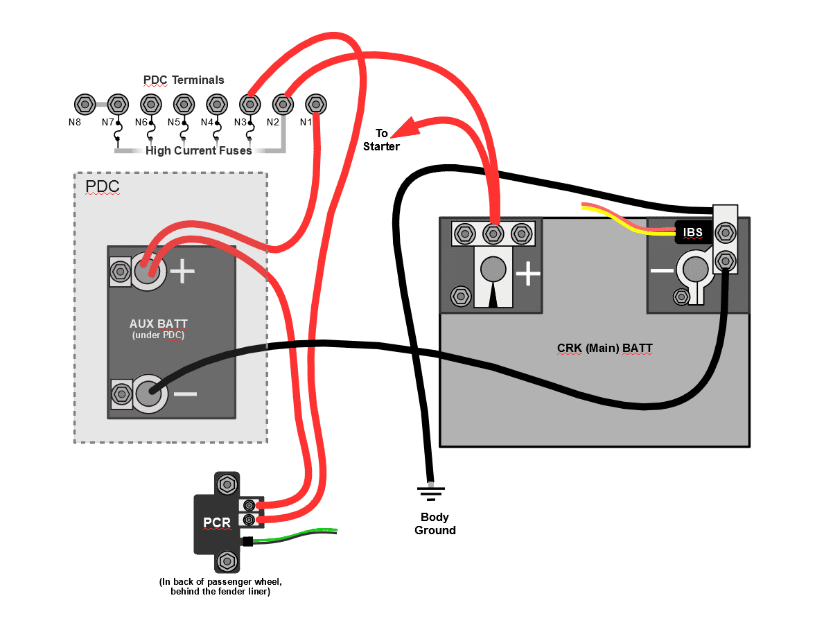

A couple things that may not be at work for your issue, but could be and seem to be common issues.
First, when the PDC is replaced it always seems to be (based on observed posts) due to the ESS/PCR high current fuse getting blown because the main battery positive terminal was shorted to ground when the aux battery was connected to it (the N3 fuse in the diagram). Some techs aren't aware that only the high current fuses need to be replaced and they replace the PDC. I wonder if your techs unknowingly blew the fuse, then detected an issue and blamed it on your winch.
Jeep Gladiator Pro tip: Leaving it in ACC mode for 4 days will kill both batteries underhood jumper plain.PNG
The second thing is that the ground cable connected to the main battery terminal loosens easily. If the nut is not real tight, bumping the cable loosens it further, so make sure it is real tight.
