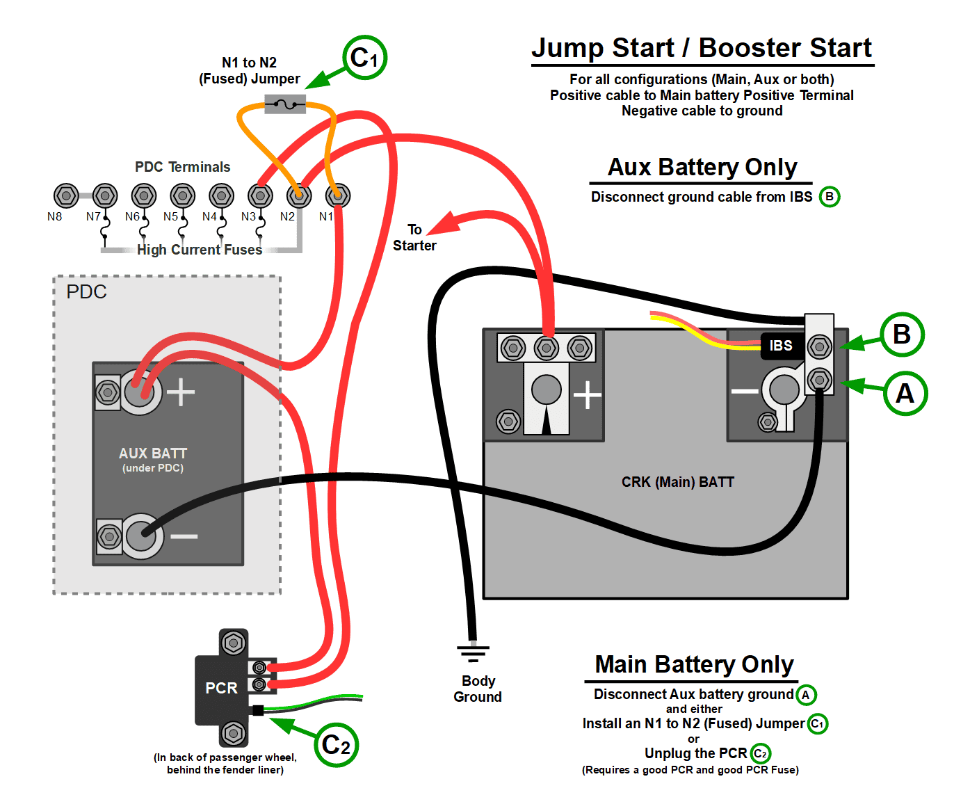

Those diagrams above are gold ... I recall the JL thread and it seemed that the two batteries run in parallel. This increase in Amp Hr exceeds what most quick starters can handle. I believe the owners manual states to allow the jump vehicle to charge the dead batteries for a said period of time. "IF" I understand ... jumpering N1 - N2 ... and disconnecting the aux battery ground isolates the aux battery. Thus requiring the jump pack to only have to "amp up" the starter battery. Every time this comes up the Genesis Dual Battery system looks better and better ....

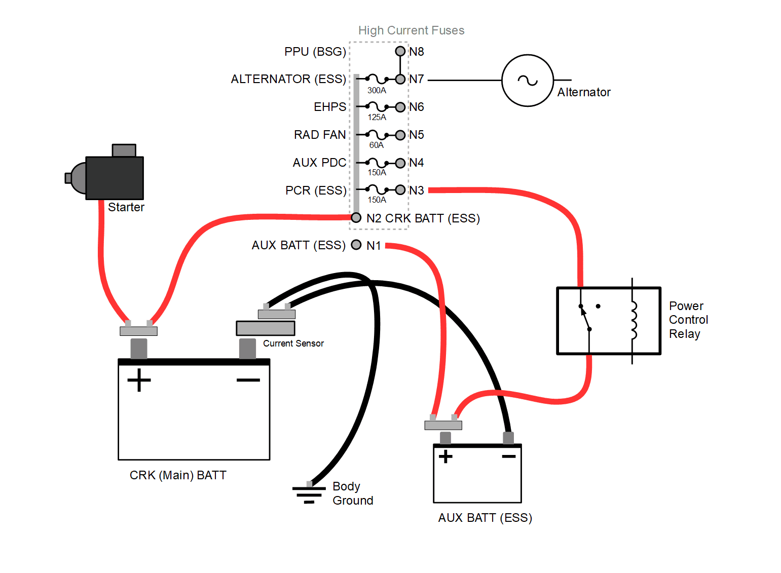

I am not an electrical engineer and I don't fully understand how the batteries interact. But I do remember enough from engineering school to realize that there are multiple states.
My best guess is
1) key off engine off
2) key on, engine off.
3) key on, engine running.
What connections are in place between the batteries in each state?
Does it even change depending on the state.
It would seem that with the proper setup of diodes (essentially electrical check valves) and a relay that can either join or separate the 2 batteries, you could design a system that accomplishes the engineering goal (prevent voltage sag on the main bus when the starter engages) pretty simply.
Also, and I'm speculating, so please correct me if I'm wrong, the real benefit of the Genesis system isn't the 2 large batteries. Its the protections and isolation designed into the setup. Like I described above. I can see a relay in the Genesis system.

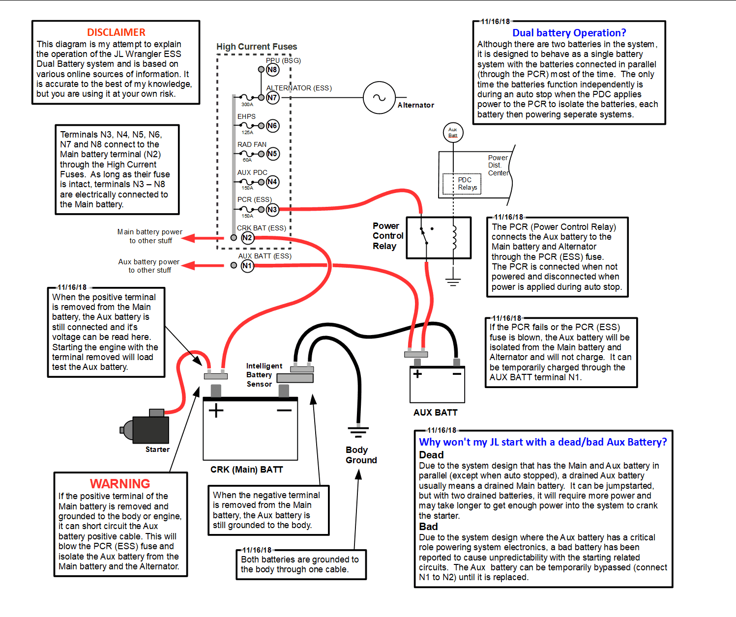

Here is an excellent visual posted by Jerry
https://www.jeepgladiatorforum.com/forum/threads/ess-dual-battery-system-operation.44028/

There was an instructional thread on the JL forum of how to put a jumper wire on two of the PDC terminals when using a booster box. This allows both batteries to receive a charge. I'll find what I have and post it from my phone shortly.
