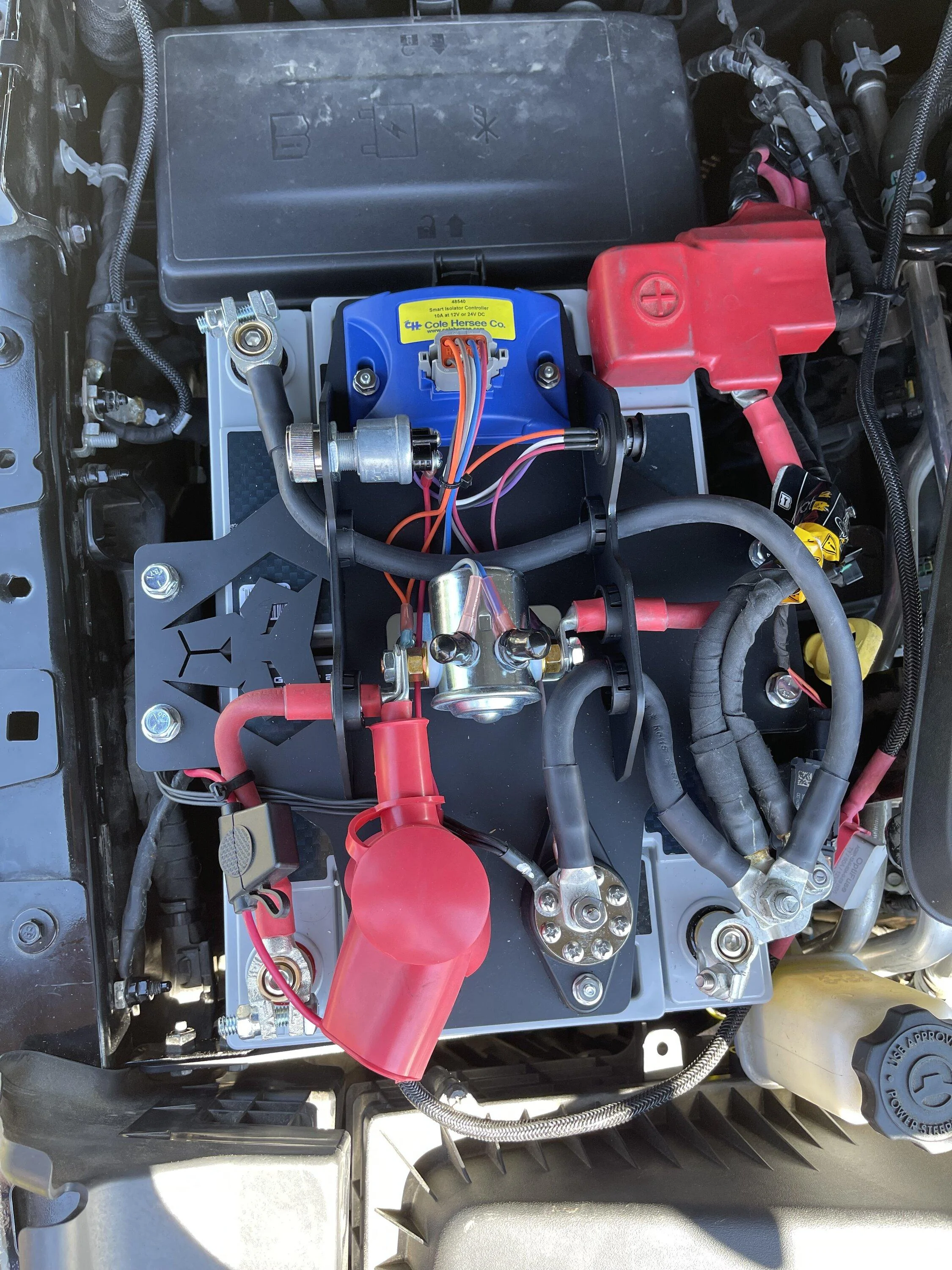

Deleted member 28696
Went out and tried to turn it over and nothing it clicked a few times then started flashing all kind of messages saying the jeep was in drive and some other stuff. It got stuck in the run position on the stop/start button and I had to unhook the battery to get everything to reset. The auto start/stop feature hadn't worked in about 3 or 4 weeks now, I think maybe that battery is dead and that's the issue. Seems like everything else is getting good power except the starting system. 57,000 miles on it and almost 3yrs of ownership and this is my first major issue.
You guys think that's the issue and if so should I let the dealership deal with it or is it pretty easy to replace that second battery. Any guidance would be greatly appreciated. I'm headed back to the house now to try to jump it off and see what happens.
I had issues with these batteries dying and then the vehicle won't start & the batteries no longer will take a charge. Especially when I don't drive a lot with working from home. The second time my batteries died I didn't bother going back to jeep, instead I replaced my batteries with a Genesis Dual Battery system and thus far the problem seems to be solved.
The stock location for the start / stop battery is buried under the fuse box near the wheel well & is a pain to replace. With the Genesis it replaces those batteries with two full sized group 25 AGM batteries which you purchase separately and are fully accessible. I ordered the full throttle AGM batteries with the system from Genesis. It has an isolator that won't let your crank battery get drained down too far that it can't start the vehicle. It will automatically switch over to the accessory battery if the cranking voltage gets too low. You can also use the secondary battery to jump the main battery. It's a project to install but nothing too difficult & can be done in an afternoon if you're motivated. I did mine over a weekend.
Looks good but I had the big replaced and all is good now. The system seems nice but I'll just stick to what's stock. I feel like a lot of these battery issues are misdiagnosed from the feedback I've been getting and things I've been reading. As with a lot of vehicles, if they sit for awhile they won't start because of a dead battery. Although I feel like the big battery should of lasted longer than it though.
