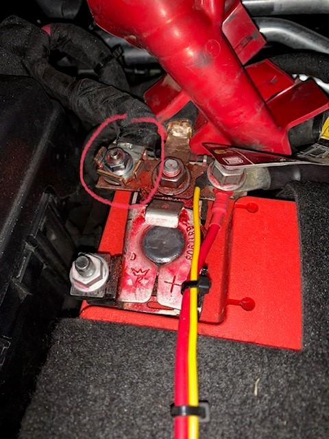

That sounds pretty easy. No other tricks you had to do?
Nope ... the positive from the AUX redirects up to the main positive. It essentially runs the wires same as the Genesis dual battery system, but with only our single battery main. It is a bit tight but will reach the main. I almost ran a jumper down into the AUX compartment, but ended up making it fit. I have been running this way for about 6 months now. There are a few in the JL group that have been doing this for a while. The system works completely normal other than if you cycle the ESS system six times it will activate a fault. The fault clears and the system resets at the next start cycle. Why there is a six cycle count makes no sense to me?, but I rarely cycle the system 6x.
There is a weird and almost toxic relationship between the AUX and main battery ... they are simply ran in parallel, but there must be something within the management system that eventually kills the AUX and then can take out your main. the inability in these scenarios to jump the vehicle off the main is a failure on Jeeps part and why I opted to chuck the AUX. There are many threads on this that you can read at nauseam. I spend way too much time off grid to have to worry about a no start situation caused by the AUX system.
If you are putting heavy loads on the battery system I would suggest a hard look at the Genesis Dual Battery Kit. Also be very vigilant when conducting any type of rewiring ... check and double check your work.

Here is an image of my AUX lead to the main battery .... the lead does stack onto another lead that needs to be flipped over as it is tabbed. I added additional shrink wrap and cloth tape to insulate.
Jeep Gladiator Jeep wouldn't start this Morning JTAUXDelete
