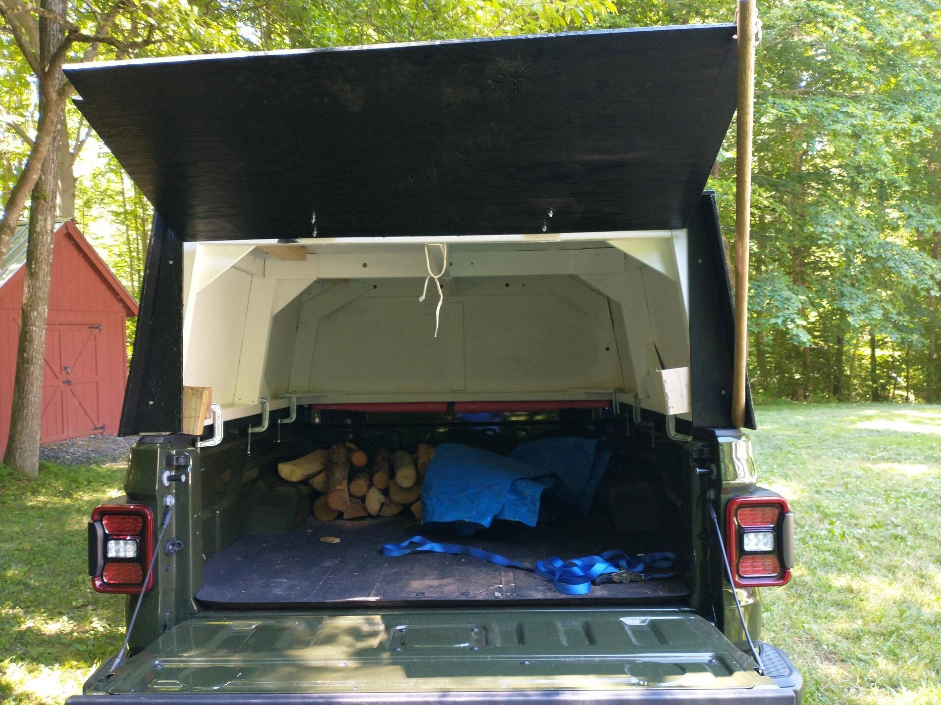

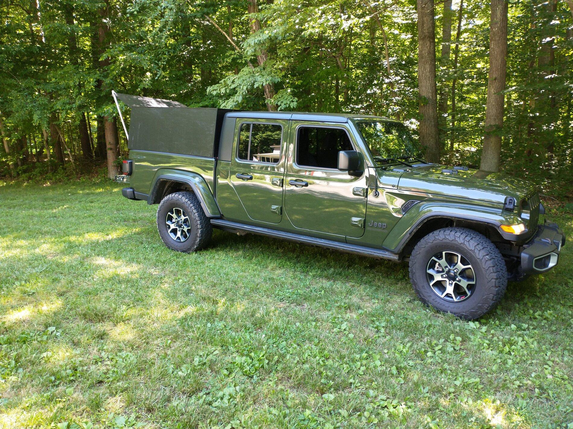

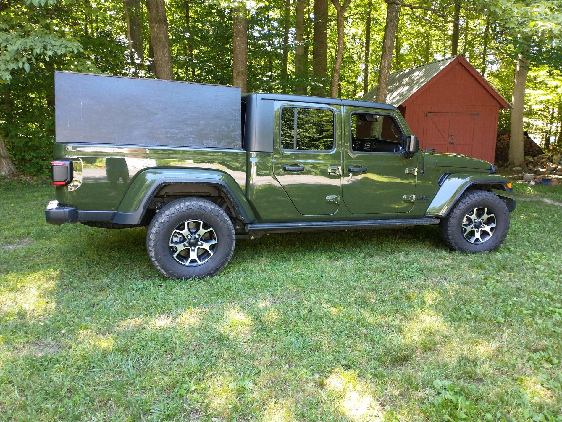

As much as I love the RSI, Leer and ARE toppers, the reality is that I only really need a topper maybe 4-6 times per year. I also prefer the look of the gladiator without a top, so I just couldn't justify the cost of one of the toppers. Therefore, I decided to build one out of plywood. I used recycled material (including some crooked 2x4s) and all-in I was under $200....with most of that being the three sheets of plywood I had to buy at these crazy high prices. While I do woodworkign as a hobby, this was absolutely a "quick and dirty" build with a focus on function and strength over getting every seam perfect. I am sure this is not everyone's cup of tea, but we used it on it's first family camping trip and it worked perfectly.

Love the DIY stuff, making it work exactly for your needs rather than spending big bucks for a package of concessions and compromise. Well done, sir.

Looks like you could make some side and rafter storage the way you have it built to keep smaller things out of the way.

Yep, that was part of the practical concept as well. I can screw in little hooks/loops, drill holes, add brackets, add shelves, add nets, etc anywhere I want in a matter of seconds and without any concern of permanently altering an aluminum or fiberglass structure. I built it strong enough to be able to bolt or screw on anything I may want to add in the future.
