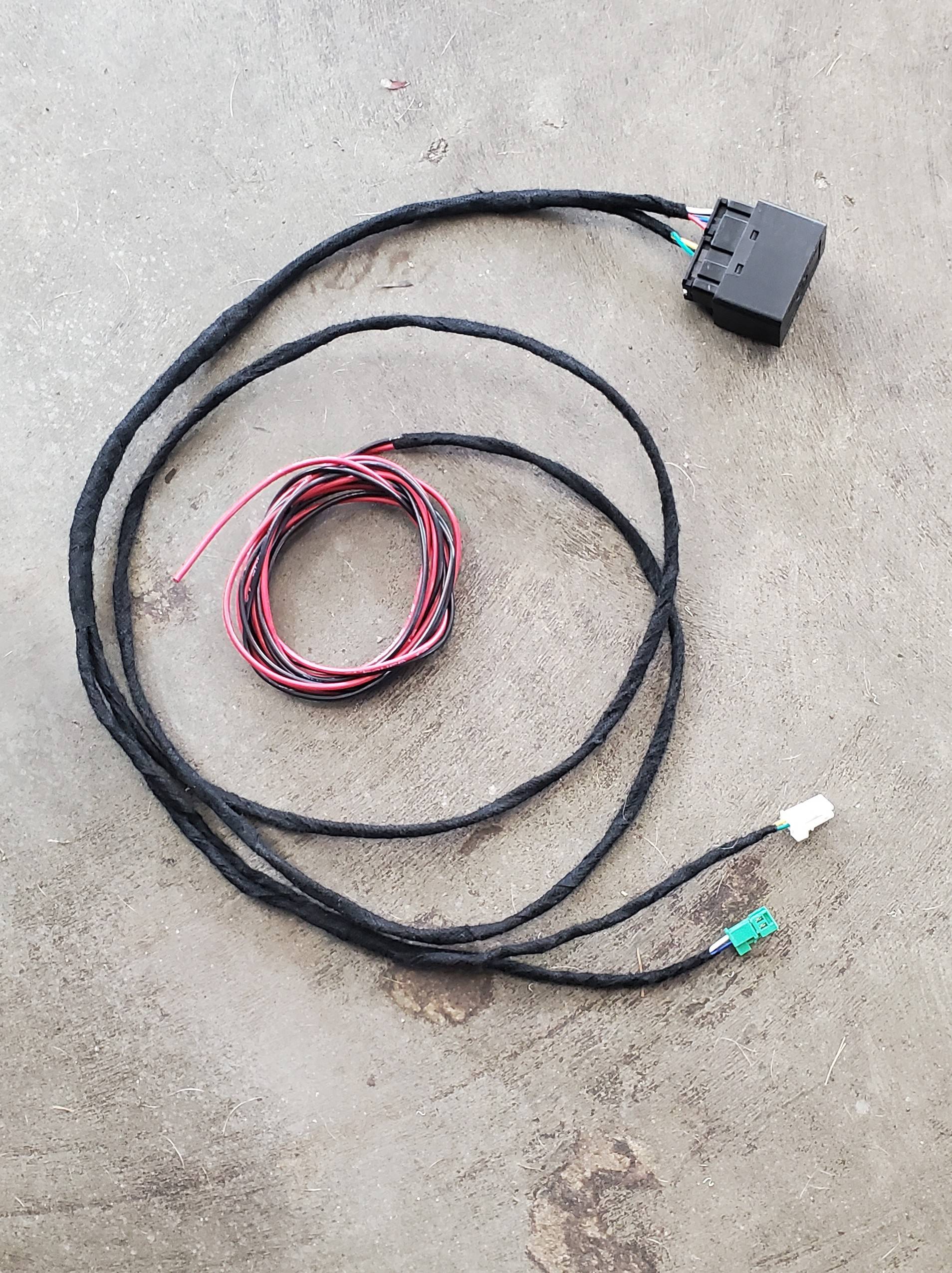

I made the first one of these Tazer Mini Relocation harnesses for my 2020 Gladiator Sport (unfortunately I totaled that truck), I made the second one for my 2020 Gladiator Mojave and the third one for my Wife’s JLU. The first one was made in October 2023, and there was a thread I started with some of this information, but this is a dedicated thread for it.

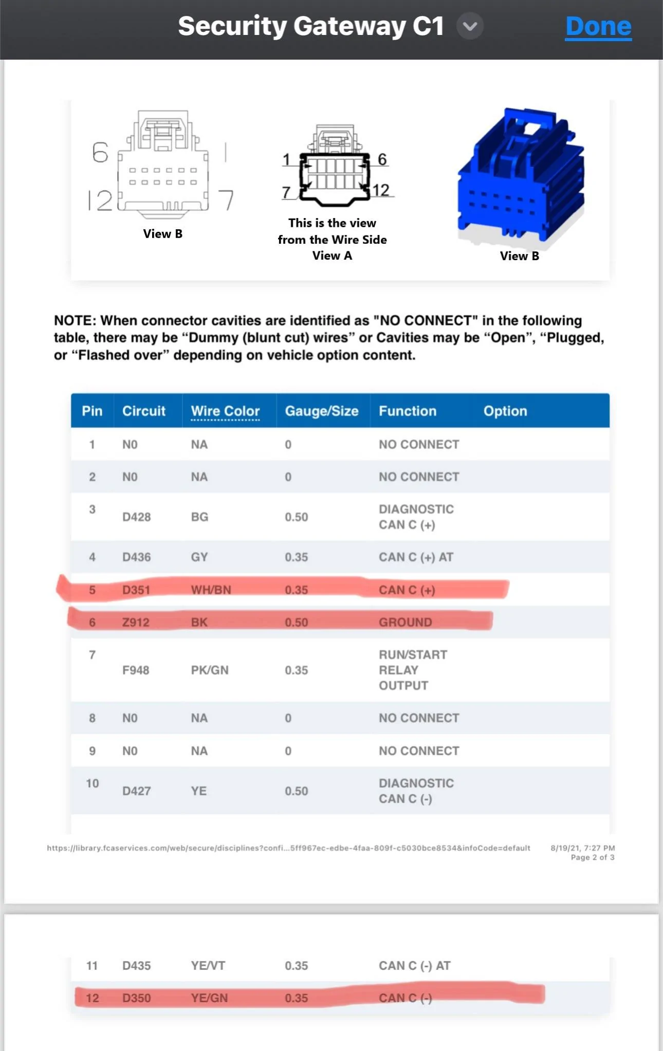

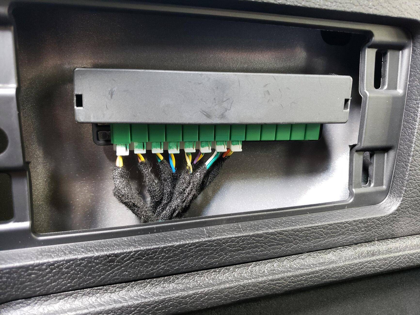

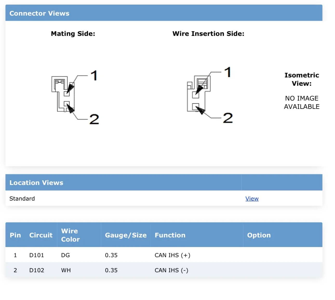

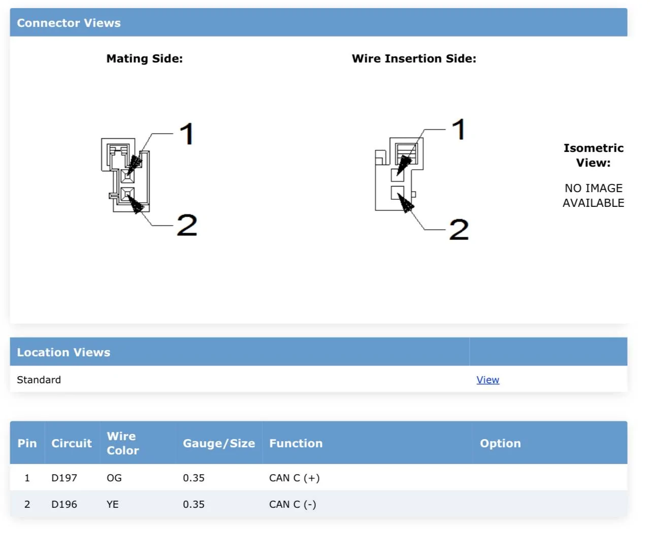

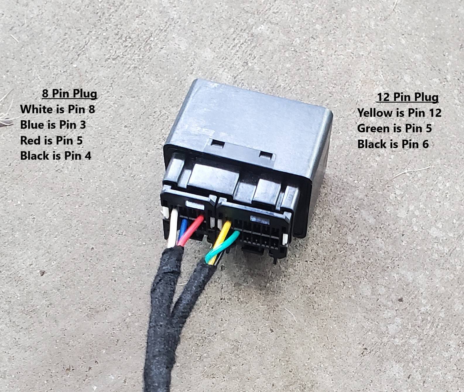

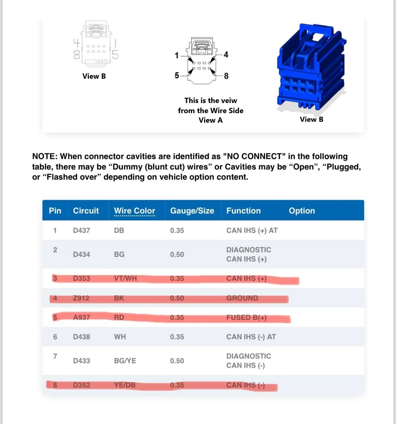

I have included pictures of the pinouts for the SGW plugs if you are making a harness like mine. On my harness I pulled out all the wires from the SGW extension cable and rearranged them to use the colors I wanted. If you buy the Z-Automotive SGW extension harness just make sure you hook the wires for the power and ground & CAN Bus to the right pins on the harness. Building this harness is not terribly hard at all. Find a good 12+ and ground and wire it up, hide it and you are good to go.
