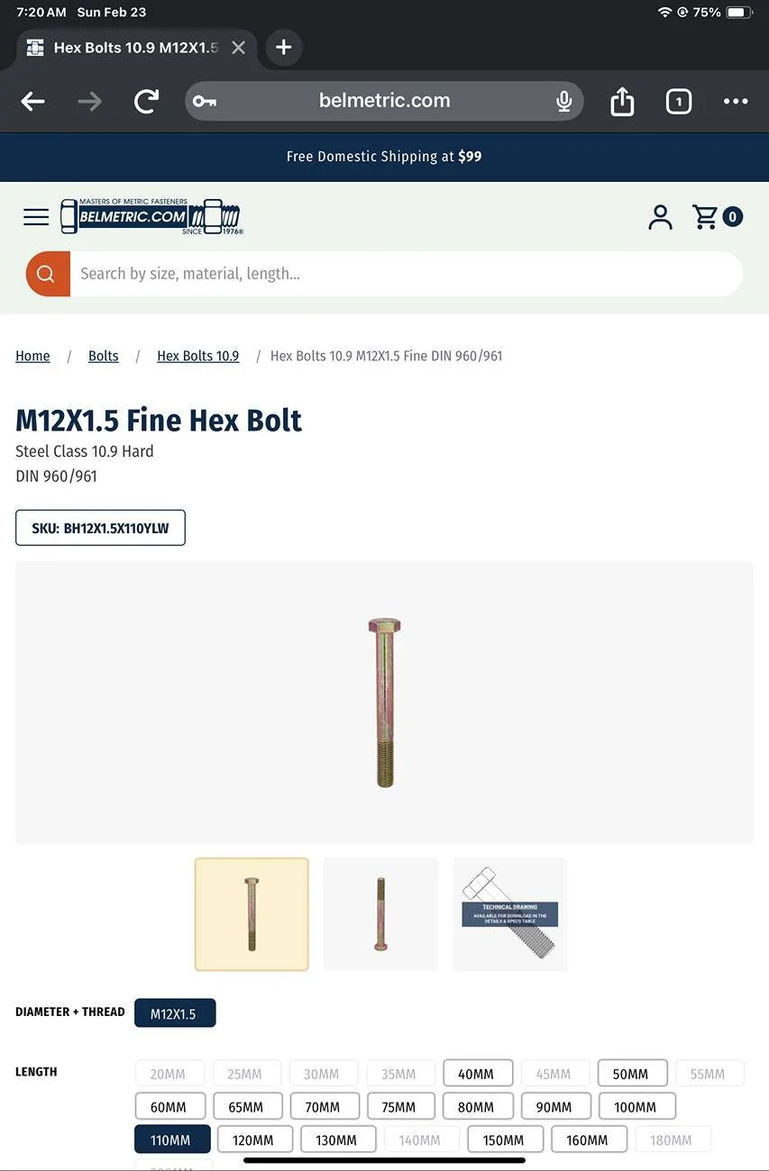

Do you happen to have the synergy track bar/box brace? If so, I can tell you the exact bolts you need for the new box.

Gotcha so you just used the stock steering box nut then? What new bolts would I need? Maybe they are the same for the synergy and the steer smarts.
I appreciate all your help with this
You’ll be fine with using your current box bolts. I got these because they are stronger than factory bolts that are threaded almost the whole length of the bolts.
