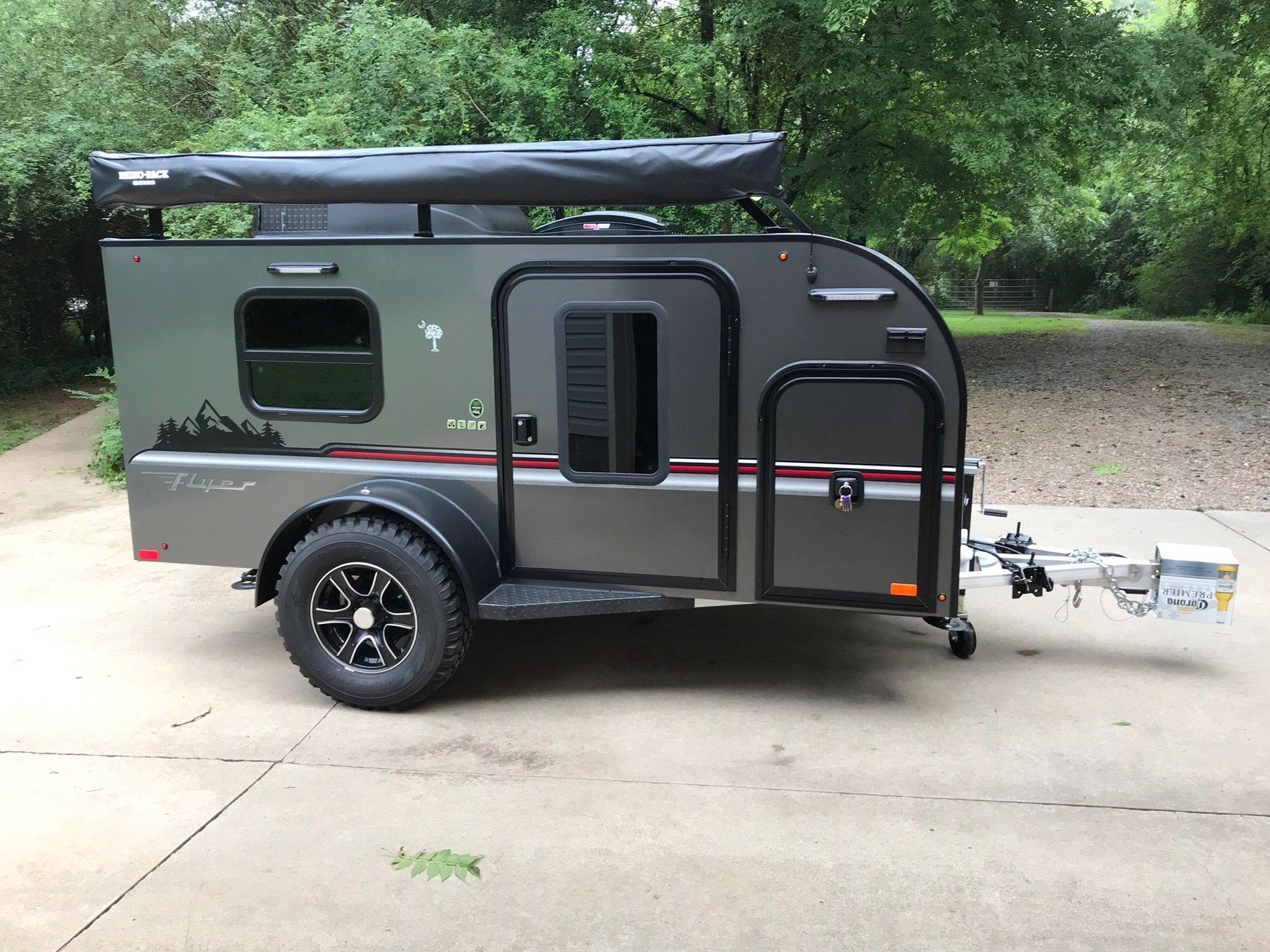

Jeep Gladiator Pulling a Camper 06487550-6EA6-4B4A-98A9-5684BFA30A98
I’ll be pulling my Intech Pursue behind my Gladiator.
