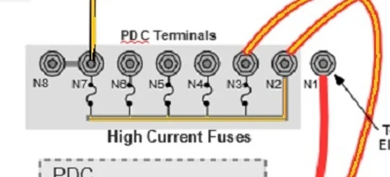

What you should do before anything else is get a volt meter - even a $15 meter at Walmart or Menards, and with your truck off, open the hood and check the voltage at the main/crank battery terminals.
Also check the voltage at the high current fuse N3 and even terminal N1
Jeep Gladiator Question regarding ESC light and Steering wheel position sensor 1754529850200-ho
Start there rather than assuming. Could be correct - but, nothing like "proving it" before spending time and money.
