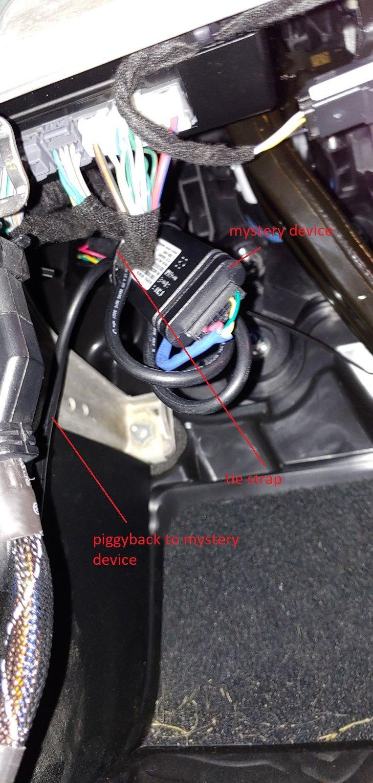

Looks like most dealers are doing this sort of thing on almost everything they sell - and not telling us (referring to my thread about the "mystery device" that nearly fell out from under my dash - turned out being a GPS tracking device - dealer installed)

There is a tracking device that the dealer installed in mine. It is a GPS device that communicates over the cellular network. It is zip tied to the wire bundle above the OBD port. I don't remember them telling me about it. There was a sheet in the paperwork bundle telling me how to setup an account to access the device. Not only does it track location, it can be setup to alert if it exceeds preset speeds, or moves outside a defined area on the map.

That's basically how mine was installed - but there was not a mention anywhere in any papers. I got the factory drawstring bag with the factory documents and then three sheets of paper - purchase contract, a sheet defining the terms used in the contract, and an odometer disclosure statement - that's ALL. It was the most simple purchase ever as far as lack of papers.

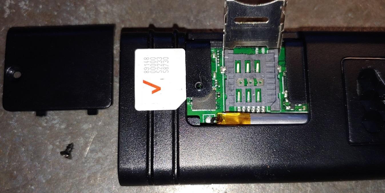

Here's mine opened up and the car out just because I like to dig into things.........

That's not an inexpensive unit! We use AT&T for our fleet tracking, the hardware is $150 and for the heavies with ETL that goes to $350. The dealer is pretty lazy to leave units like that in sold vehicles.
I was wondering about the cost - the thing is that my vehicle was ordered October 17th, it was delivered to the dealer at about 8am on November 15th and I picked it up that evening.
So it was a pre-sold special order truck - and it still got this thing installed.
Wow, 150 a pop?

Yeah we were running 3 year leases with TeleTrac units with $300 hardware+installation at $35/mo back in 2014 when I got involved. Dropped to $20/mo after the lease payments were done, what a ripoff.
Went through several different competitors, got TeleTrac down to free hardware if we self-installed and $20/mo for 3 yr contracts, now pulling off-lease gear and using AT&T's FleetComplete for $16/mo and free hardware. Maybe they're getting a deal from Verizon? But still that's under contract hardware, then!

Can it be removed easily?
Yup. Mine just plugged into the OBD II port - I unplugged the cable and put the original OBD connector back in the bracket, cut the strap that held the device and foot or so of extra cable under the dash and pulled it down. (I cut the strap carefully so I could use it again for something else - I have not bought plastic tie straps in 20 years)
