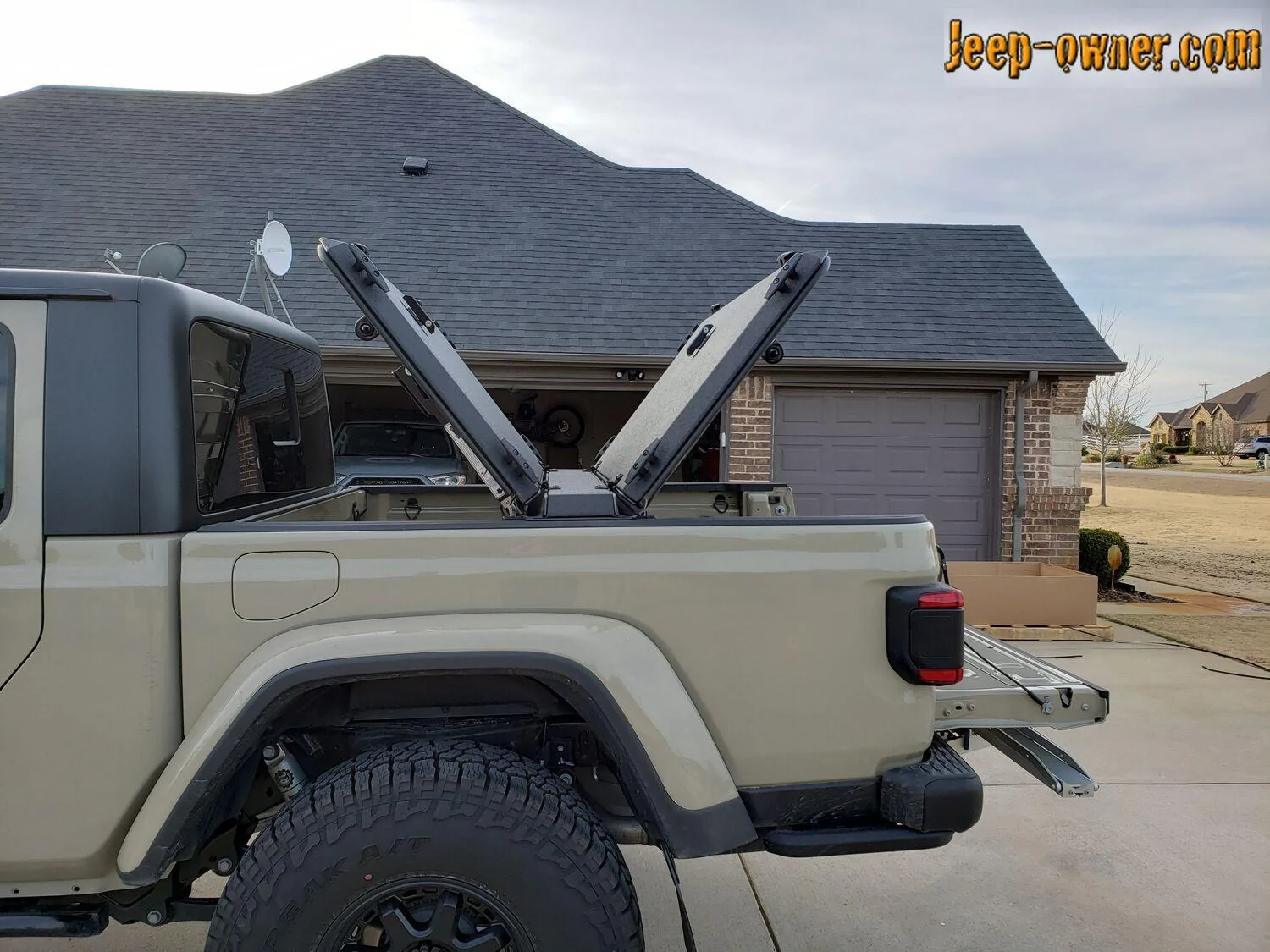

I have the HD. The gas springs easily disconnect and allow you to flip the panels all the way over.
I have done that to fit things like garbage cans, etc to fit in the bed.

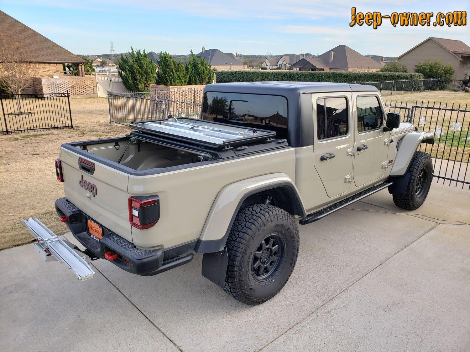

You could possibly fit the chairs under the cover, and put the table on top of it.
You can fold the tailgate side all the way back, the struts have a tool-less quick disconnect. Then you could even slide it off if you wanted to, but you would still have the center support bar. The bar is held on with 4 bolts, so it's pretty easy to remove, and you can mark it with some sharpie so you know where to put it back, if you can't see the indentions.

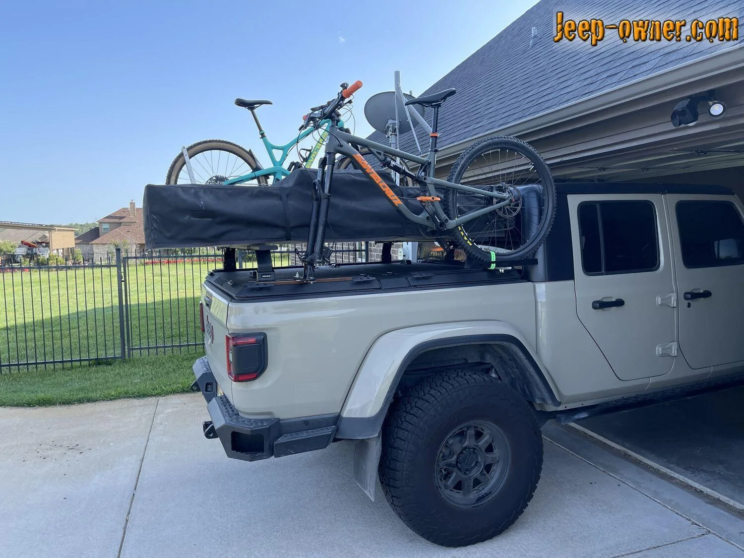

I have the Front Runner cross bars and use it for a RTT or bikes most of the time.
