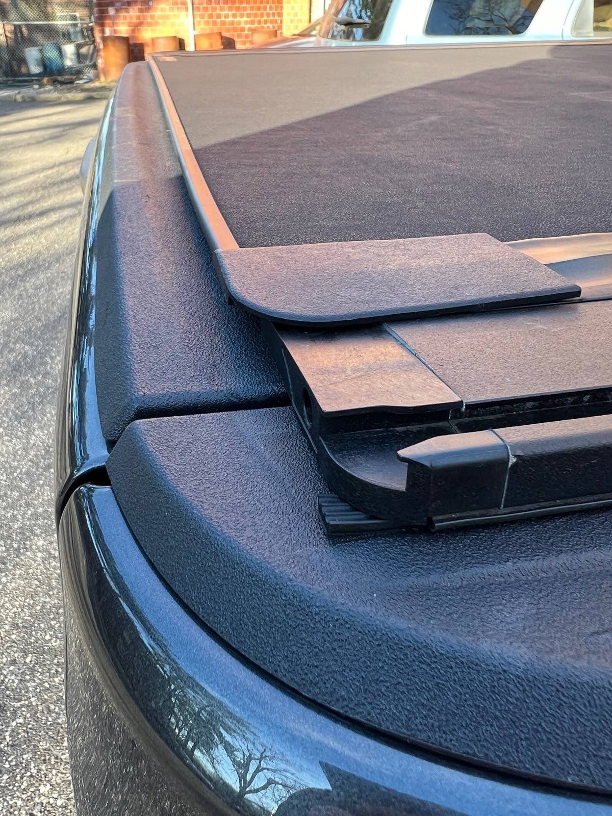

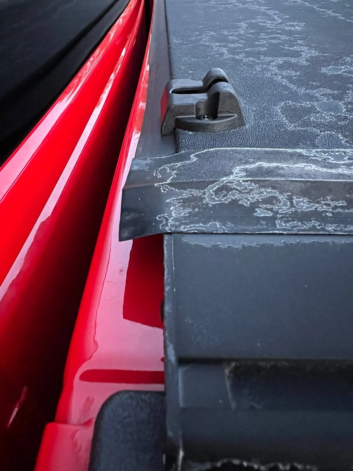

Jeep Gladiator Questions for BAK Revolver X4S owners IMG_6134
This is what mine looks like, slight overhang

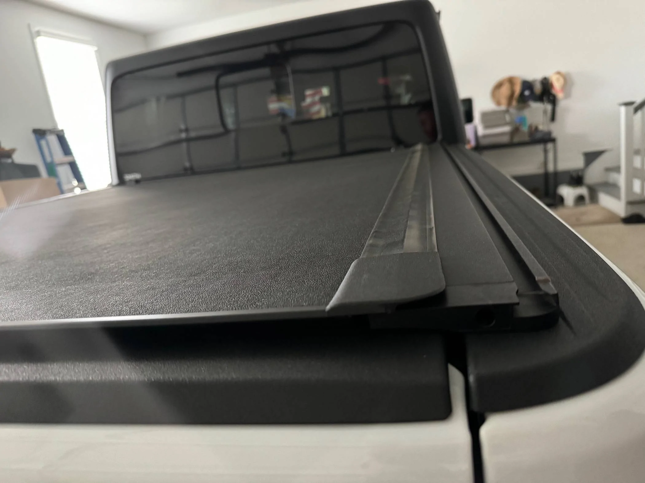

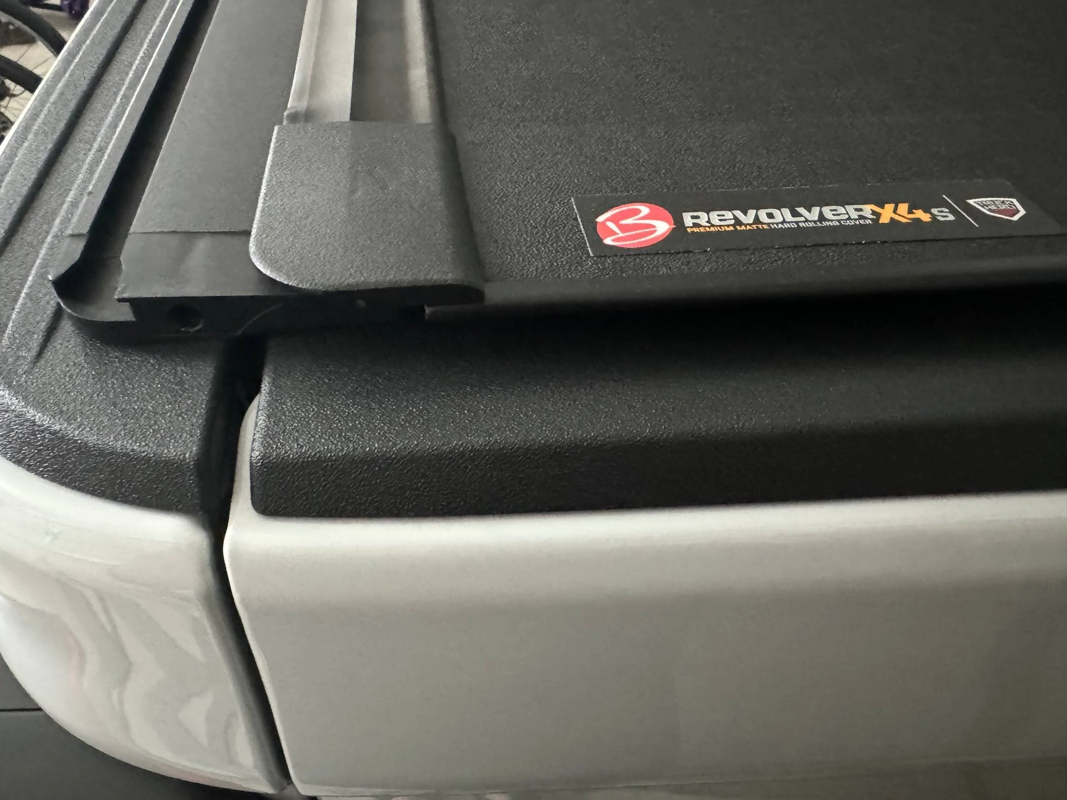

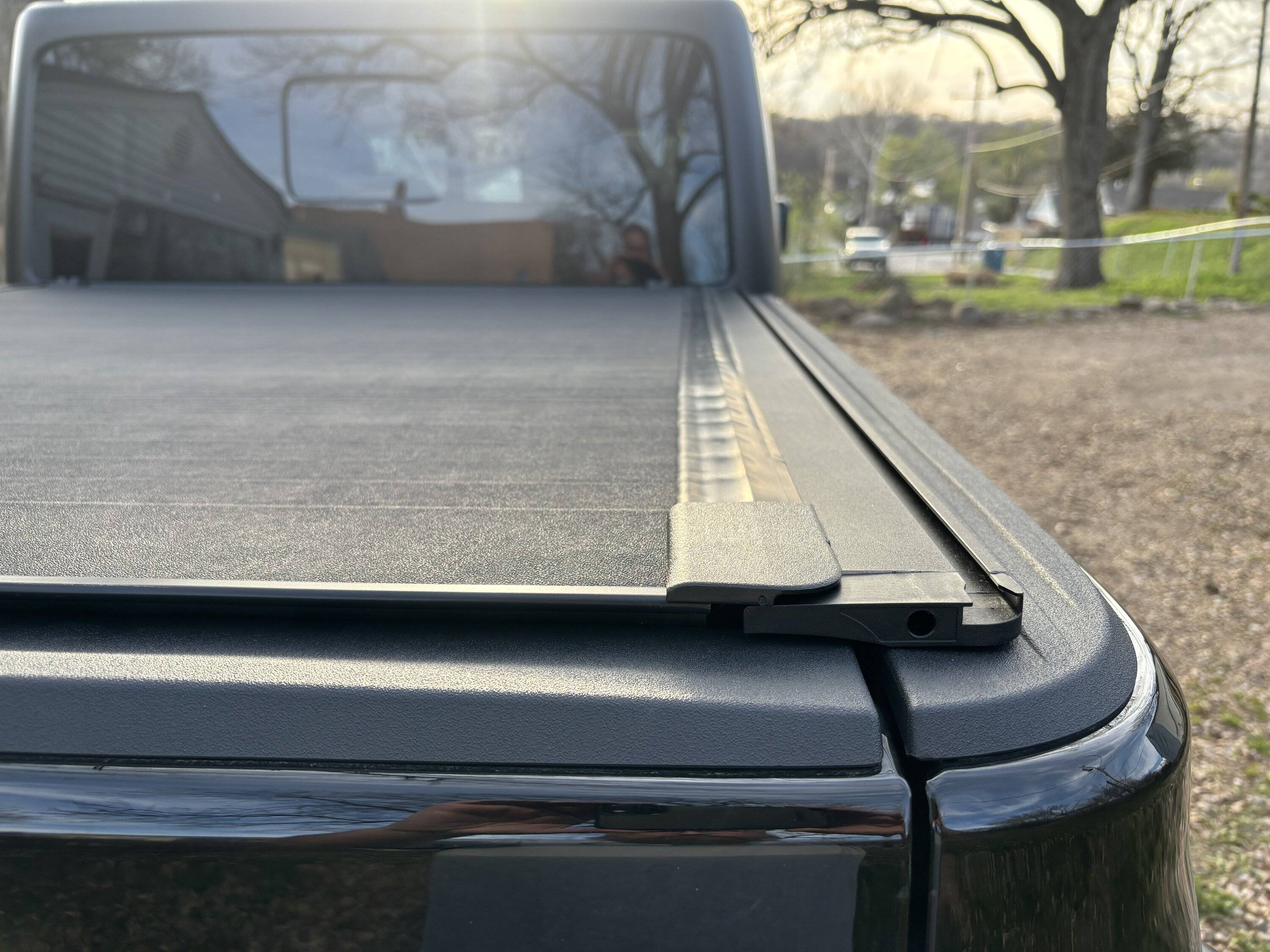

This is mine, front & back:
Jeep Gladiator Questions for BAK Revolver X4S owners IMG_4702
Jeep Gladiator Questions for BAK Revolver X4S owners IMG_4701
I didn’t think the instructions were great, but if I remember right, they have you line up the front side (cab side) to get proper placement. There was also an extra roll of foam that was not addressed in the instructions.
Ultimately, I checked the seal by turning on the bed light at night and looking for leakage.
Or mine is wrong, which is possible.

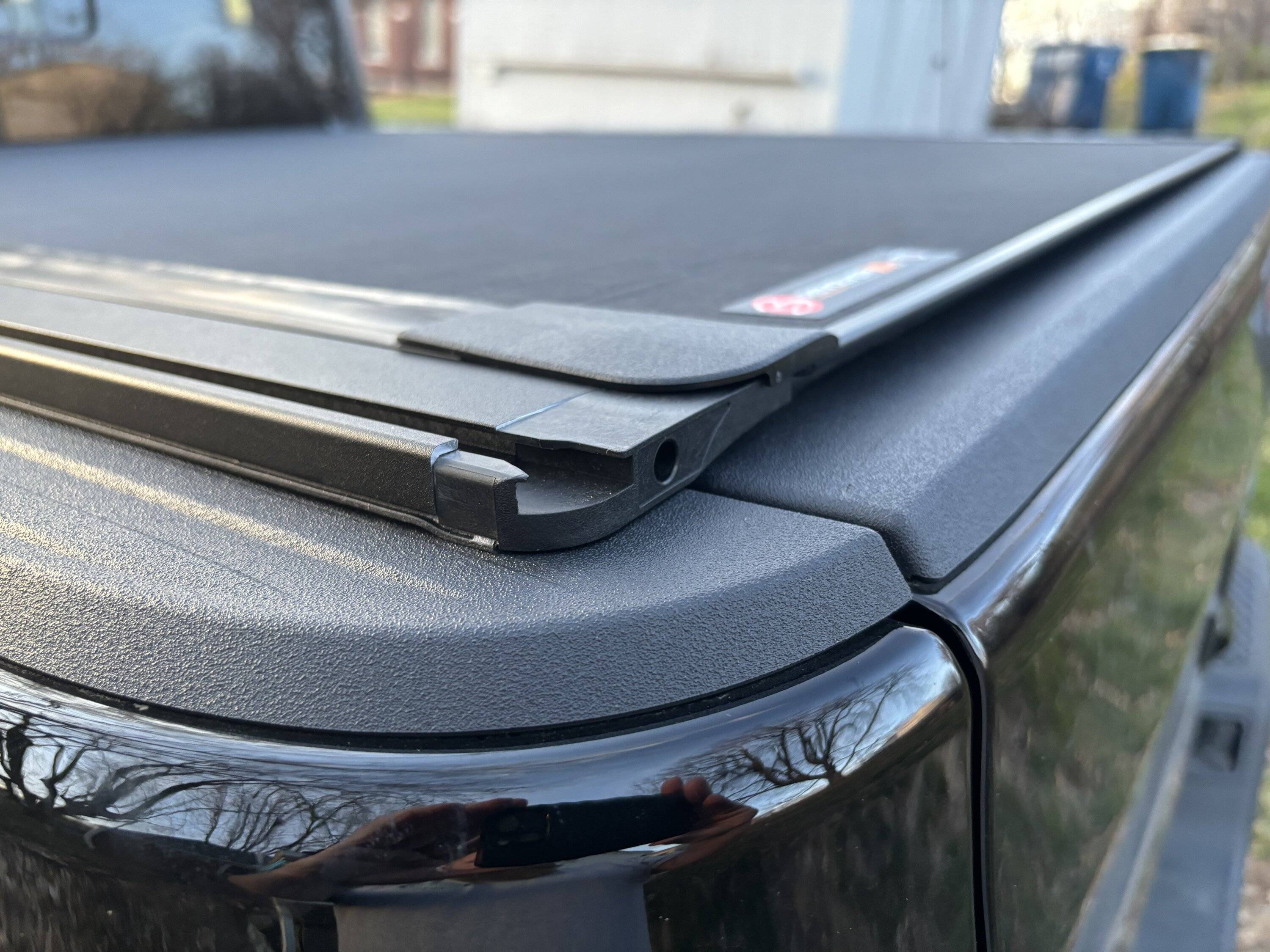

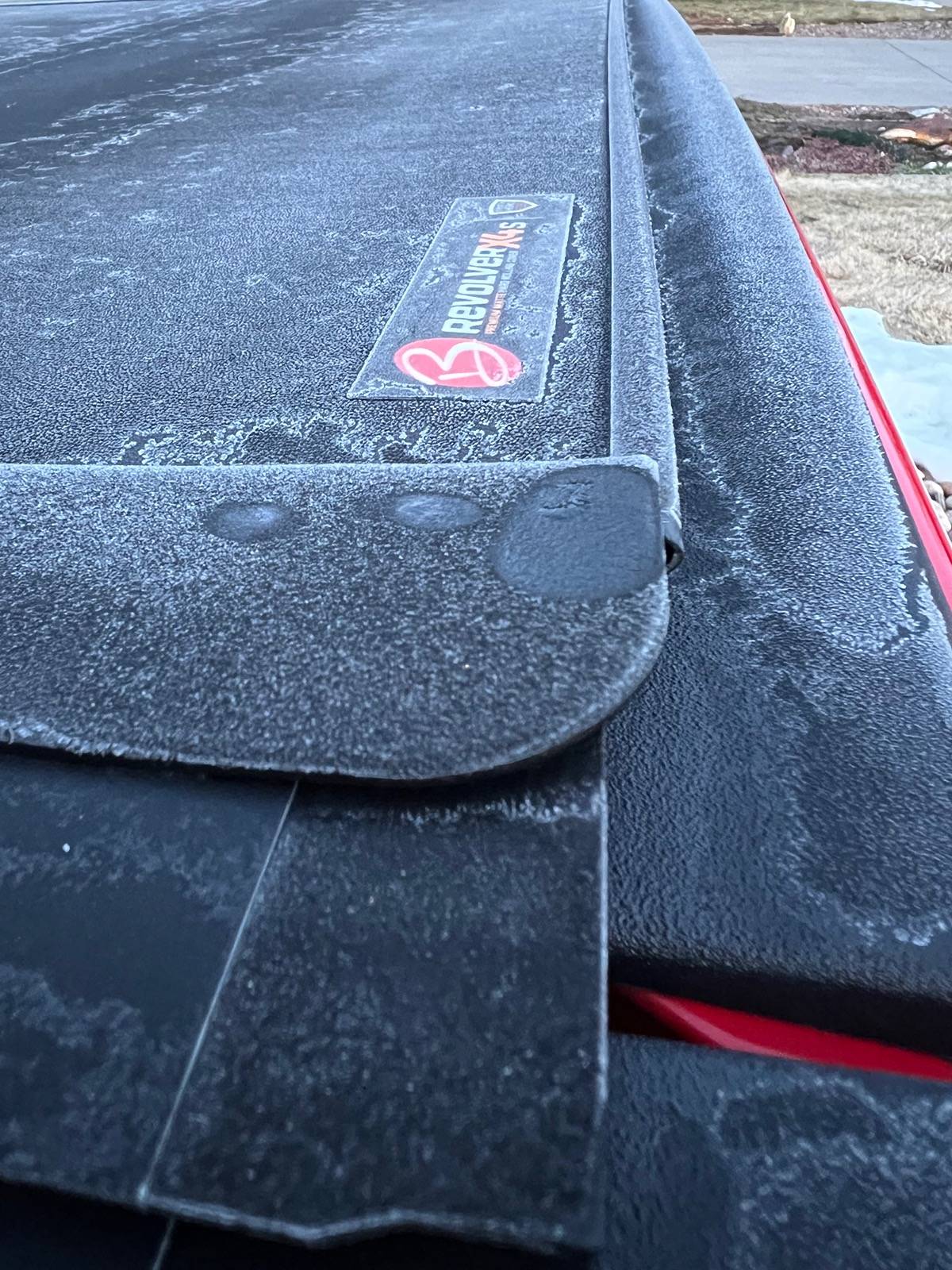

These two parts should line up at the front, but of course you can adjust it to your liking if the seal in the back isn’t right.
When it’s new, the rear seal needs time to settle in. Mine seals pretty good and doesn’t stick up like @kcmudbug
Jeep Gladiator Questions for BAK Revolver X4S owners IMG_8139

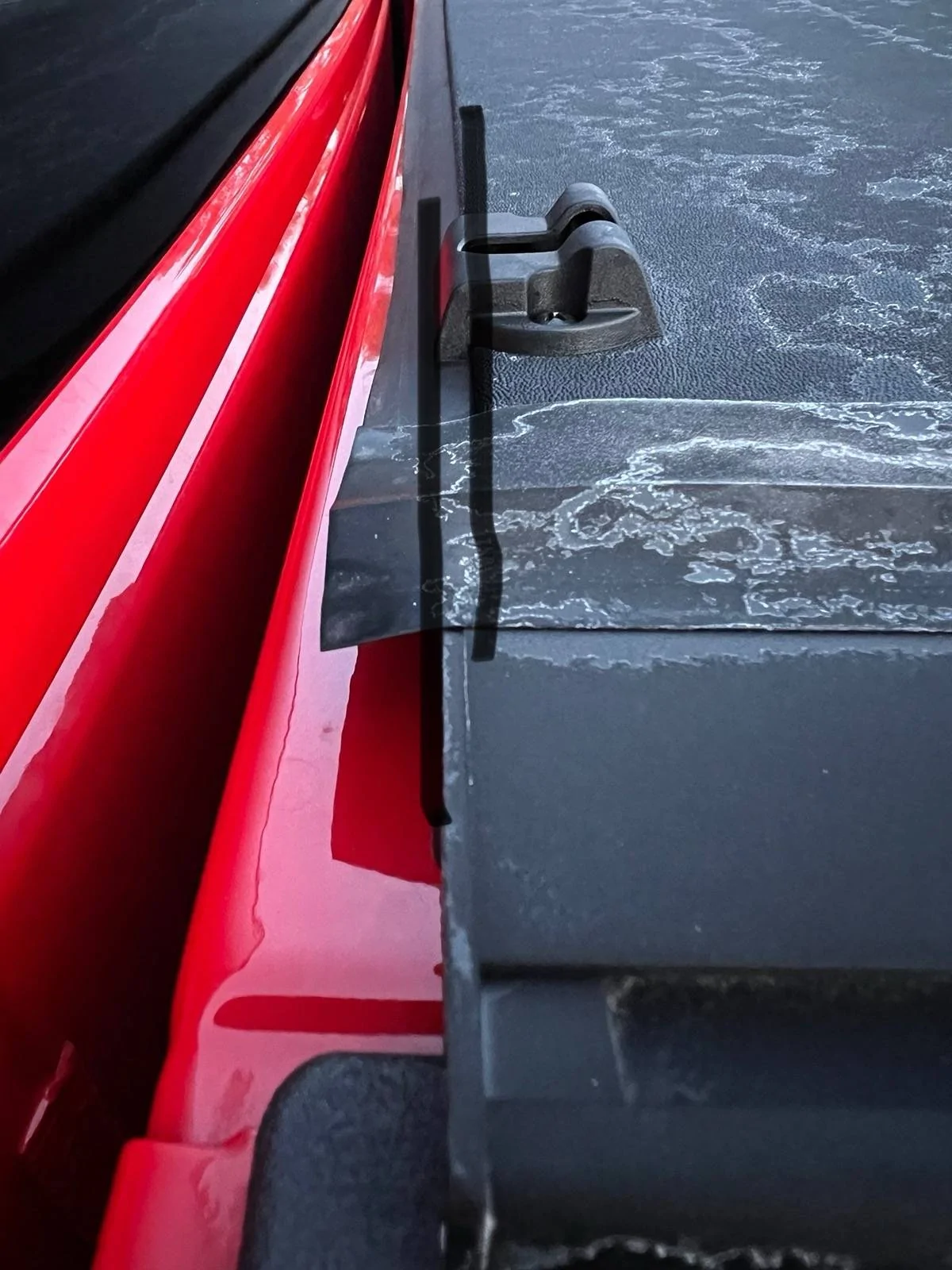

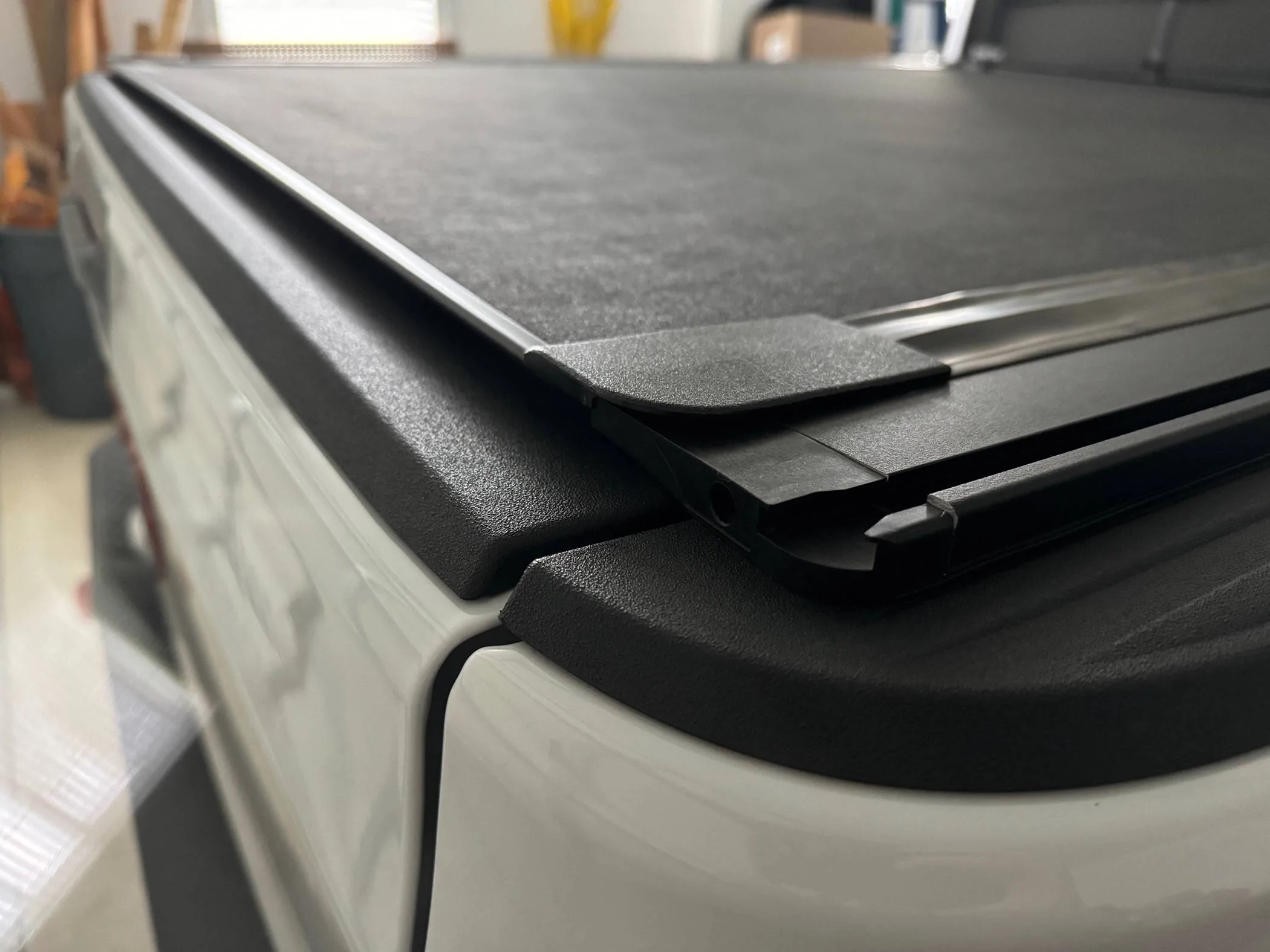

Here’s mine. I trimmed the rear plastic piece so it sits flat. I’m guessing if I really tried I could lift the back and get it open but this top is more of a deterrent than secure anyway.
Jeep Gladiator Questions for BAK Revolver X4S owners IMG_8144
Jeep Gladiator Questions for BAK Revolver X4S owners IMG_8143
Jeep Gladiator Questions for BAK Revolver X4S owners IMG_8142

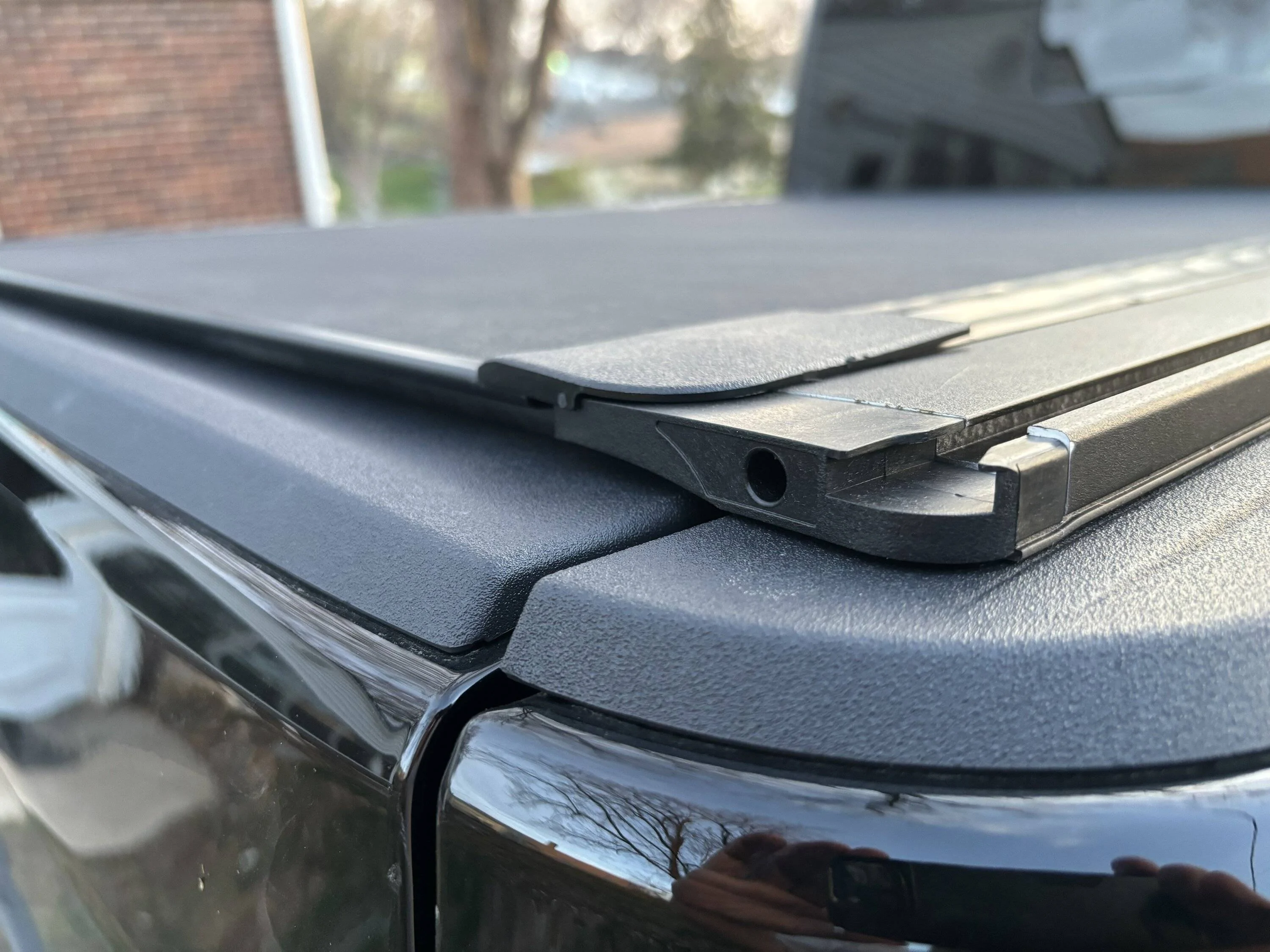

I installed them lined up, and there was a pretty big gap in back. I moved it forward and it just touches the tailgate.

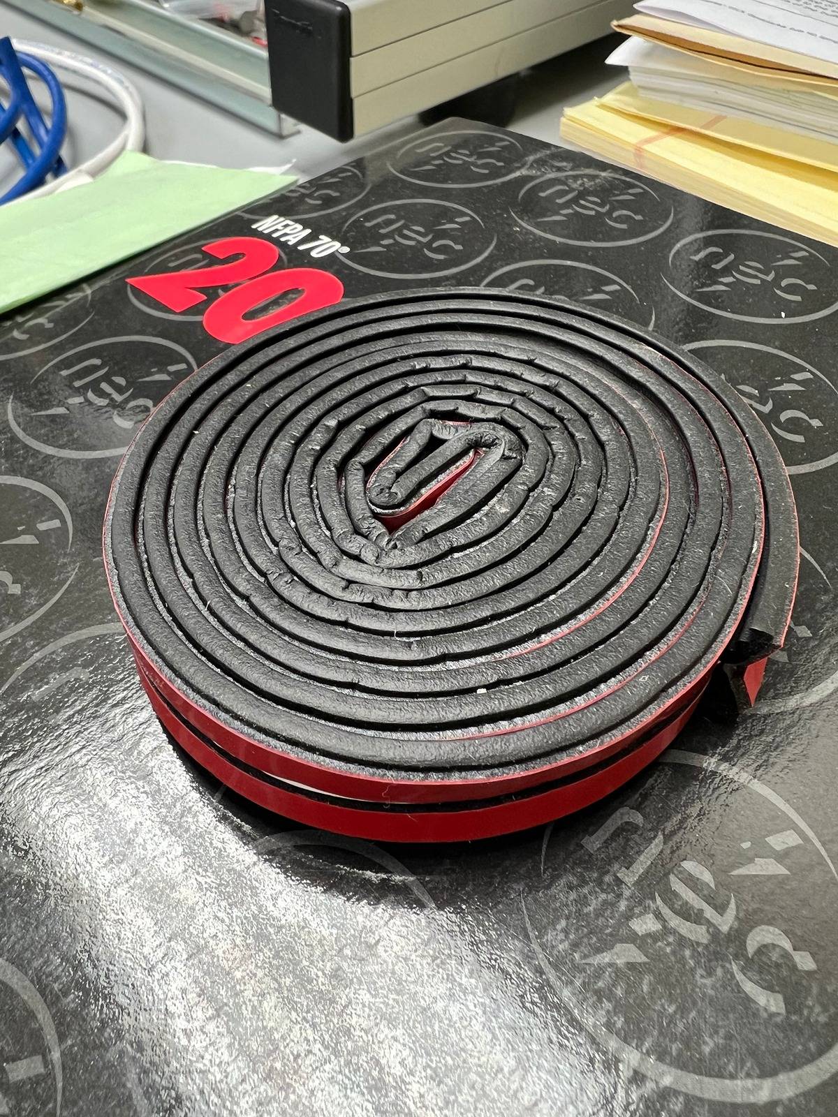

What's this weatherstrip for? I didn't see it in the instructions.
Jeep Gladiator Questions for BAK Revolver X4S owners IMG_4703
