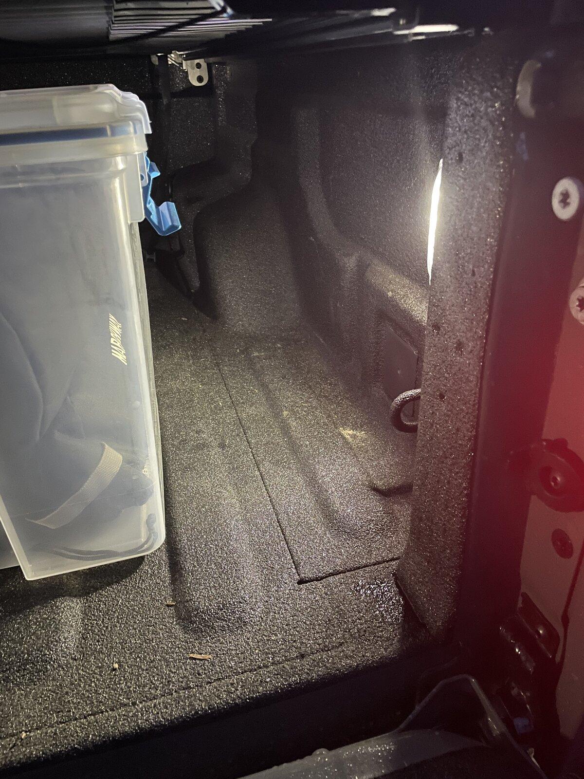

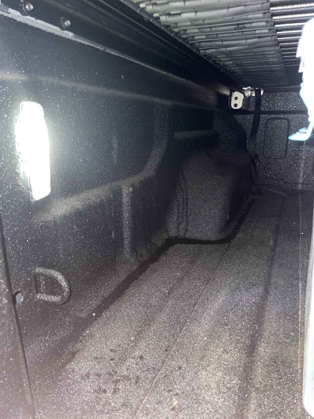

I saw something similar with my cover after I put it on and washed the truck. Thought that I had just sprayed at an odd angle with the hose and haven't had any rain yet to check if that really was the case. I too received extra gasket material but wasn't sure what to do with it since the instructions didn't say and it wasn't enough for both rails, so I didn't use it. Let us know if it fixes your issue though.
I took the bed cover off and applied the extra gasket material over the top of existing gasket material. The extra gasket in the box needs to be ripped in half lengthwise, which is easily done, and there was plenty. Re-installing the rails was a pain because the gaskets are now so thick. It went back on, but sits at an angle where the gasket is obviously too thick. Maybe it will settle in with time. Will report back after rain.
In hindsight, I should have ripped off the original thin gasket and installed the thicker one. The thin gasket from the factory clearly does not seal the side rails against the rough texture of the factory side rail plastic. Or, Bak could have just installed the thicker one to begin with.

How thick and wide gasket did you get? The 3rd set of rails should be here tomorrow or Wednesday, want to have everything ready for the weekend when I put it on, that is if the rails are straight. ??
I used the “extra” gasket material that was in the box. It ripped perfectly down the middle, so each piece was about 3/8” wide, 3/16” thick, and over 5’ long. The factory gasket under the side rails is about 1/16” thick, which wasn’t enough to keep mine dry.

We had another hard rain. The thicker gasket seemed to help some, but there is still some water getting in. Oh well. It’s “mostly” dry.? Keep your sensitive stuff in the middle of the bed, or keep it in dry boxes.

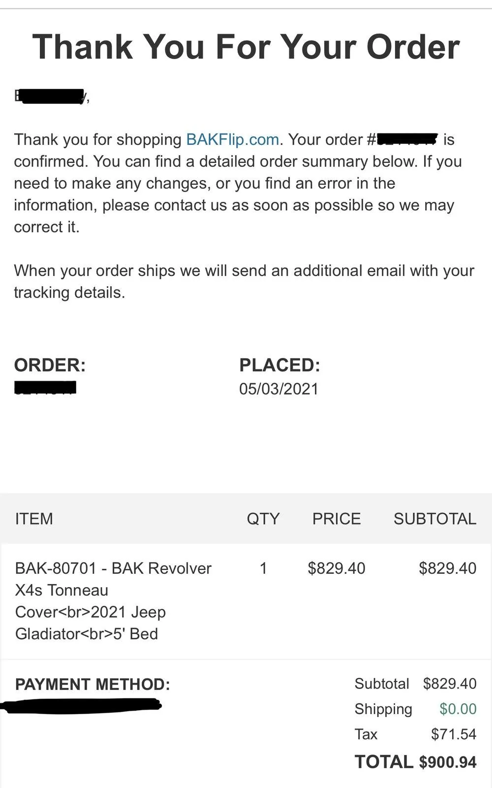

Figured I’d try my luck and ended up ordering one from backflip.com as well. I tried at bakindustries.com first and got denied. Then I went to backflip.com and called the number on the bottom, then spoke to a salesman named Alex. I mentioned the forum and he had to confirm with a manager first, but they matched the price of $829 + tax! Posting the email on the forum to help out anyone else too. Should be here in 5 days as well??
Thanks for all the info guys on this thread about getting a discount. I just got off the phone with Brandon who is super awesome from bakflip. I didn't realize that realtruck owns them. Well I was able to get the same price on the x4s as you guys. Looking forward to doing the install of the cover. :rock:
