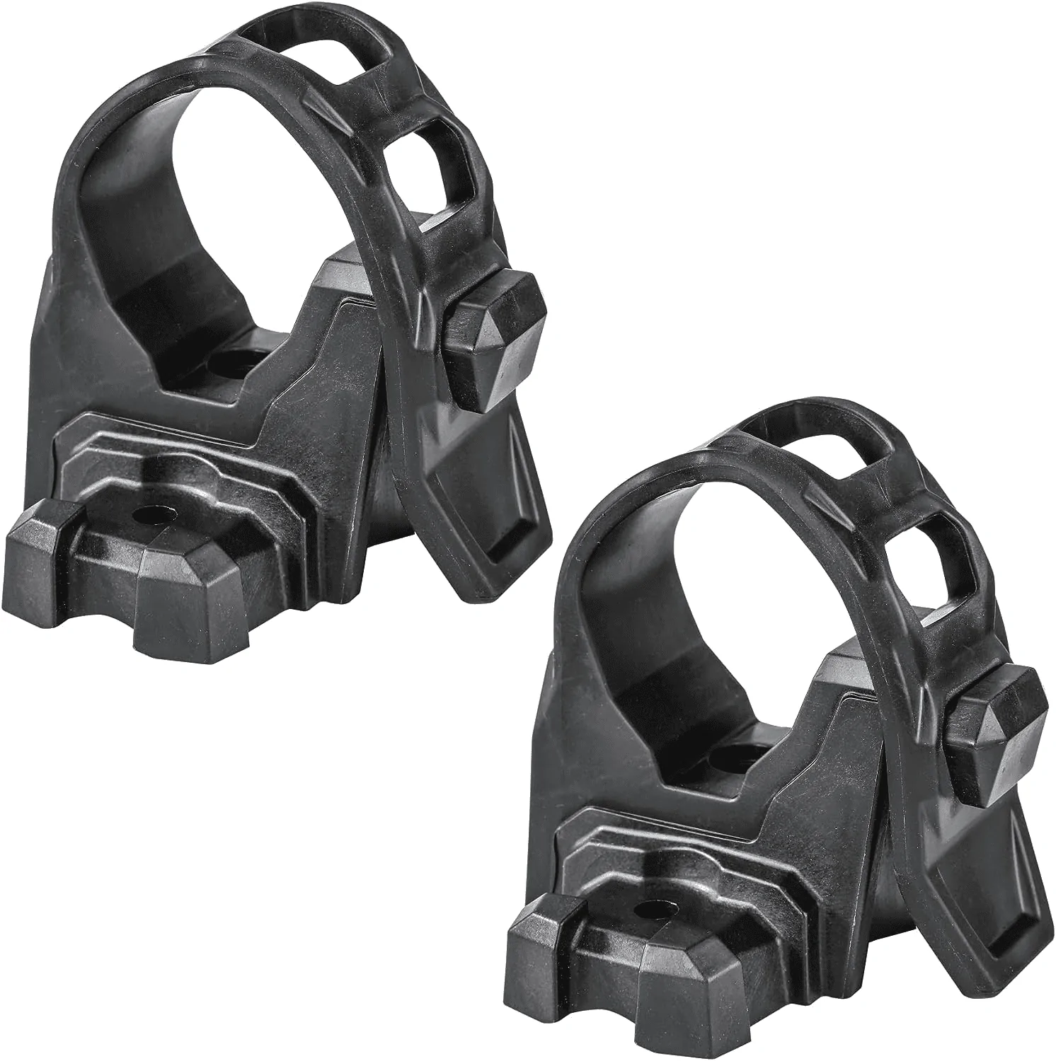

Hello,
How are people mounting their quick fist or similar type clamps to their Molle panels. Is there a good hardware kit, or are people just going to the hardware store? Of those options what you found that works the best?

Thanks! I was looking at those, however on the website it said they're only compatible with their Molle panels, and won't fit other ones. I have the rough country Molle panels.
You're right. It's been a while but I recall I having to shave the corners with a file and got them to work.

Hello,
Thanks in advance
The hole pattern of the RC panels makes it a bit more challenging to find compatible accessories to fit. Take a look at the Kolpin Rhino mounts. They have a two-bolt mounting pattern and if you are lucky they may match the drilled holes on the RC panels. A Quick Fist should also work since it can mount using one center screw. If you still have trouble getting anything to work message me. I can probably design a spacer to fit their hole pattern.
https://www.amazon.com/gp/product/B07GDG5X4G/ref=ppx_yo_dt_b_search_asin_title?ie=UTF8&th=1
Lol I just actually ordered this, I'll just go to the hardware store once I get them and see what fits. By the way, your Molle panels are really nice!
Deleted member 54903
It says they don't recommend using it with other panels. Of course, they don't. I can't see why they wouldn't work with others.

Every companies hole pattern is slightly different. I use PALS compliant spacing to try and be compatible with as much as possible. Others, especially the RC panels have offset spacing and holes which I believe is why they say they are not compatible. The large rectangles all differ in size and corner radius.
