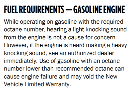

I believe someone mentioned this earlier in the thread about our manual addressing 'light knocking'. I found it on page 478 (480 if you have the PDF):
Jeep Gladiator Rattle from engine when accelerating (sounds like keys) 1621209336655
I'm interested to know what qualifies, and what light knocking over the lifetime (and I'm expecting double digit years here) will have in the long term for an engine with this high compression ratio.
Also, and I hope I don't get roasted for a potentially stupid question here: but I noticed on my last 2 oil change receipts, the dealer has put in 6 quarts of oil in- the manual specifies 5. Is having an extra quart of oil rolling around in there going to have any adverse affects- like rattling or pressure issues? I (naively) assumed they would know.
250
40,624
54,315
Remind your dealer - a good one will do it over and not charge you.
No, there's enough room in these that 1 quart doesn't appear to do damage. IF it did, there'd be hundreds of damaged engines.
The "rattle" is detonation. Fuel octane can actually vary a bit - I posted elsewhere here about how octane is actually "mapped" on gasoline so 2 87 octane fuels can behave differently in different engines at different RPMs.
Buy a top tier fuel - you can find your top tier stations by searching via google or bing.
Check with your dealership, too - the EGR system may be not working correctly, could be other factors in play. Occasional light pings - very occasional, not a huge issue, but longer term, and frequent, big troubles.
The compression ratio is a static measure. The engine can play with that number - the dynamic compression ratio, by changing valve timing and lift. If the cooling system is less than perfect, etc. you run into hot spots causing the ping.
Check with the dealer, try a top tier fuel.
