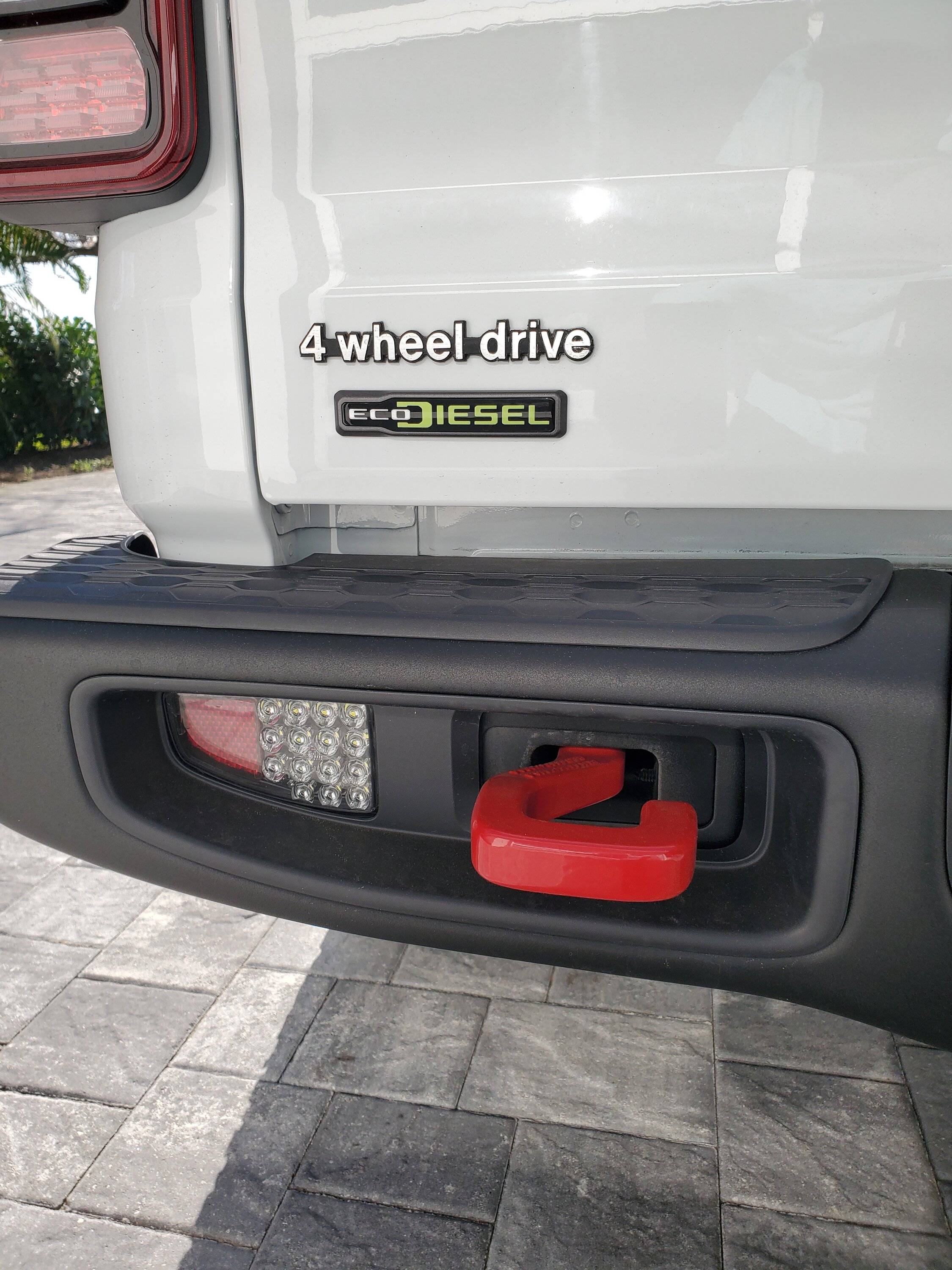

Correct, one harness - you can do either left or right tail light, I had it in the left on my first ones, and moved it to the right side for this one so I could run a wire and diode to operate them with an aux switch as well as being in reverse.
One "adapter harness", the two lights each have a pigtail, then a longer wire that runs across the back to reach which-ever tail light you choose.

That's why I did what I did - hooking up trailer, loading and strapping my car onto trailer, etc.
I had to modify the tail light connector/adapter, and used a diode setup.

The white wire comes from aux switch to one of the diode inputs.
Jeep Gladiator RAVE REVIEWS ON OUR REAR BUMPER LED REVERSE LIGHTS FOR JEEP GLADIATOR JT 20220728_152905
The output goes to the bumper mounted lights.
One input is from the aux switch, the other input is from the tail light harness adapter.

For the reverse LED lights in the reflector, do I need a wiring adapter for both sides (your site just says packages 1 for $38) or is the reverse light wire long enough to reach the opposite side?
Only one is needed! Connect the adapter between the factory tail light plug and the factory tail light using the supplied locking connectors. No cutting or splicing required.
Unless you do as I did to also run them via one of the aux switches. Piece of cake though - I modded your harness, the Jeep wiring is unharmed/unmodified.
