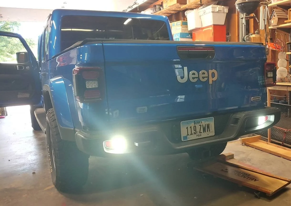

They are bright - this picture was taken at about 10 am, full sunshine coming in that east window, the lights near the car were on, and my JT was parked in front of the car about 10 feet or so.
Jeep Gladiator RAVE REVIEWS ON OUR REAR BUMPER LED REVERSE LIGHTS FOR JEEP GLADIATOR JT 20220728_153350
Jeep Gladiator RAVE REVIEWS ON OUR REAR BUMPER LED REVERSE LIGHTS FOR JEEP GLADIATOR JT 20220728_153407_HDR
