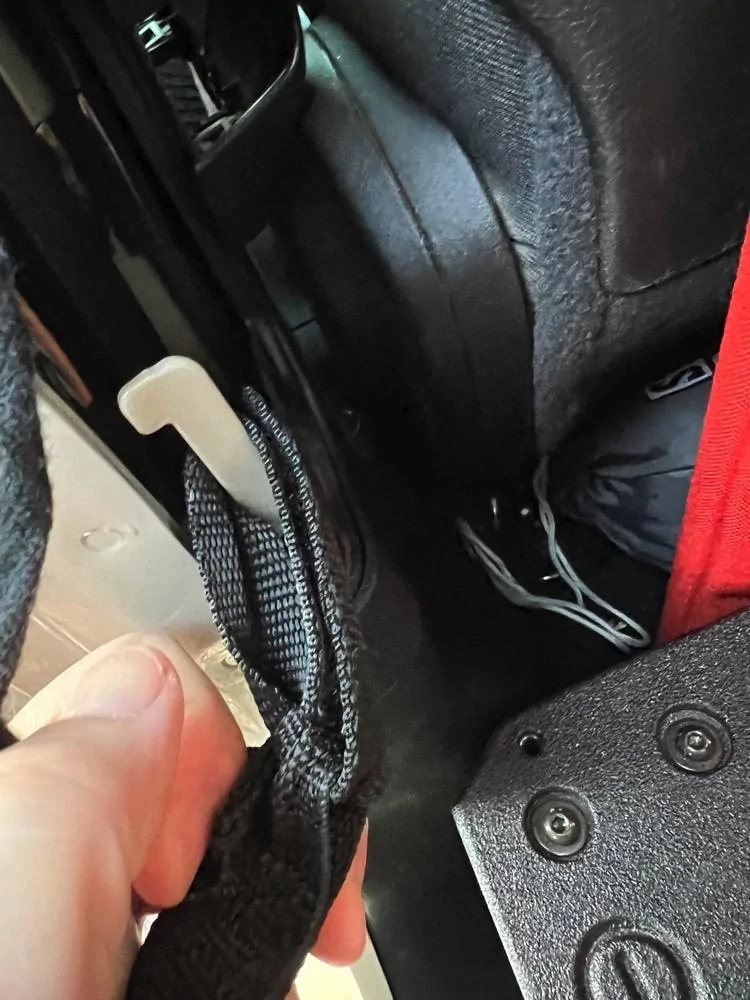

I had the same need but it was for being able to move a Yeti cooler in/out easier. Here is what I did and its a fairly elegant solution:
1. Remove the strap loop from the metal retainer

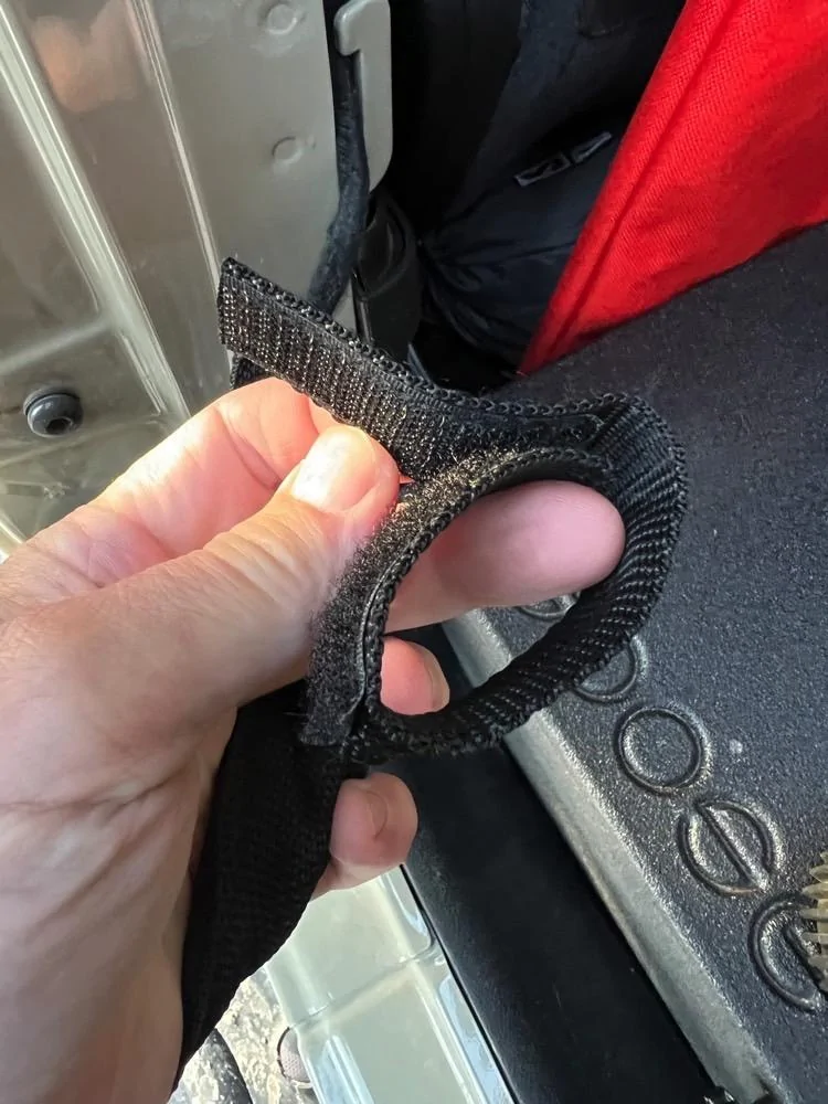

2. Get/fab a small strap. I had the one in the picture laying around from something or other; but you could use paracord, nylon webbing, etc.

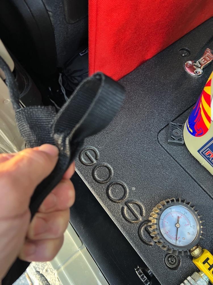

3. Feed the new strap through the loop that was previously on the metal retainer, thus extending the length of the original strap:

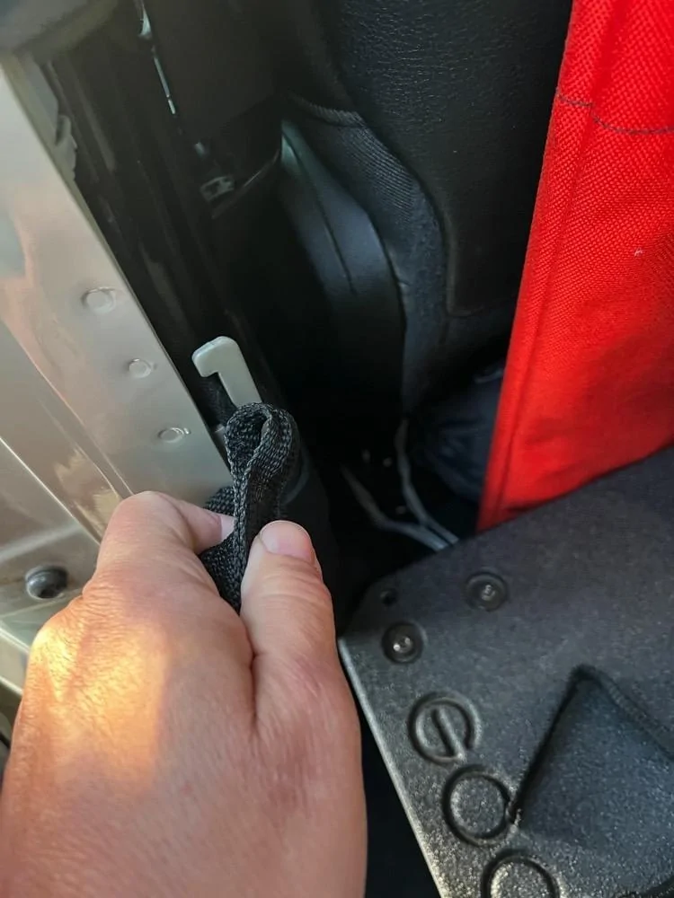

4. Hook the new loop over the metal retainer:
Jeep Gladiator Rear door opening limit extensions 34_DoorStra

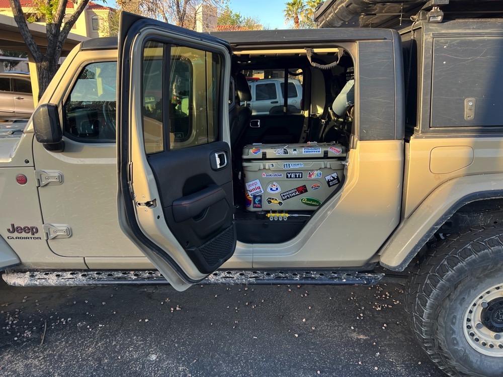

5. Now with the longer strap the door swings further open and the electronics are still connected (the electronics cable is quite a bit longer than my new strap so no real issue with binding it).
Jeep Gladiator Rear door opening limit extensions 35_DoorStra
Obviously, the longer you make that strap, the farther open the door will swing. I made mine long enough that I can still open the driver's door without banging into the rear door when fully extended.
Cheers!
