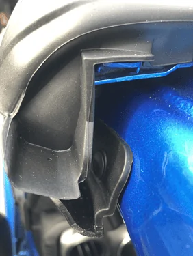

I've seen several threads, both here and over on the JL site, about members being deluged when they open the driver's door in the rain. I haven't had this happen. When I had the top off the other day, I looked closely at the area in question...
Jeep Gladiator Getting a Shower When Opening the Door 141809-6d621b7f9250d198900334aa4fb02441
Jeep Gladiator Getting a Shower When Opening the Door 141811-306e5c9b54d469f3a9bf28b7d53c220
Jeep Gladiator Getting a Shower When Opening the Door 141812-c7fd1331ec07911e30f8a6f24f87a9bc
As you can see (first picture,) the upper part of the rubber is designed to take runoff from the door drip rail and direct it into the lower rubber gutter.

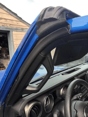

The second picture shows a small rubber pipe that's there to take runoff from the Freedom Panel area and direct it into the lower rubber gutter, as well.

I get a shower on my 2020 Rubicon. Not sure I care enough to do something about it, but shower on rainy days for sure

Valuable lesson learned 2 days ago. Was pouring here in Ohio, stopped for breakfast and upon re-entering my JTR, a torrent of water drenched my left leg, drivers door electronics, and drivers mat. Heard about it but never experienced it till then. Next stop was the paint store, looked for an uphill spot, parked nose higher than rear, dry as a bone when I got back after shopping. Now I know what those concrete parking bumps are for! If it’s raining, pull front tires on top of them, problem solved.
