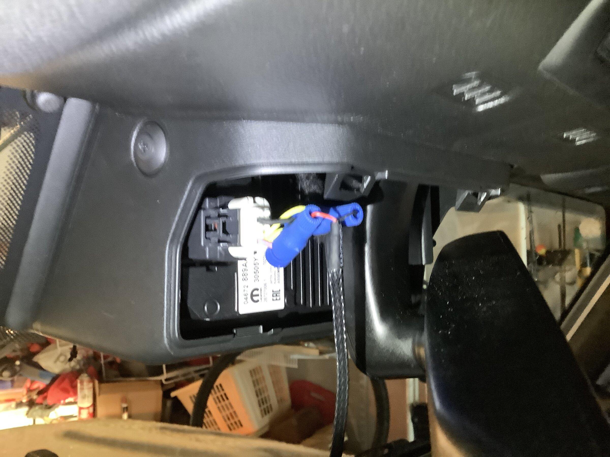

Hereā€™s a shot of my wiring.
Jeep Gladiator Rear View Mirror Wiring Diagram on the JT to connect a radar detector. 27C3C065-26F6-496B-960A-21FC62EAD692

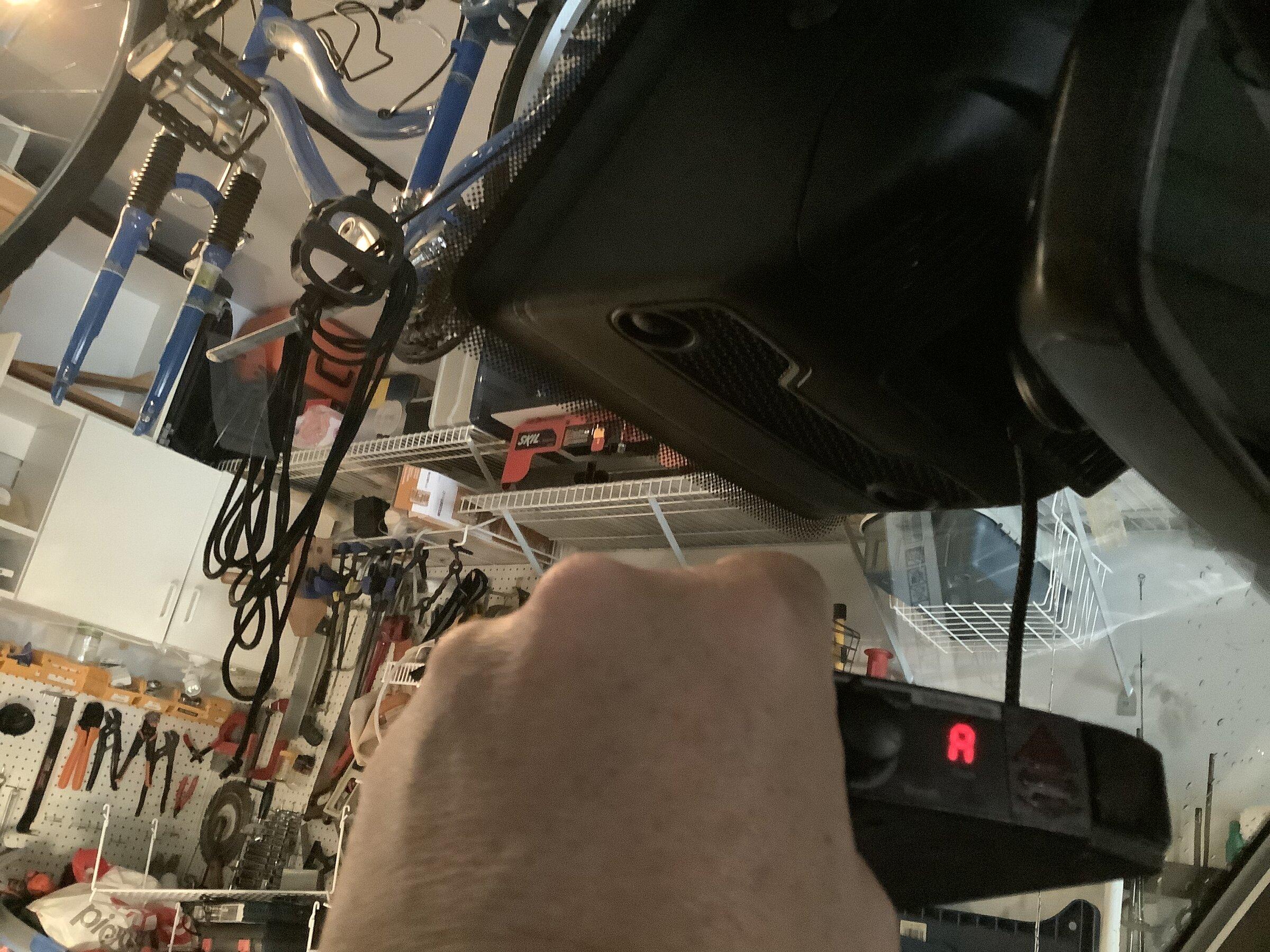

All buttoned up.
Jeep Gladiator Rear View Mirror Wiring Diagram on the JT to connect a radar detector. 191614E6-C4DA-4B99-B633-E6BB1F30054A
A big thank you to @RSK and @WhatExit? for all the previous leg work!
-Mike
