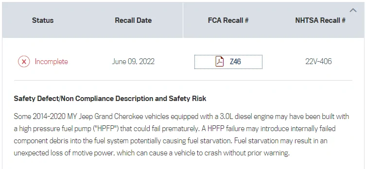

For y'all
Interesting, I picked up my ordered diesel JT June of 2022 but my safety recall sheet says 01A not Z96? Are there different versions?
